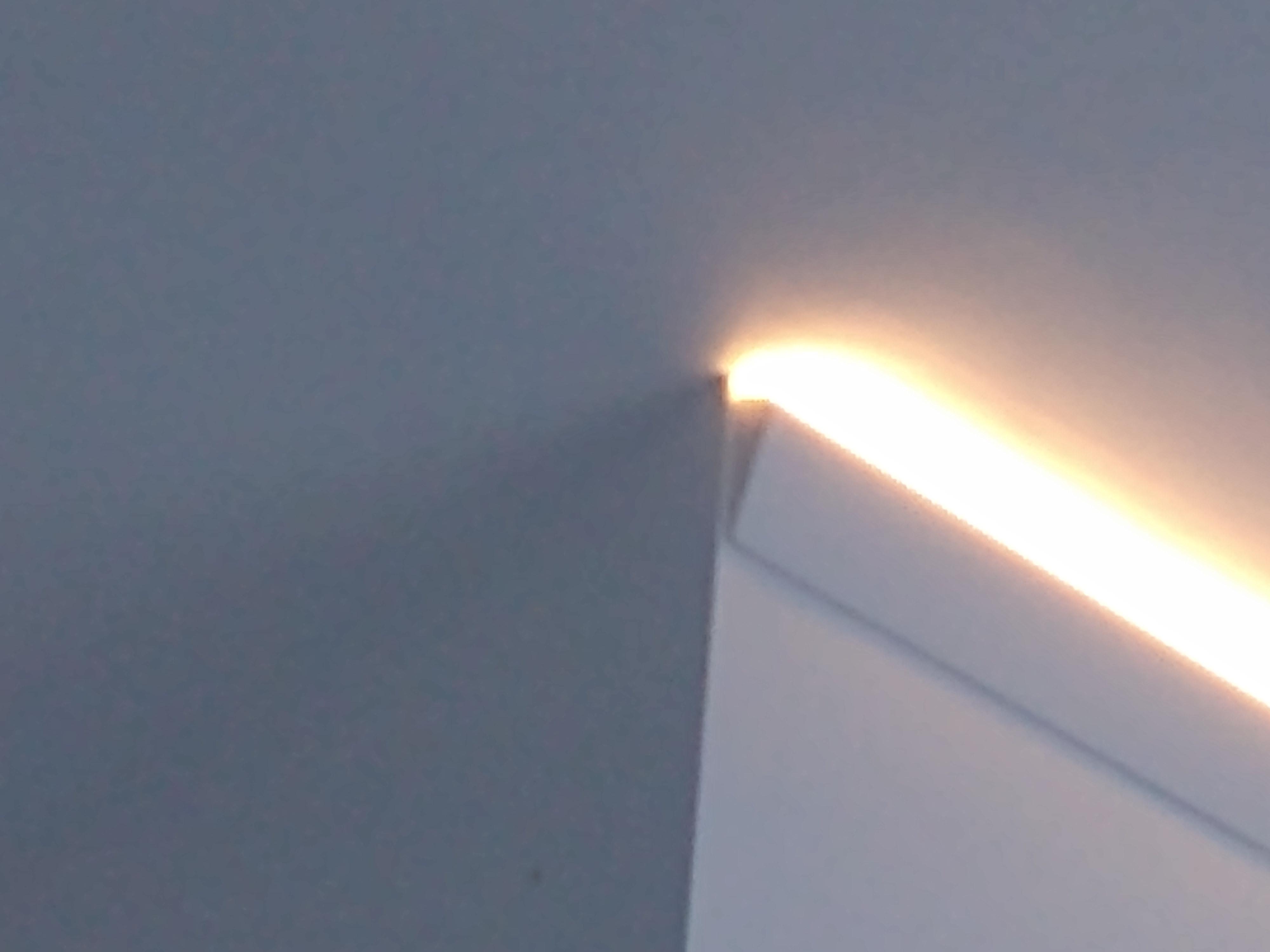

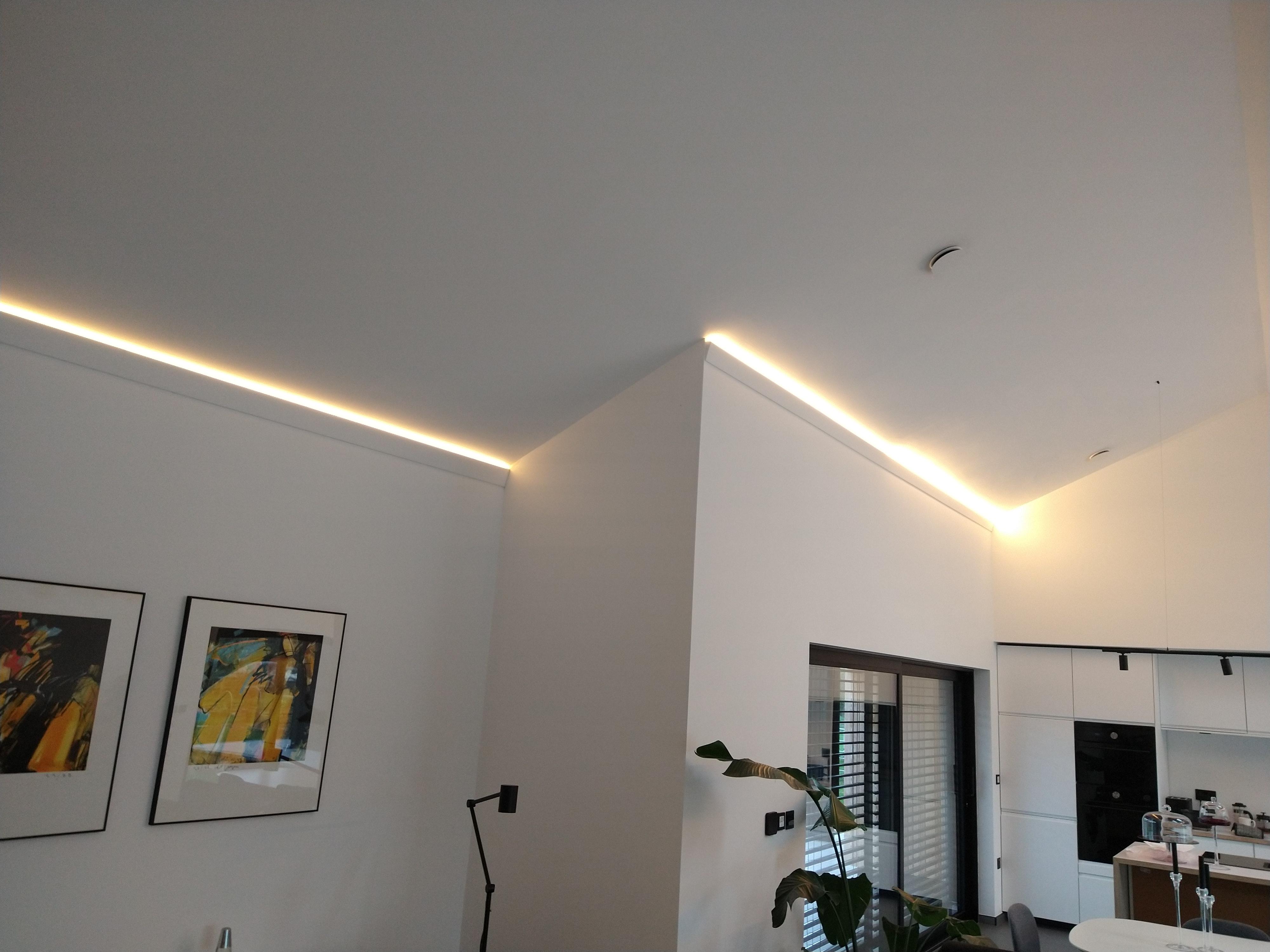

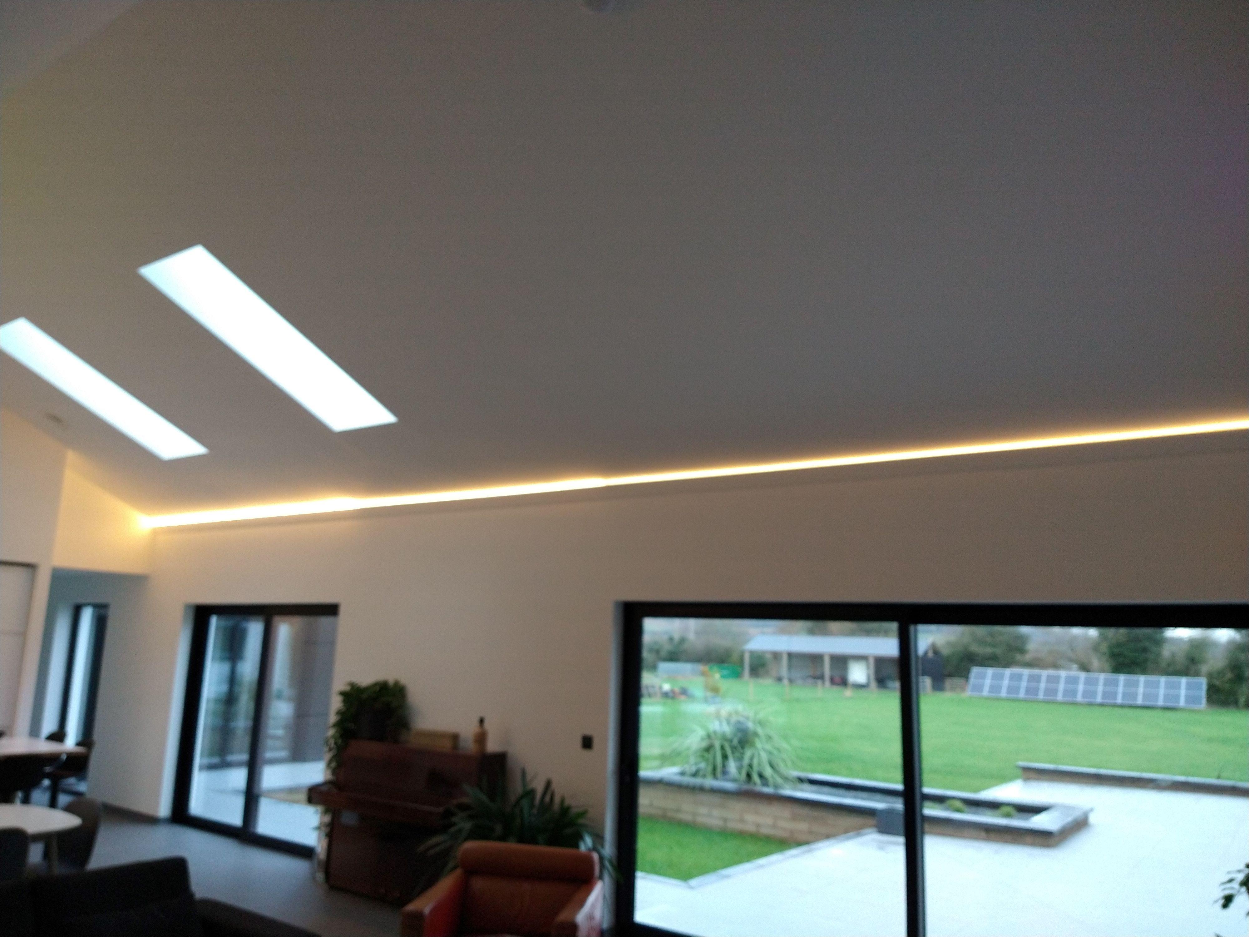

Hi, below a few photos - in the big kitchen, dining living space, we split this into 3 areas, each on/off and dimmable seperately. In the evening we'll only use the living space leds. You can see this on one of the photos, where I've set different levels on each of the sections.
On one of the photos, you can see the end of the coving - the sparkies specced this and supplied it - it was incredibly lightweight. To put it up, they lasered a line in and tapped some pins in every 50cm or so and then simply 'no nailed' it to the wall.  The end of the coving you can see has had the slot at the back disguised - essentially there's a step down from the edge and the led trough and diffusers sit in there.
We used the ARC Led controllers -> https://arc-led.co.uk/controller/1689-arc-led-universal-12-24v-4-channel-receiver-with-push-dim-input.html They now do a wifi version but we're happy enough using a remote - you can can program 3 scenes on the remote -> https://arc-led.co.uk/controller/917-arc-led-single-colour-4-zone-remote-control-black.html.  We also put in an RF wall controller but never use it - similar to this one -> https://arc-led.co.uk/controller/1278-arc-led-4-zone-single-colour-battery-operated-touch-wall-panel-black.html.
Actual drivers and led strips were all specced and supplied by the sparkie. The leds are simple warm white - no fancy colours.....
Here's some photos - let me know if you want any more info - I can probably get the spec for the covings if you need that.  Also, in the bedrooms with vaulted ceilings, we did the same but also have 3 spots on the long side of the vaulting (they're uneven, i.e. come down further on one side). Again I can send photos of this if you are interested - we used BG wall touch dimmers for these.
The 3rd image is a bit blurred, had to reduce it's size to be able to attach all 3.

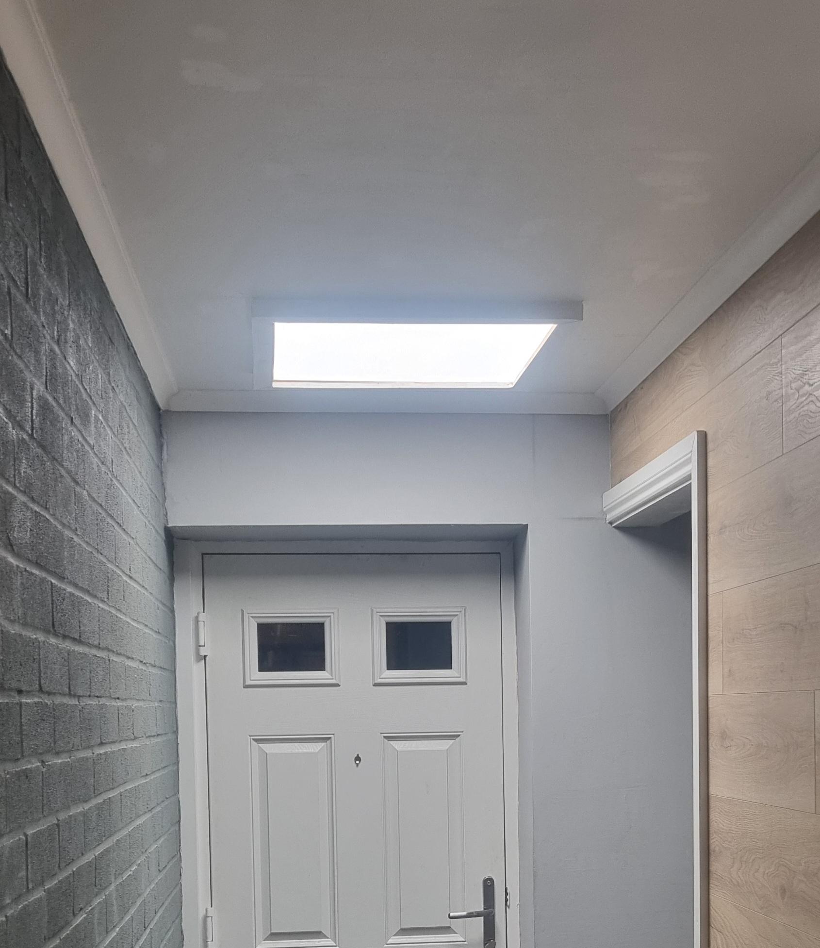

You can be very creative with office led lighting if needed..
Simple trim around the edge can make it look like a faux skylight. Most people assume it is one!
Without the risk of leaking.
  • Thanks 1

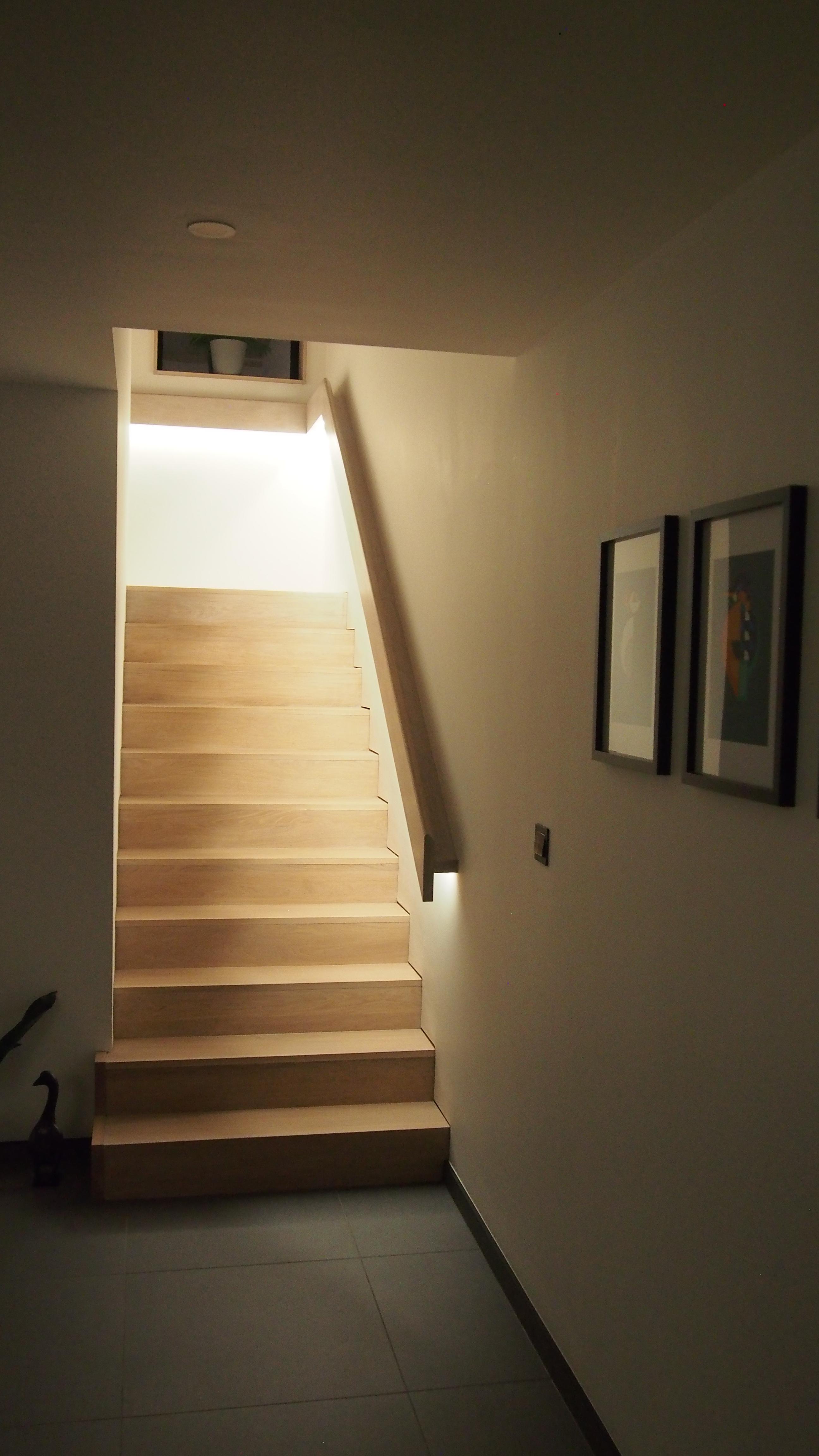

Agree - we also have some under the banister on the stairs - very effective..

I’ve also wired for stair lights but yet to decide how to do it exactly. I like what you’ve done but our staircase and hand rail doesn’t lend itself to achieve that very easily.

We have some pet hates - one of them is hand rails and spindles - which freed us up to do the lighting - or rather allowed our architect (our son) to come up with the great solution in the photo.
Link to comment
Share on other sites
Your son is very talented. This looks great and functions so well. The light is only where you need it; looks so nice and warm.

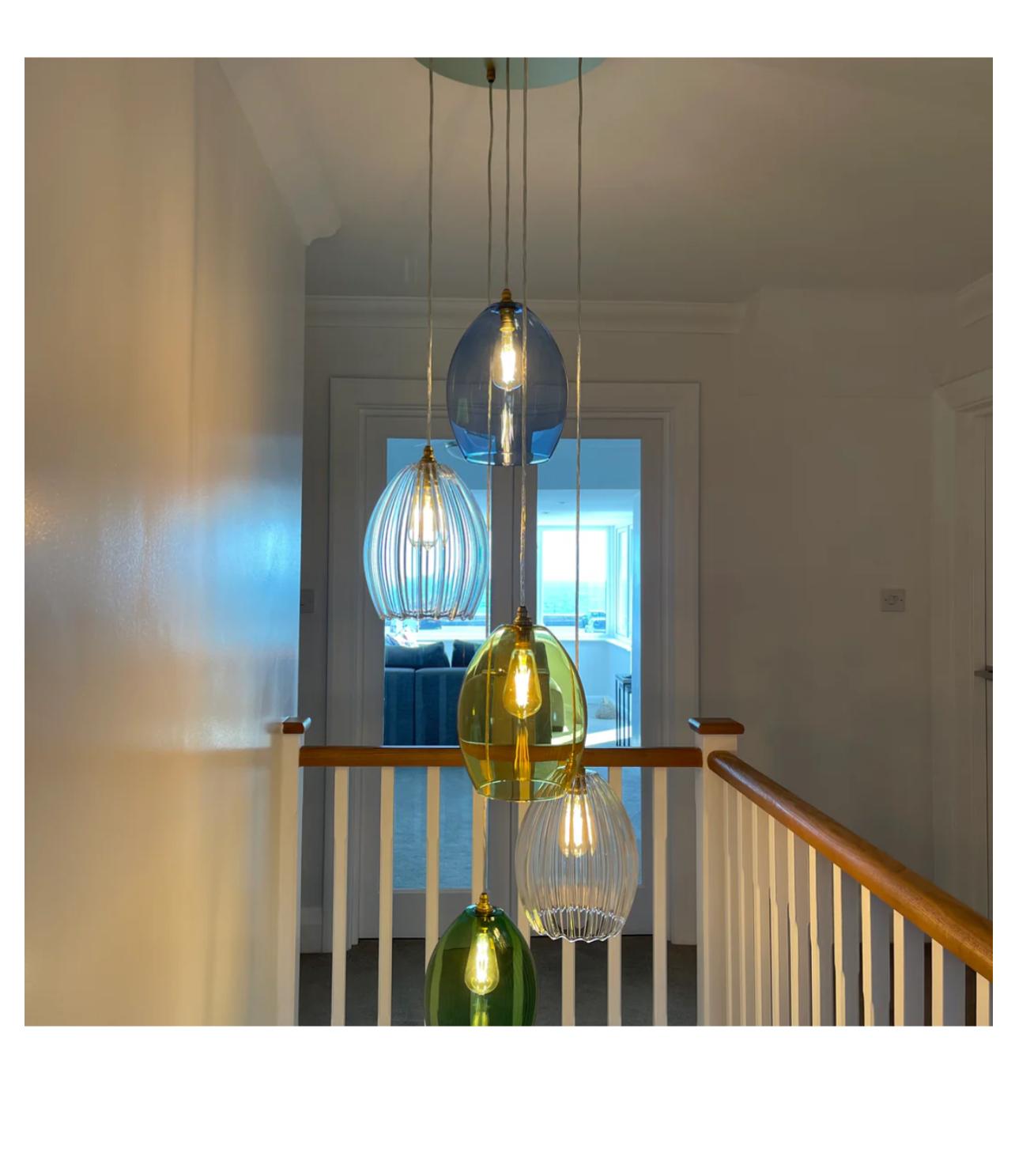

It’s literally just plastered today so not yet. However the main ceiling light will look similar to this but with 7 lights. From here:
https://www.glowlighting.co.uk/pages/gallery
We will also have two double spot lights that are tucked in the corners plus some table lights and a large standard lamp.
