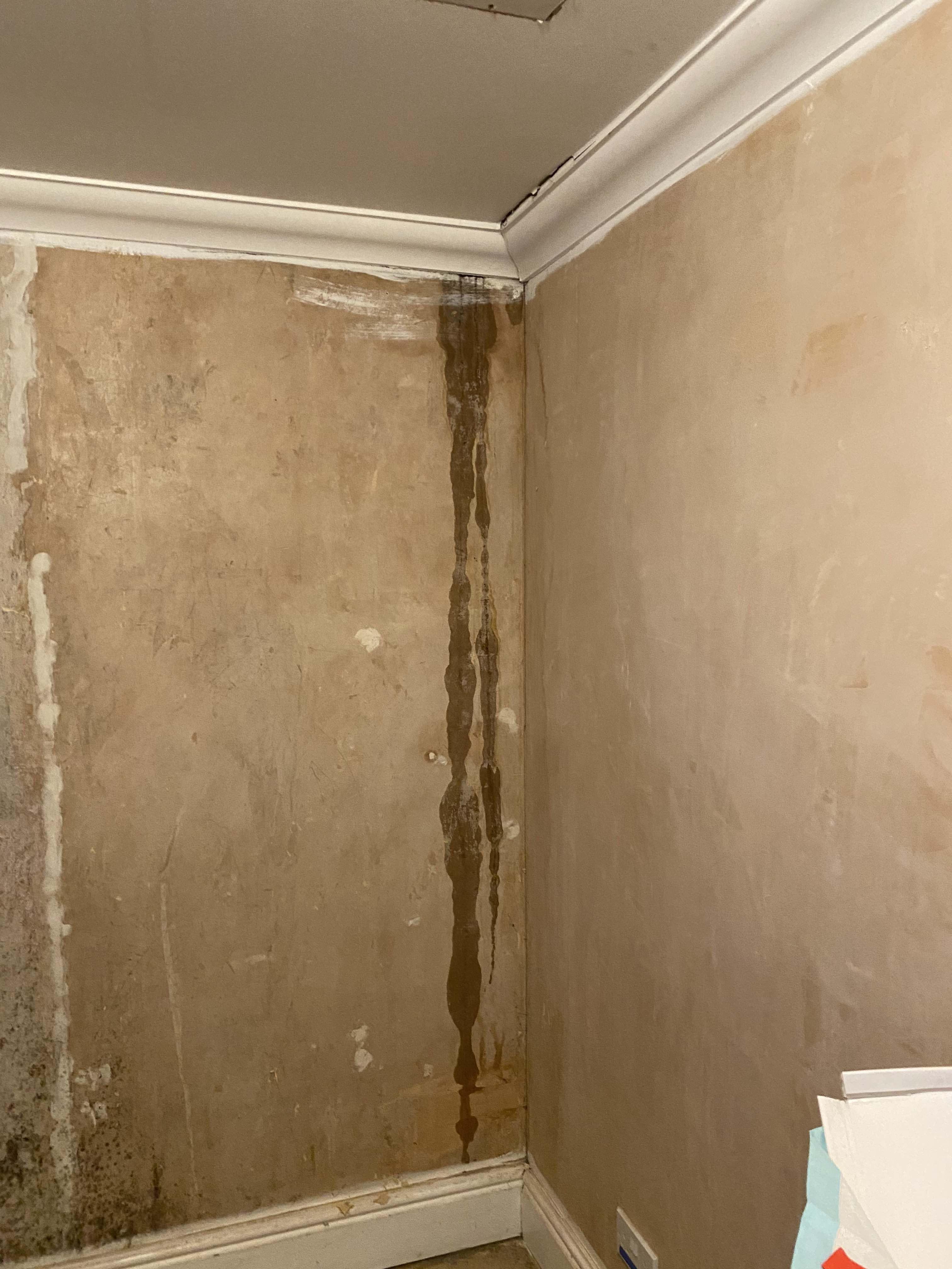

jayc89 Posted September 19, 2023 Share Posted September 19, 2023 We have an old, 2 pot, stack on a gable end. The breast was removed all the way up to the loft level many years ago and it has been left, unsupported, ever since (as far as I know). It's now leaking like a sieve, leaving a pool of water in our wardrobe area whenever it rains... We had a builder round to price up removing it and making right the roof, they have about a 6 week lead time so I think we need to do something faster. They were talking about putting lintels into the roof space, but I don't know why. Could they be meaning just removing the stack down to roof level and leaving the rest of the stack in place in the loft but supported? Farmer next door has offered us his telehandler and "cage", could I DIY it this weekend? Link to comment Share on other sites More sharing options...
markc Posted September 19, 2023 Share Posted September 19, 2023 If they mentioned lintels then they are looking at removing the top bit of stack and replacing the roof over but leaving the remainder in the loft. removing chimney breasts, especially on a gable end can cause a lot of problems because a chimney adds a lot of stiffness and bracing into a gable wall. 1 Link to comment Share on other sites More sharing options...
jayc89 Posted September 19, 2023 Author Share Posted September 19, 2023 34 minutes ago, markc said: If they mentioned lintels then they are looking at removing the top bit of stack and replacing the roof over but leaving the remainder in the loft. removing chimney breasts, especially on a gable end can cause a lot of problems because a chimney adds a lot of stiffness and bracing into a gable wall. Makes sense, so remove some bricks to get a lintel under the rest of the stack, resting on both external walls I presume (approx 4m span), then only remove the bricks above the roof line? Link to comment Share on other sites More sharing options...
markc Posted September 19, 2023 Share Posted September 19, 2023 6 minutes ago, jayc89 said: Makes sense, so remove some bricks to get a lintel under the rest of the stack, resting on both external walls I presume (approx 4m span), then only remove the bricks above the roof line? If you can get across to the walls then yes, but often done by spreading the load across several ceiling joist (too often done with only a thin board if anything). A well supported stack remaining acts like a strong-back for the gable. Then remove the bricks going through roof line and finish to suit existing 1 1 Link to comment Share on other sites More sharing options...
jayc89 Posted September 19, 2023 Author Share Posted September 19, 2023 Decided I'm going to go up and try keep the stack; remove the pots, replace the launching and repoint it, which should hopefully stop the water ingress. And I'll get a builder in to fit a lintel. The thought of it coming crashing down into the ensuite when someone's taking a dip isn't worth considering... Link to comment Share on other sites More sharing options...

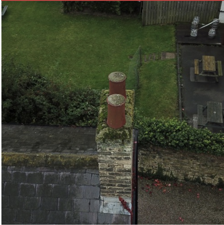

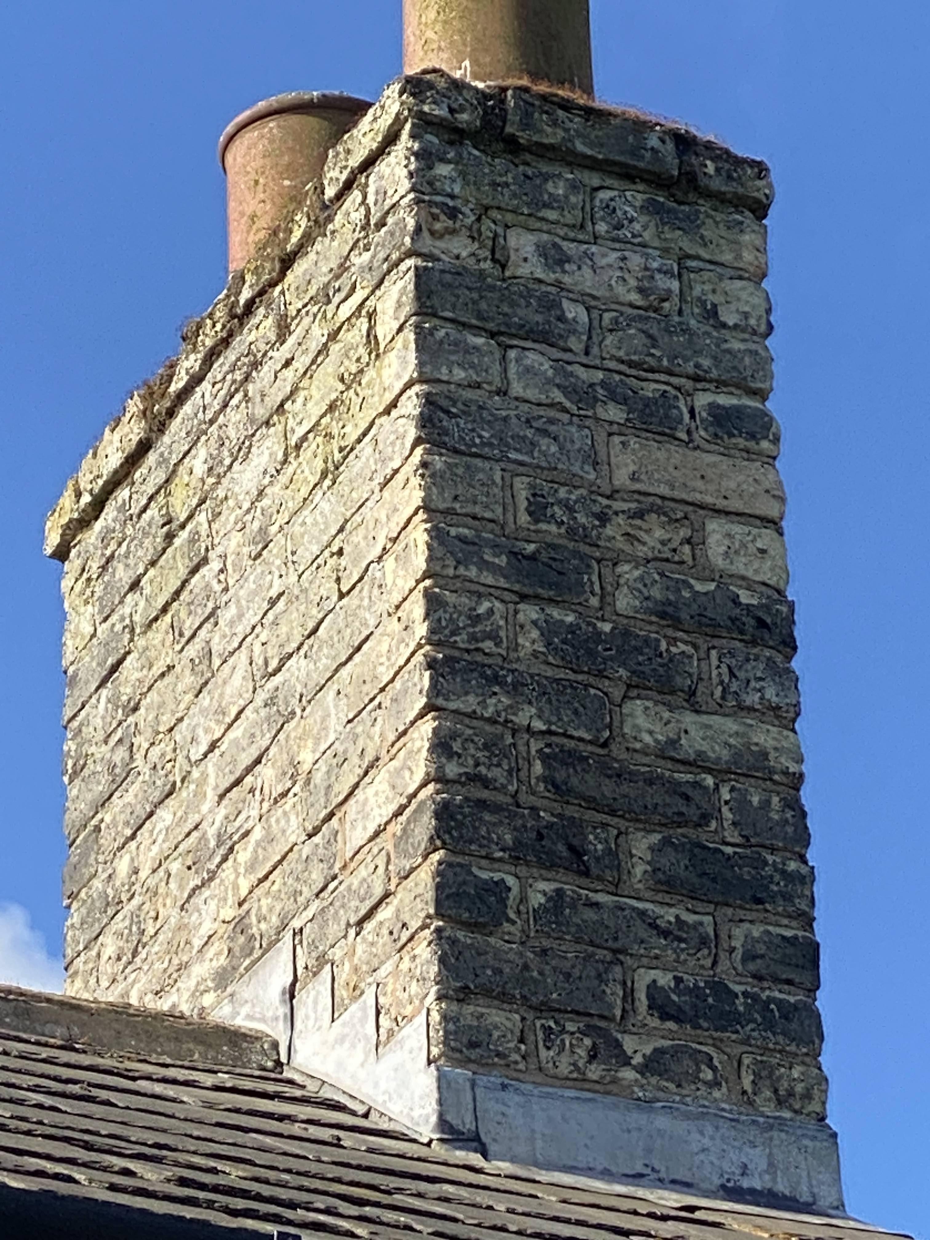

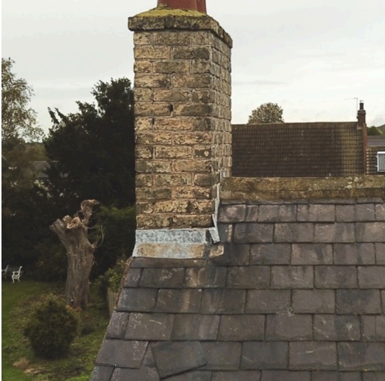

Russell griffiths Posted September 19, 2023 Share Posted September 19, 2023 Pictures needed inside and out. Link to comment Share on other sites More sharing options...
jayc89 Posted September 19, 2023 Author Share Posted September 19, 2023 35 minutes ago, Russell griffiths said: Pictures needed inside and out. Lead flashing and slipped slates have been fixed since the pic was taken. Link to comment Share on other sites More sharing options...

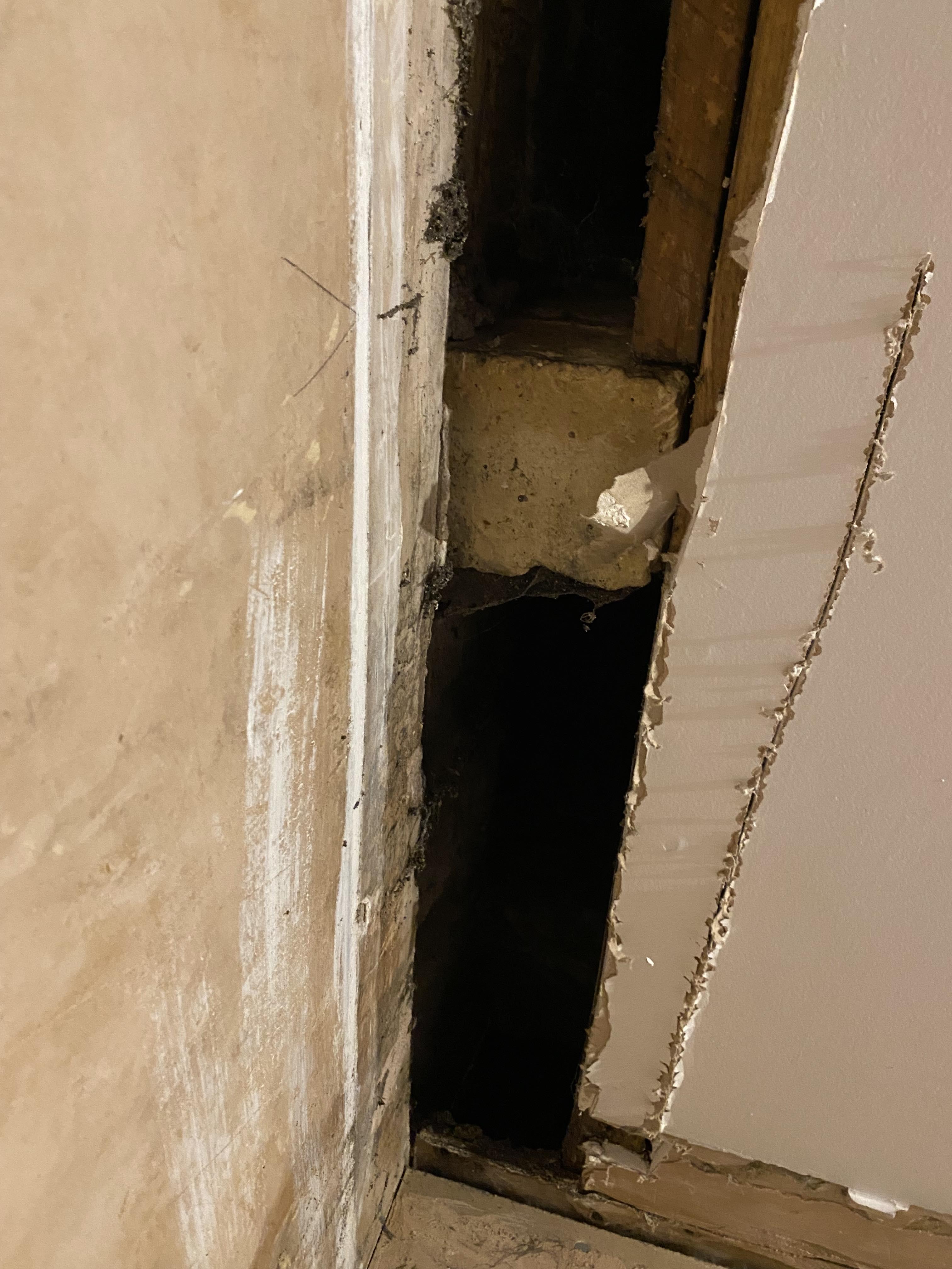

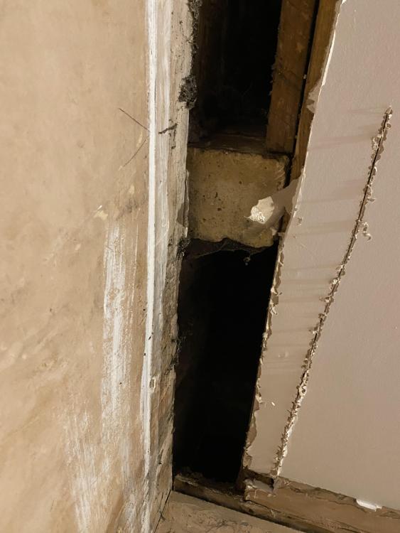

jayc89 Posted September 19, 2023 Author Share Posted September 19, 2023 Bit of a naff photo, but shows the left hand side of the stack unsupported in the loft. It's a two pot stack, left side is bone dry, right side is sopping wet internally, so I'm assuming it's the flaunching or pointing letting water in, probably the former given how much water's getting in. Link to comment Share on other sites More sharing options...
markc Posted September 19, 2023 Share Posted September 19, 2023 That’s a big heavy stack, what is supporting it at the moment? Link to comment Share on other sites More sharing options...
Mr Punter Posted September 19, 2023 Share Posted September 19, 2023 Take it down and roof over it. Link to comment Share on other sites More sharing options...

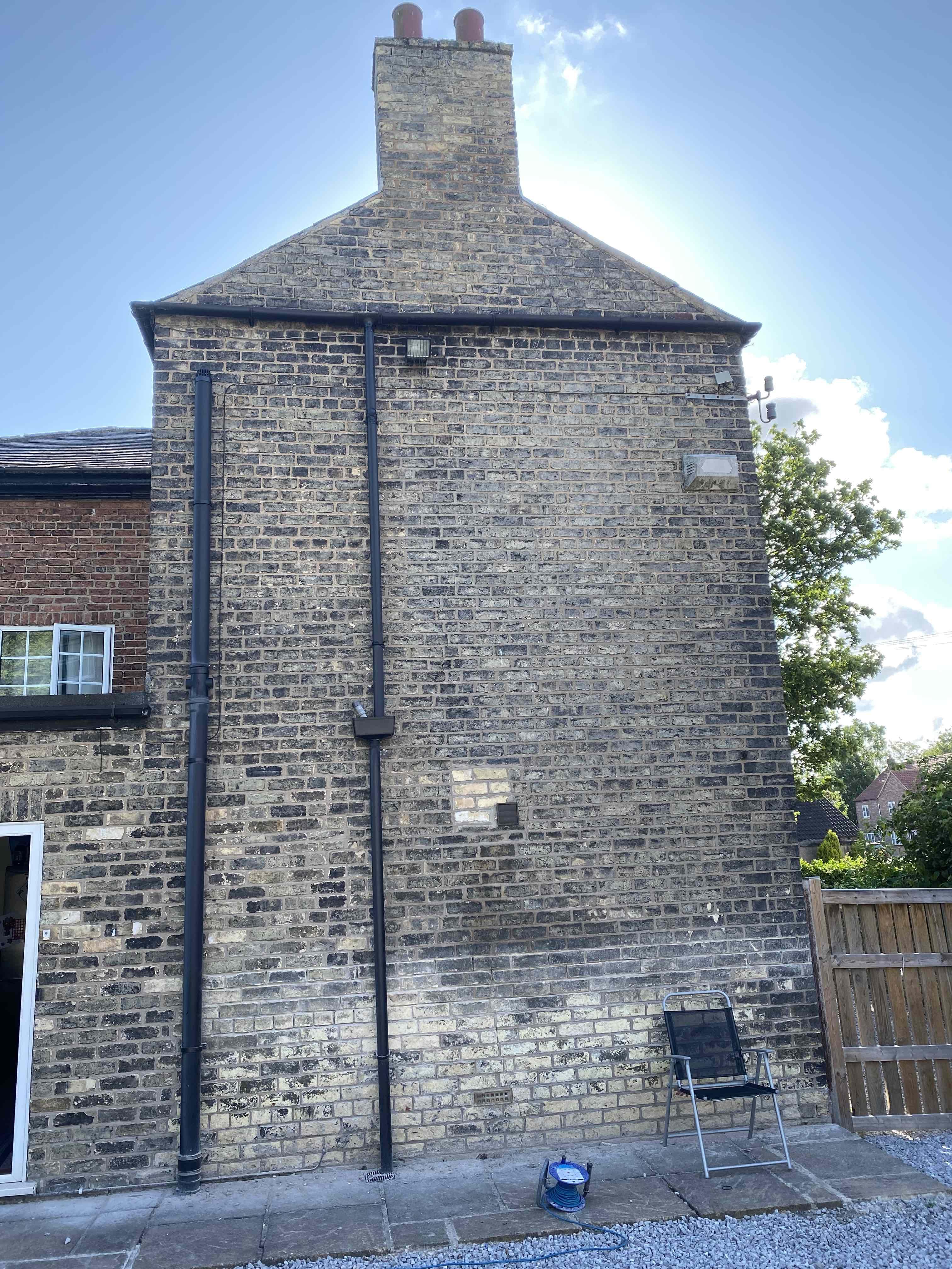

jayc89 Posted September 19, 2023 Author Share Posted September 19, 2023 (edited) 21 minutes ago, markc said: That’s a big heavy stack, what is supporting it at the moment? Not much at all. Possibly a 3x2 ceiling joist that you can just see in the last picture. 19 minutes ago, Mr Punter said: Take it down and roof over it. That was our initial idea, but it would make the gable end look pretty bare and we lose more character from the house. The builder we spoke with suggested we'd need a lintel in the loft space anyway, so we're now thinking - why not patch up the leak, leave the stack, and put that lintel in anyway? Edited September 19, 2023 by jayc89 Link to comment Share on other sites More sharing options...
Mr Punter Posted September 19, 2023 Share Posted September 19, 2023 6 minutes ago, jayc89 said: would make the gable end look pretty bare and we lose more character from the house. No photo of the gable end so we were not fully briefed! I take your point though. Chimneys, fireplaces and chimney breasts are often focal and are an attractive part of the character, especially of period houses. They are also impractical and largely redundant. Link to comment Share on other sites More sharing options...
jayc89 Posted September 19, 2023 Author Share Posted September 19, 2023 3 minutes ago, Mr Punter said: No photo of the gable end so we were not fully briefed! I take your point though. Chimneys, fireplaces and chimney breasts are often focal and are an attractive part of the character, especially of period houses. They are also impractical and largely redundant. Oh, I meant to attach this one too, not sure what happened! Link to comment Share on other sites More sharing options...
ProDave Posted September 19, 2023 Share Posted September 19, 2023 What we need is a picture from inside the loft space showing the stack coming down the wall and a close up of how it finishes at the bottom in the loft. Link to comment Share on other sites More sharing options...
jayc89 Posted September 23, 2023 Author Share Posted September 23, 2023 Managed to get my hands on a tele handler and cage today. The pot above the leak was loose, it just lifted off in my hands and the entire top course of bricks were also loose. All taken down and rebuilt; lime mortar for the brickwork, cement + sika proof mix for the flaunching and refitting the pots. Fingers crossed that stops the leak. Builder coming out to fit a steel beam in the loft to prop the stack up in a couple of weeks. 1 Link to comment Share on other sites More sharing options...
jayc89 Posted September 24, 2023 Author Share Posted September 24, 2023 Poured it down overnight. Wardrobe area's looking bone dry this morning. Happy days. Bit of pointing left to finish today, just to tidy it up, hoping the rain holds off for a couple of hours so I can get back up there before I need to give the tele handler back this afternoon. 1 Link to comment Share on other sites More sharing options...
