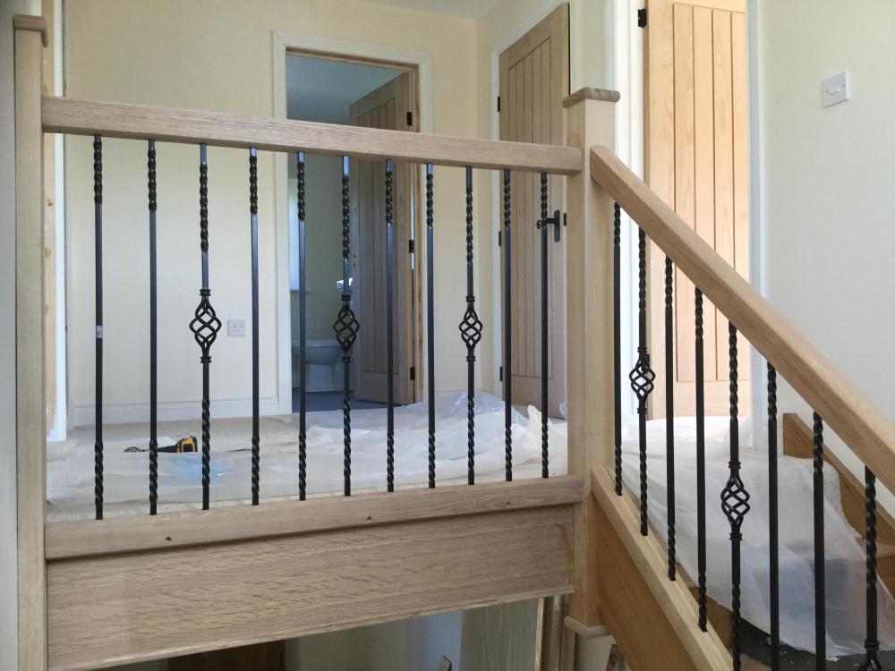

joe90 Posted September 16, 2023 Posted September 16, 2023 (edited) 11 minutes ago, MortarThePoint said: I want to do the whole thing myself and have the satisfaction, but the newel to stringer m&t joint is intimidating. Well I initially felt the same as I love woodwork and had some machinery, but, with all the other work on the build I was involved with i got the satisfaction of assembling the “kit” and ended up with a lovely looking oak staircase without the hassle and longer time frame. Edited September 16, 2023 by joe90 4
Dave Jones Posted September 16, 2023 Posted September 16, 2023 im a fan of the cast iron spindles as well.
joe90 Posted September 16, 2023 Posted September 16, 2023 (edited) 2 minutes ago, Dave Jones said: im a fan of the cast iron spindles as well. Yes I found them on EBay from a company in Yorkshire. Edited September 16, 2023 by joe90 3

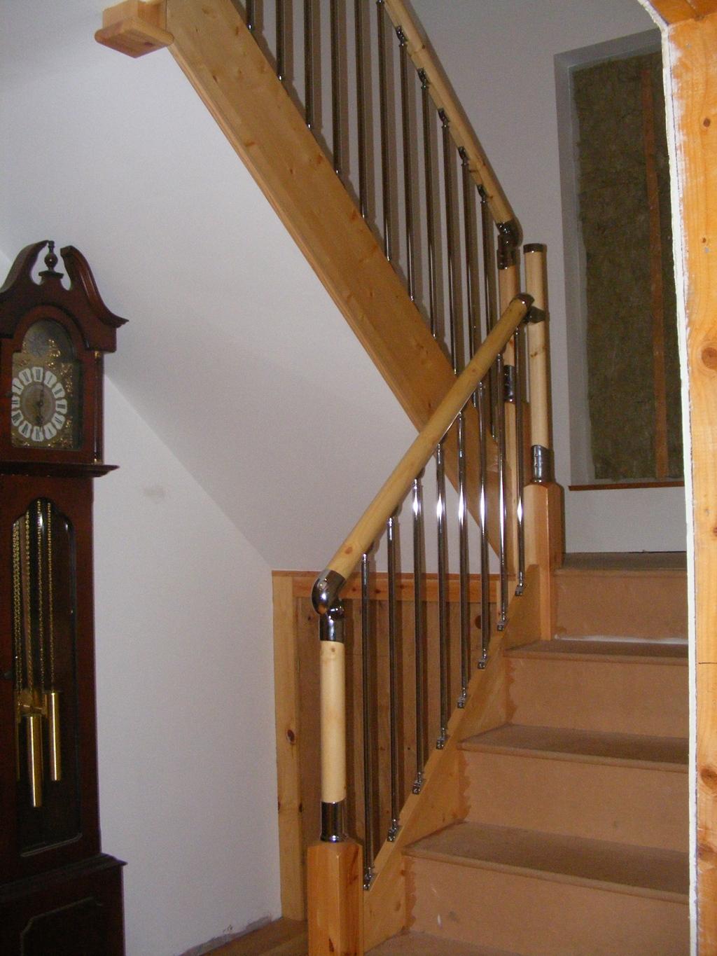

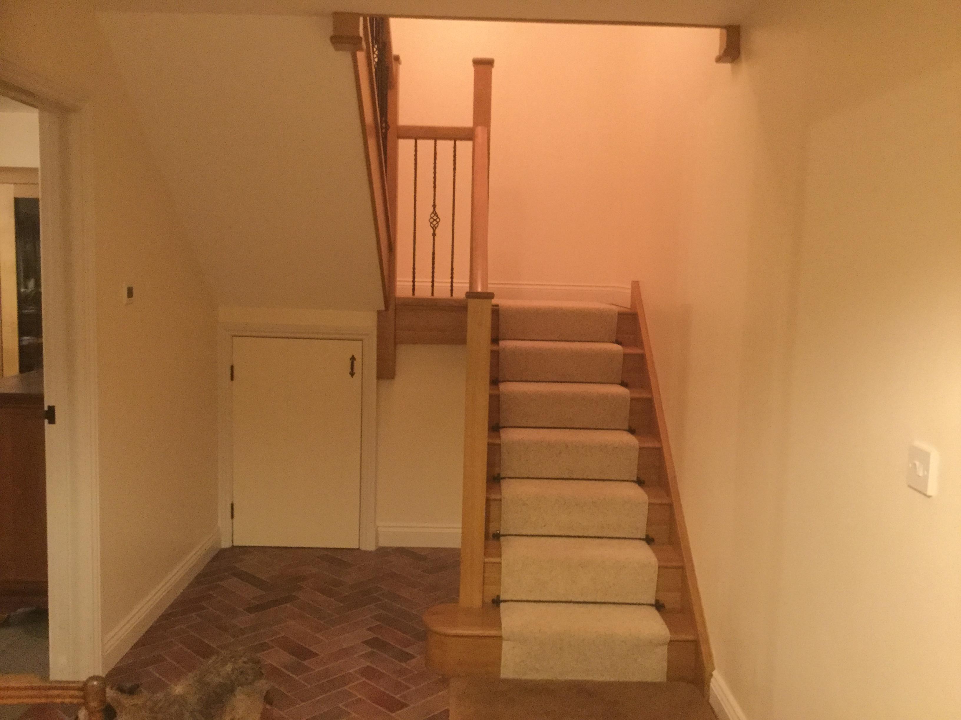

ProDave Posted September 16, 2023 Posted September 16, 2023 Our set of Stairbox stairs, but using the Fusion handrails and spindles from Burdidge. 1

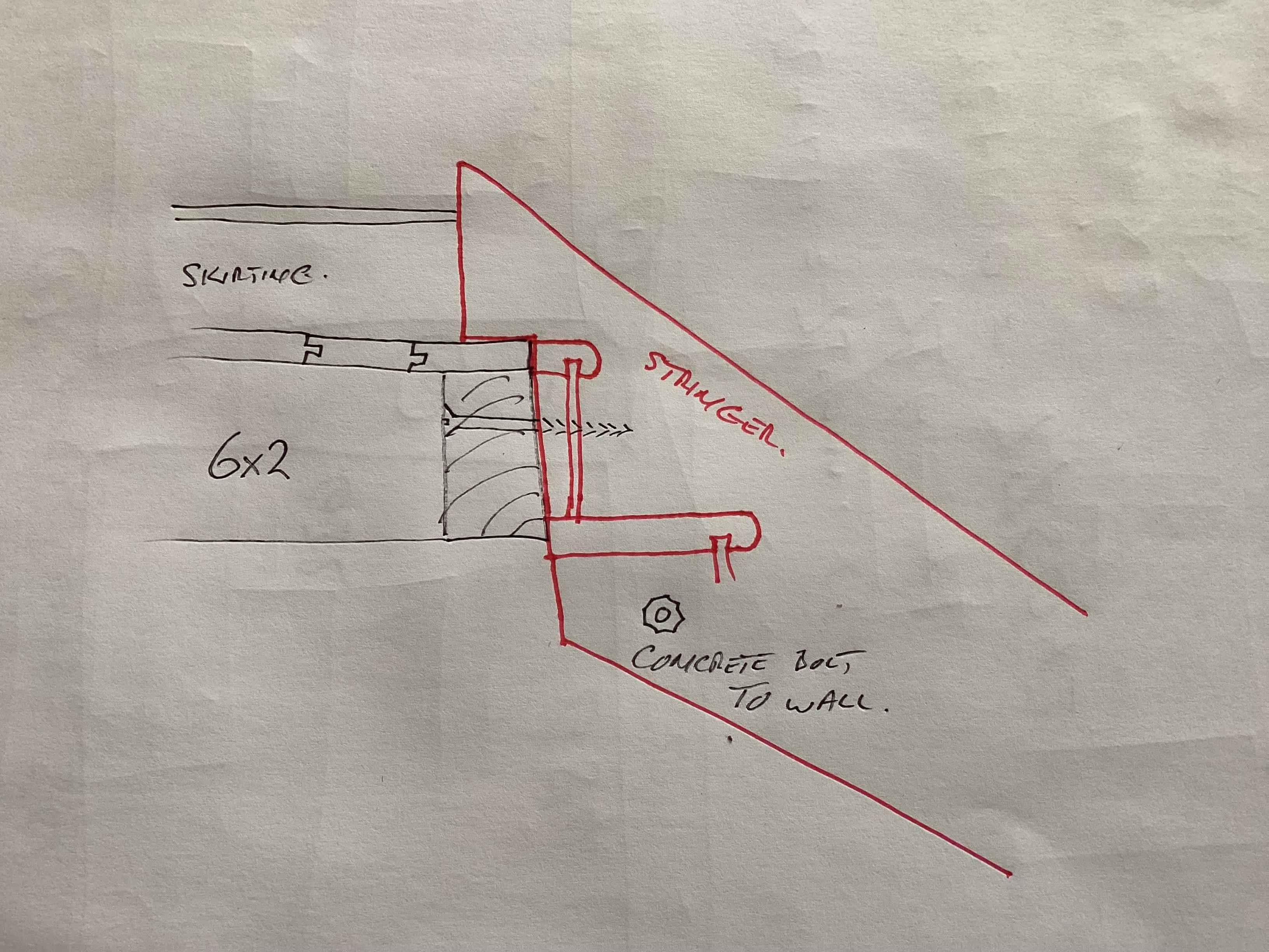

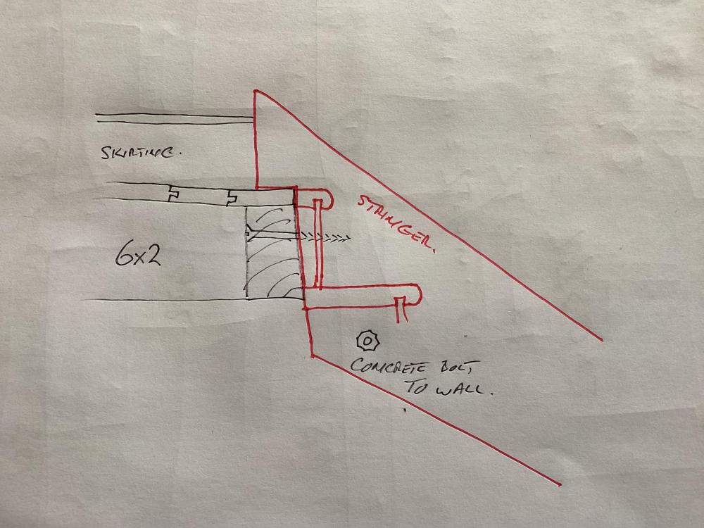

MortarThePoint Posted September 16, 2023 Author Posted September 16, 2023 3 hours ago, joe90 said: Well I initially felt the same as I love woodwork and had some machinery, but, with all the other work on the build I was involved with i got the satisfaction of assembling the “kit” and ended up with a lovely looking oak staircase without the hassle and longer time frame. I'm interested in how the right hand stringer is mated to the skirting board at the top. Do you have a close up of that?
joe90 Posted September 16, 2023 Posted September 16, 2023 1 hour ago, MortarThePoint said: I'm interested in how the right hand stringer is mated to the skirting board at the top. Do you have a close up of that? Unfortunately not and don’t live there anymore. I built the half landing myself, got stair box to supply matching oak for the floor, normal skirting on the half landing. Hope that helps.
MortarThePoint Posted September 16, 2023 Author Posted September 16, 2023 6 hours ago, joe90 said: Unfortunately not and don’t live there anymore. I built the half landing myself, got stair box to supply matching oak for the floor, normal skirting on the half landing. Hope that helps. How did the it attach to the half landing?
joe90 Posted September 16, 2023 Posted September 16, 2023 Like most stairs the stringers rest on the next landing then I secured with metal brackets, cad drawing available (crayon assisted drawing 🤣) 1 1
MortarThePoint Posted September 16, 2023 Author Posted September 16, 2023 22 minutes ago, joe90 said: Like most stairs the stringers rest on the next landing then I secured with metal brackets, cad drawing available (crayon assisted drawing 🤣) What type of metal bracket? A CAD drawing would really help if you are able to.
joe90 Posted September 16, 2023 Posted September 16, 2023 27 minutes ago, MortarThePoint said: A CAD drawing would really help if you are able to. I will get my crayons out in the morning. 1
joe90 Posted September 17, 2023 Posted September 17, 2023 Morning all, it’s Sunday so a slow start. Now, it was over 4 years ago so my memory might not be spot on, however to the best of my (failing) memory this is how I did it. On the drawing below what’s in red is what was supplied by stair box and that in black what I did. Basically I made the half landing of 6x2 concrete bolted to three walls and hung across the front, stair box supplied enough t+g matching oak flooring that I laid on these joists. The stair leans on the landing by both stringers and the stub nose top step aligns with the oak flooring i laid. I concrete bolted the stringer to the wall one side and I screwed through the 6x2 into the stringers. The skirting, matching that throughout the house was laid up to the edge of the stringer. I hope this makes sense 🤷♂️
MortarThePoint Posted September 17, 2023 Author Posted September 17, 2023 2 hours ago, joe90 said: Morning all, it’s Sunday so a slow start. Now, it was over 4 years ago so my memory might not be spot on, however to the best of my (failing) memory this is how I did it. On the drawing below what’s in red is what was supplied by stair box and that in black what I did. Basically I made the half landing of 6x2 concrete bolted to three walls and hung across the front, stair box supplied enough t+g matching oak flooring that I laid on these joists. The stair leans on the landing by both stringers and the stub nose top step aligns with the oak flooring i laid. I concrete bolted the stringer to the wall one side and I screwed through the 6x2 into the stringers. The skirting, matching that throughout the house was laid up to the edge of the stringer. I hope this makes sense 🤷♂️ The picture hasn't uploaded for some reason
MortarThePoint Posted September 17, 2023 Author Posted September 17, 2023 (edited) 57 minutes ago, MortarThePoint said: and I screwed through the 6x2 into the stringers. The 6x2 of the landing against the wall was presumably in line with the stringer, so did you toenail it through the landing's front 6x2? Edited September 17, 2023 by MortarThePoint
joe90 Posted September 17, 2023 Posted September 17, 2023 (edited) 2 hours ago, MortarThePoint said: did you toenail it through the landing's front 6x2? Yes, the wall bolt was doing the majority of the work, it was Inline with the other stringer as no wall plate in the way. Edited September 17, 2023 by joe90
