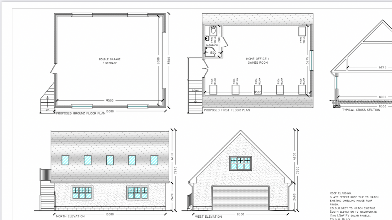

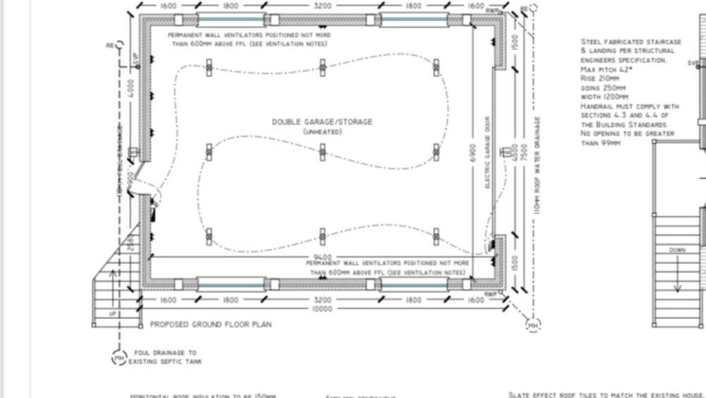

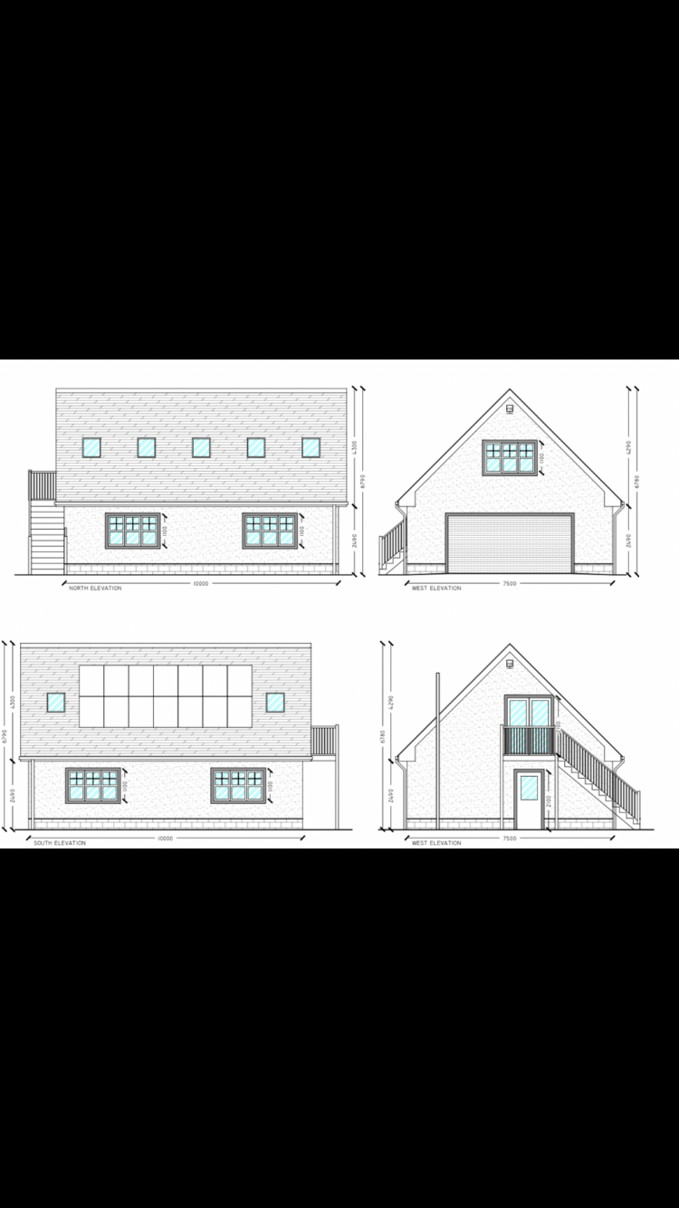

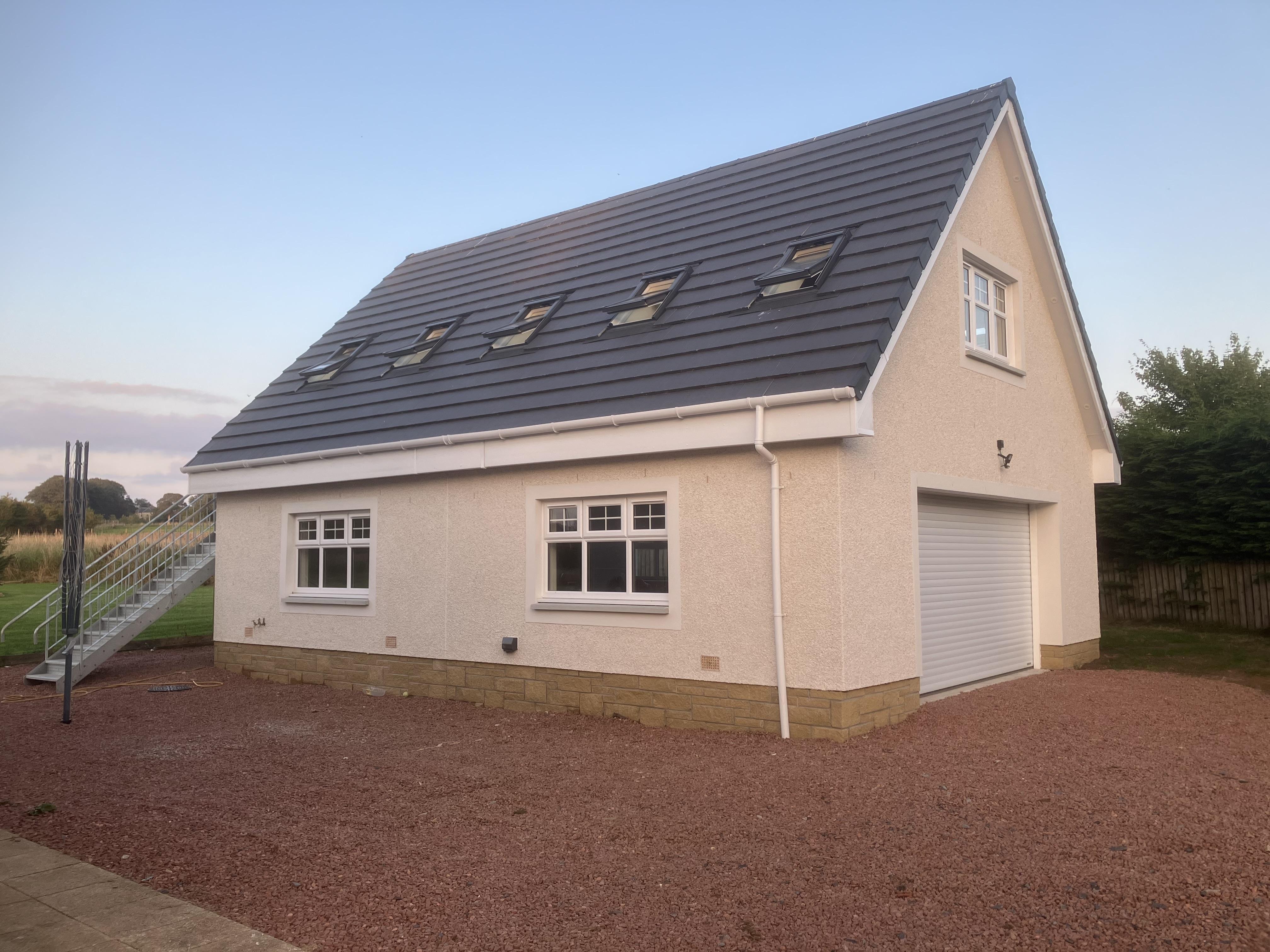

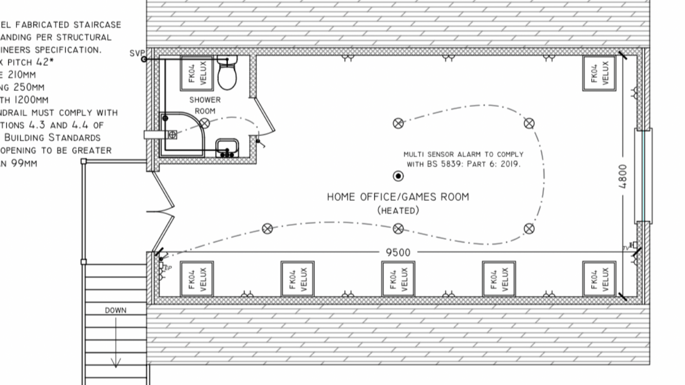

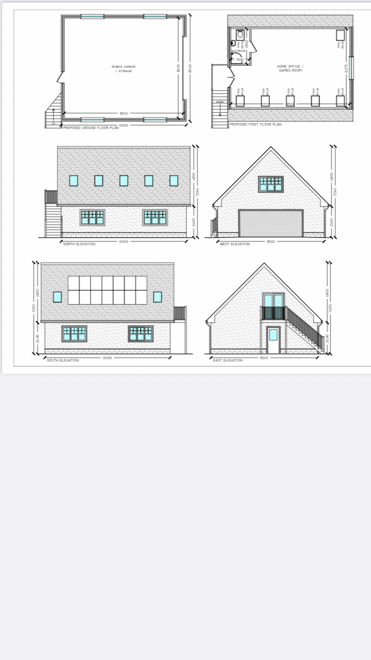

Ecthelion Posted September 18, 2023 Posted September 18, 2023 (edited) The garage I have just built is 113sqm of usable floor space and including a small kitchen and bathroom and flooring etc in the upstairs it came in at £1249 per sqm. This is in Ayrshire. The builders built the timber kit themselves apart from the attic trusses. I think I could have swapped the price of the steel door frame, the garage door, the outside staircase at £12k and possible have had a reasonably finished house. There are smaller houses near me by big house builders selling at £375k. And yes I paid vat on everything. but I was very lucky with these builders who I trusted because they worked very hard at pricing the job, looking into everything. I had 2 cheaper quotes but I know they would end up costing more because they hadn’t done their homework. in Scotland, there’s hope for self build but it dwindles by the day. Edited September 18, 2023 by Ecthelion
Eric Posted September 18, 2023 Posted September 18, 2023 On 18/09/2023 at 16:10, Ecthelion said: The garage I have just built is 113sqm of usable floor space and including a small kitchen and bathroom and flooring etc in the upstairs it came in at £1249 per sqm. This is in Ayrshire. The builders built the timber kit themselves apart from the attic trusses. I think I could have swapped the price of the steel door frame, the garage door, the outside staircase at £12k and possible have had a reasonably finished house. There are smaller houses near me by big house builders selling at £375k. And yes I paid vat on everything. but I was very lucky with these builders who I trusted because they worked very hard at pricing the job, looking into everything. I had 2 cheaper quotes but I know they would end up costing more because they hadn’t done their homework. in Scotland, there’s hope for self build but it dwindles by the day. Expand Would you mind sharing plans/photos? I am looking for ideas for a garage with room above.
Ecthelion Posted September 18, 2023 Posted September 18, 2023 On 18/09/2023 at 16:29, Eric said: Would you mind sharing plans/photos? I am looking for ideas for a garage with room above. Expand Sure. 1
Ecthelion Posted September 18, 2023 Posted September 18, 2023 (edited) Actually no, sorry, those are the old plans and were going to need to much steel so we reduced slightly. Edited September 18, 2023 by Ecthelion 1
