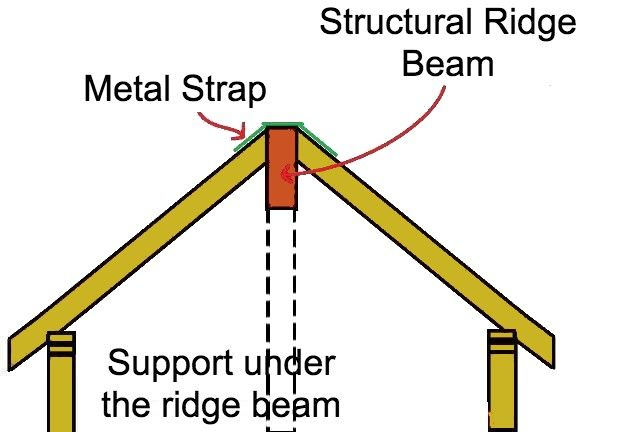

Temp Posted October 10, 2023 Posted October 10, 2023 Ok so he is proposing a structural ridge beam instead of a ridge board. These work by effectively "hanging" the roof from the ridge beam. The ridge beam is typically supported on steel posts, chimneys and gable end walls. The rafters need to be well secured to the ridge beam, possibly with metal straps connecting the rafters one side with the rafters on the other side. This solution is commonly used for "one and a half" story houses where you cannot use prefabricated trusses or triangulate the rafters using joists because the joists would be at the wrong height. Eg not in a floor or ceiling. Make sure your builder understands the concept and follows drawings. In the UK most structural engineers reach for steel beams in this situation. In other countries they seem more willing to use timber beams. The cost of the steel work is one of the disadvantages of 1.5 storey houses but then you save on brick work over a 2 storey.
ProDave Posted October 10, 2023 Posted October 10, 2023 Our house is built with ridge beams like that, in our case Kerto beams (think overgrown plywood) which are smaller for a given strength than say a glulam beam. It makes for a very open roof space, one of the better design choices we made.
JohnMo Posted October 10, 2023 Posted October 10, 2023 This what we did but we used posi rafters, the ridge bean is something like 450 X 200mm. Ridge beam is about 16m long in two parts
