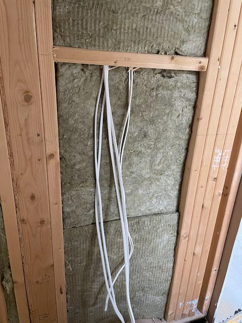

16 minutes ago, markharro said:
Thanks @Thorfun thats the sort of answer I like. It was actually our architect who suggested doing this but of course he's not the one doing the work. You point about cabling is interesting. Last week the electrician started on this and we now have a lot of cables in these void but also in the 90mm voids between rooms and in the ceiling voids. I will be putting insulation in these latter two areas for acoustic reasons. I assume that this should be obvious to the electrician and whatever cabling he has installed will cope with it?!
we filled our 89mm studs with 50mm Rockwool as well. no issues with the cabling that our sparky mentioned. I presume it's because the cables are running in the insulation but rather sat on top like this photo
but maybe @ProDave can give a definitive answer?
No the spark won't and you are heading for big trouble if you start to insulate cables that are designed to be in a void for example.
Your spark will have carefully sized the cables based on if they are in a void or have insulation close. You are now adding insulation on a whim.
This is very serious and you need to talk to your spark. I have seen fires occuring in extensions to houses as a result of design changes like this... the house down the road from me went on fire for this kind of reason.
Your other designers (and that now seems to include you as you are making technical design decisions) should be alerting you to this.. or do they not have enough experience and that includes you too?

Thanks @Gus Potter I appreciate your advice. I have spoken to the spark today and all is ok. I have concluded that its better not to bother insulating these shallow voids - there is more than enough stuff to do to last a lifetime in any event.
Thanks @Kelvin for the article link- useful conclusion appears to be to route cabling above any thermal insulation. I suppose in walls that means just on the outside of the insulation layer rather than buried in the middle.
