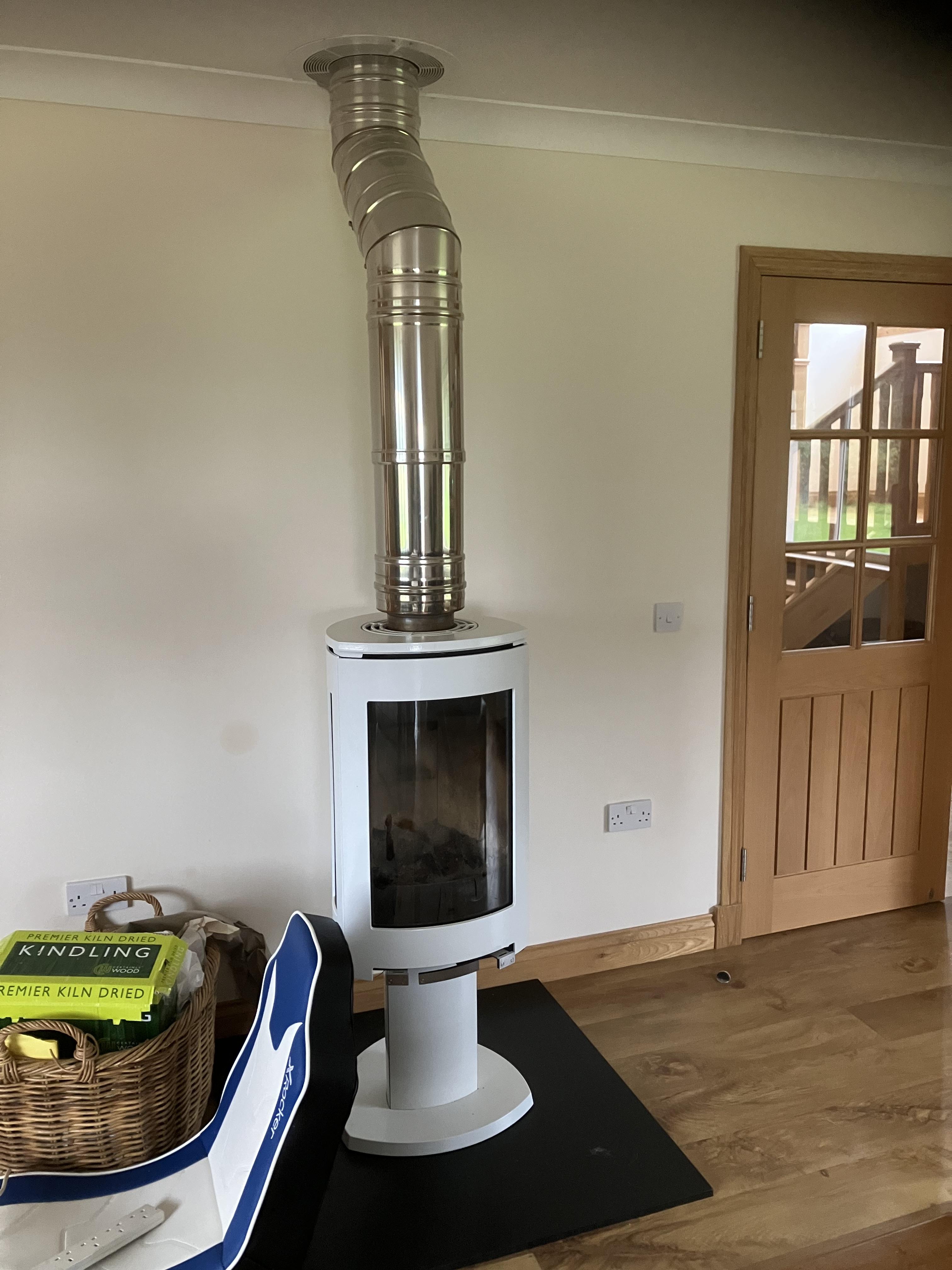

Ecthelion Posted September 18, 2023 Posted September 18, 2023 (edited) On 10/09/2023 at 07:53, Pasty said: Hi All. We are hoping to be first time self-builders in rural Perthshire/Stirlingshire next year....when we find a plot of land. We have a design/layout in mind though appreciate this will probably need to be amended to allow for the aspect and topography of the site. Whilst the search goes on we have time to absorb plenty of knowledge from the experience of forum members. Questions of help will no doubt follow Thanks Exciting times! I built in Ayrshire and learned a couple things. Things I would recommend if building rurally are: do underfloor heating. get an ASHP - you will get £9k grant from Scottish government and with zero rate vat that should cover pretty much the full cost. I can highly recommend the Grant Aerona R32. getting the ASHP unlocks funding for solar panels and batteries. You would get £1250 toward each and the remainder as an interest free loan payable over 10 years. So if you have a south or even SE or SW roof design them in. I got the ones which sit in the roof rather than on top and they look very neat. Put data cabling everywhere alongside the electrics. Cat 6A. My biggest regret is not doing this. We have 1gb fibre but have to rely on mesh system and front haul so we don’t get the full benefit, maybe we will when WiFi 7 comes out but that’s going to be an expensive upgrade. If you are having a wood burner and it is more central in your house rather than on an external wall you can get additional heat benefit upstairs with louvres and things rather than having the flue just encased behind plasterboard. Edited September 18, 2023 by Ecthelion

Pasty Posted September 18, 2023 Author Posted September 18, 2023 Thanks all and @Ecthelion for the photos. Good pointers on the data cabling and wood burner. We don't have a house design as such yet though I hadn't planned to put UFH upstairs so the wood burner tip might work very well.
Ecthelion Posted September 18, 2023 Posted September 18, 2023 15 minutes ago, Pasty said: Thanks all and @Ecthelion for the photos. Good pointers on the data cabling and wood burner. We don't have a house design as such yet though I hadn't planned to put UFH upstairs so the wood burner tip might work very well. Aye we don’t have UFH upstairs either. I’ve only ever see that once, on a TV show and it seemed absurd. Unless maybe just the electric kind in bathrooms etc. We went with radiators upstairs and Karndeal tiles in the bathrooms. They don’t really get cold like traditional tiles.
