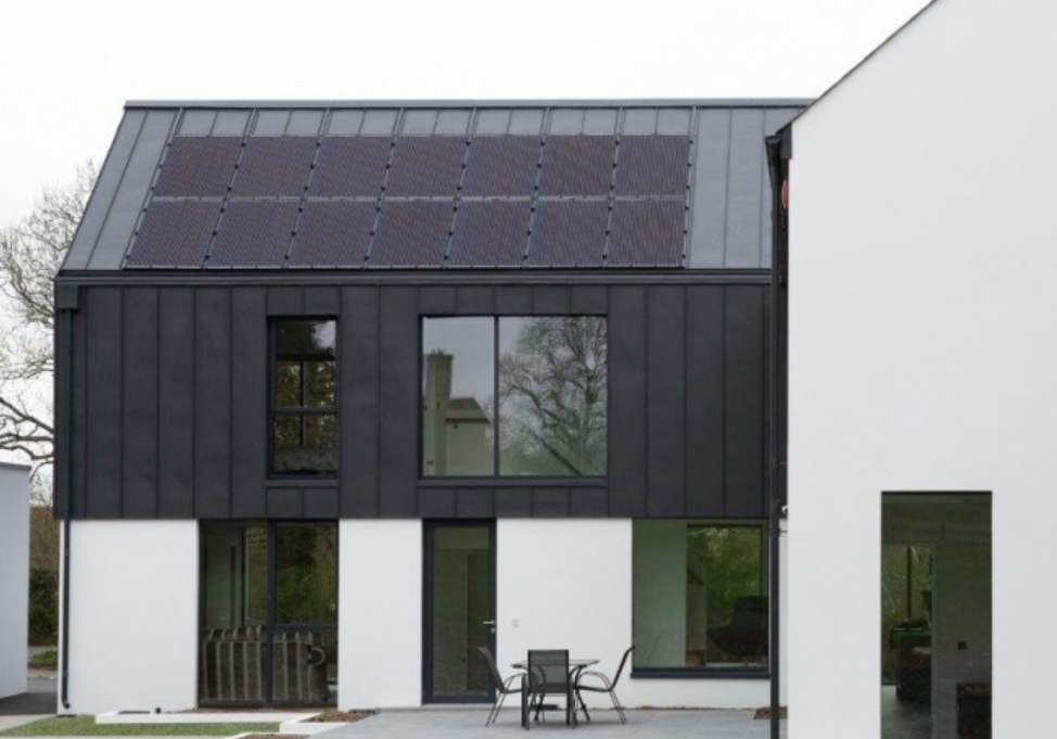

WisteriaMews Posted September 8, 2023 Posted September 8, 2023 We're hoping to soon submit for planning on a new Passive House in a conservation area. We suspect we'll have an easier ride through planning if we show integrated/ flush solar panels on the roof. Integrated panels on tile roofs are pretty common (we have them on our current roof) but we can only find one example (attached image) of integrated panels on a metal standing seam roof which is what we are going for. Has anyone integrated panels on a standing seam roof? I'm hoping for an indication of whether it is doable/ isn't cost prohibitive before stating we can do it in planning.

JohnMo Posted September 9, 2023 Posted September 9, 2023 If you look at the image you provided, the panels are not integrated, they stand on the top of the seams. You use rail less standing seam clamps. 1

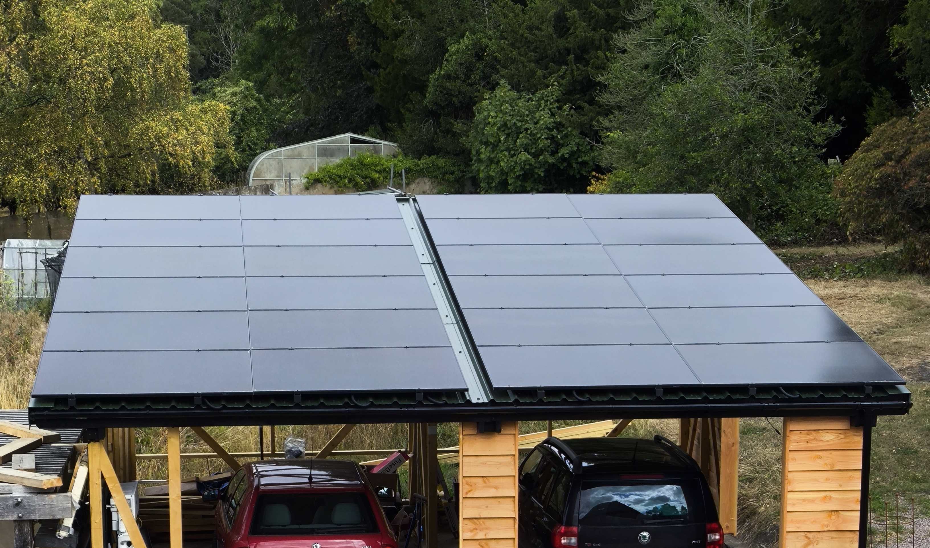

Beelbeebub Posted August 21, 2025 Posted August 21, 2025 This may not be what you're after, but I fitted my panels onto trapizodal "32/1000" pvc coated roof sheets - think industrial roofing. It's about as cheap as roofing gets and the panels fit really easily to the tops of the profile with small "mini rails". The trick was to have the panels go edge to edge and eaves to ridge of the roof, which I could do as it was a mono pitch (though it would work with a duo pitch). And, though it's not suited to every aesthetic or roof layout, it does work especially well on outbuildings (mine was a carport) 2
-rick- Posted August 21, 2025 Posted August 21, 2025 That looks good. On a real roof you couldn't do this exactly as you need a walkable area for regs AFAIK (the systems that do edge to edge use special panels designed to take the load). If I ever get to build I've been wondering if its possible to do something similar but with added metal trim around the walkable area/spaces to make it look like an integrated roof without the added cost. GSE is an alternative but I like the idea of being able to replace the panels with next gen ones without having to redo the whole roof which GSE would require if you can't find panels of the exact same size.
-rick- Posted August 21, 2025 Posted August 21, 2025 1 hour ago, -rick- said: On a real roof you couldn't do this exactly as you need a walkable area for regs AFAIK (the systems that do edge to edge use special panels designed to take the load). I may be wrong with this. I went to check and read plenty about keeping a border around the panels but coming up blank finding a regs requirement. Might be something to do with MCS or specific mounting systems.
Beelbeebub Posted August 21, 2025 Posted August 21, 2025 There was a fair bit of discussion about the border, but nobody could come up with exactly why it should be there. The closest explanation was wind uplift, but if it's not on a roof ie just panels on a frame there is zero margin. We did fix the edges of the roof and the panels extra securely, plus we are in a fairly sheltered area - might not do this if we were on top of a cliff on the West Coast of Scotland! Regarding access, the central gap was left for exactly that, and access to the outer panels is safer from the sides anyway. My case is fairly specific but does show what is possible. I did look at using the gse system but cost wise this was cheaper and also easier to install. The pitch is only 12deg which loses a bit of output, but was done for aesthetic reasons plus it means the roof was safely walkable for installing the panels 1

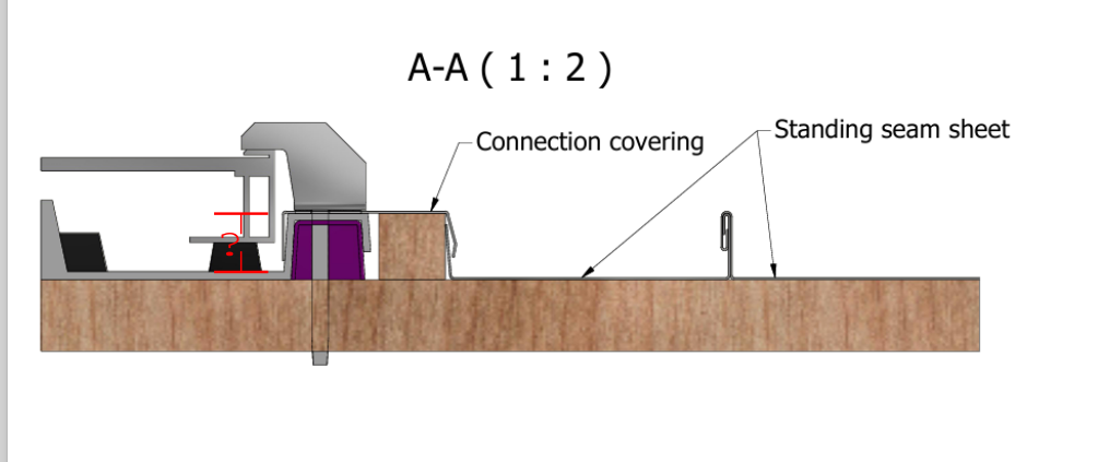

flanagaj Posted August 23, 2025 Posted August 23, 2025 I having been looking at the GSE technical drawings in relation to fitting them with a standing seam roof and I think I might have an idea for how it could work. They currently show it as follows But I am thinking, that if you were to raise the standing seam roof up to the level of the part marked 'connection covering'. Which is achievable as the standing seam will sit on battens + OSB, whilst the GSE will sit on just horizontal battens attached to the rafters, then you already have a height differential. If you did this, then you could in theory bin the connection covering and simply run the standing seam panel under the solar panel bracket and then have a 90 degree fold down. This would then make the panels look more sat into the roof. I just need to see how it would work with the flashing by the ridge. Running the panels down to the gutter line would also look quite neat as well.
JohnMo Posted August 23, 2025 Posted August 23, 2025 1 hour ago, flanagaj said: But I am thinking, I think you should stop that, it will never go well. The ? isn't really that high, if I recall correctly, about 30mm - 40mm
flanagaj Posted August 23, 2025 Posted August 23, 2025 2 hours ago, JohnMo said: I think you should stop that, it will never go well. The ? isn't really that high, if I recall correctly, about 30mm - 40mm You have to think outside the box
