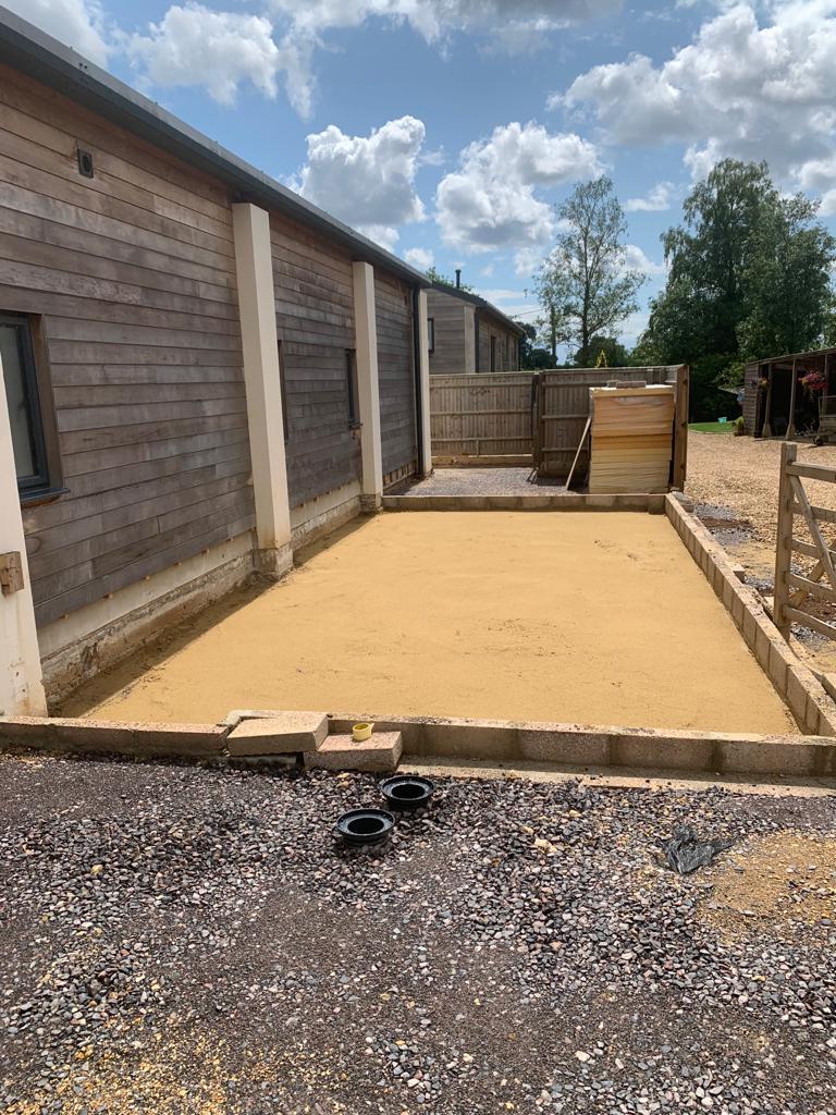

JayDee Posted September 7, 2023 Posted September 7, 2023 Looking for some advice please. Doing a 8.5m x 4.4m concrete slab for a house extension. Substrate to slab floor height is a total of 250mm. Dpm and 100mm insulation going in first, then pour a 150mm concrete slab over the 100mm insulation. Reason for the 150mm thick concrete is for polished concrete floor finish, to help prevent the slab cracking. I'm aware the overall max recommendation for screed on ufh pipes is 100mm . Although with 150mm screed thickness over the ufh pipes that are at the bottom of screed, and on top of the insulation. Will it still work ok? Or should this be avoided? I guess it would take longer to heat up, but if its set and maintained temp it should still store the heat and work ok? I could possibly add 25mm insulation to increase to 125mm and decrease concrete thickness to 125mm if needed. Although not ideal, as can increase the risk of slab cracking. ufh would be best as the existing house already has a heat pump ufh system, and adding two zones in the new extension is fine for the current system to cope. However, due to the 150mm thick concrete screed, should another heating method be considered instead? Like radiators etc... instead of ufh? Picture attached. Thanks in advance.

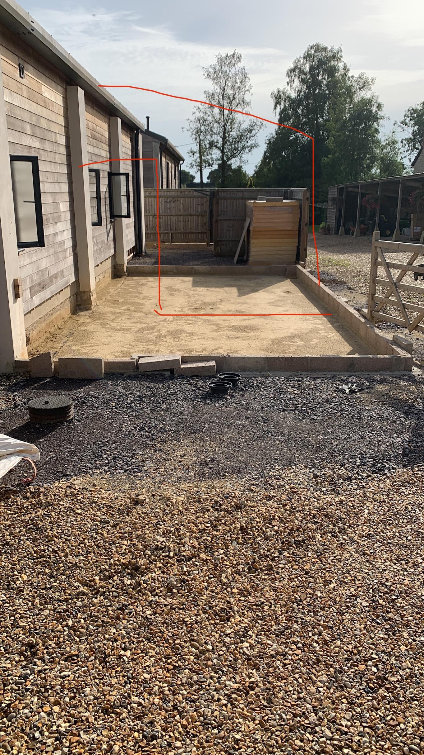

JayDee Posted September 11, 2023 Author Posted September 11, 2023 22 minutes ago, saveasteading said: However with careful preparation at the perimeter, crack inducers under partition walls and quality control of the concrete, the cracks will be minimal. All very helpful information. There is an internal wall going in, splitting the extension equally into two rooms/zones with a door way on the left hand side (the existing building side). Internal wall extending from the centre column to the outside wall. (see picture) I was considering cutting a joint 1/3 depth of slab, beneath the internal wall however was wondering I might getaway without it as the joint will then be exposed in the door way. Not heard of the inducers before, is this a better way of doing it and what type of inducer and where to get? The last conundrum I'm battling is, do I need to add another 25mm pir boards on top of the 100mm or will the 100mm pir be ok? One ufh guy i spoke to said don't worry, another ufh guy said add it, but mainly to decrease the slab thickness. After reading the comments above, I'm ok with the slab thickness heating slower if there's no significant increase in energy consumption. Though I will add 25mm pir if 100mm pir isn't enough. If it's not a big deal, so long as the joins are taped properly I'll save the faff adding the additional pir... thoughts?

saveasteading Posted September 11, 2023 Posted September 11, 2023 2 minutes ago, JayDee said: will the 100mm pir be ok? It's ok but 125 is better. the sawcut is the tidiest as it is exactly where you want it. Inducers are plastic things placed below that spot to make the slab weaker at that precise spot, but the cut should be enough . It would have to go full width though including the doorway, and all the way to the walls. i don't know if that works for your intended slab. 1
