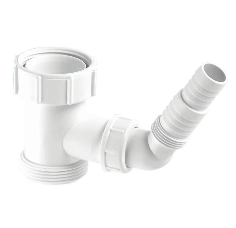

Thorfun Posted September 5, 2023 Posted September 5, 2023 simple one.....how would I go about getting a 22mm hep2o pipe to discharge into a soil pipe?
Big Jimbo Posted September 5, 2023 Posted September 5, 2023 Poke it in the open end. Sorry couldn't resist that 1
Timedout Posted September 5, 2023 Posted September 5, 2023 What about solvent weld overflow pipe. There are adapters off the shelf. Very similar dimensions.
FuerteStu Posted September 5, 2023 Posted September 5, 2023 Would you need to know if it was discharging? I've seen a pressure release dumping Mains water down a drain for months unnoticed.
Thorfun Posted September 5, 2023 Author Posted September 5, 2023 52 minutes ago, Big Jimbo said: Poke it in the open end. Sorry couldn't resist that Should’ve clarified that without leaking would be preferable! 😂 1
Thorfun Posted September 5, 2023 Author Posted September 5, 2023 50 minutes ago, Timedout said: What about solvent weld overflow pipe. There are adapters off the shelf. Very similar dimensions. Need something using proper fittings rather than cobbled together with parts of similar dimensions. 39 minutes ago, TonyT said: Strap on boss connector sure, but what connectors for 22mm Hep2o to solvent weld? 36 minutes ago, FuerteStu said: Would you need to know if it was discharging? I've seen a pressure release dumping Mains water down a drain for months unnoticed. Nope. Don’t need know. Just need it secure and leak free.
FuerteStu Posted September 5, 2023 Posted September 5, 2023 Im not sure if there is a straight to waste from 22? But could you use a small washing machine Rubber drain hose into a macalpine?
TonyT Posted September 5, 2023 Posted September 5, 2023 https://www.screwfix.com/p/mcalpine-boss-connector-white-22mm/719hr 1
Thorfun Posted September 6, 2023 Author Posted September 6, 2023 @Nickfromwales will the above boss connector work with a hep2o 22mm pipe? i've read before that you said not to use compression with hep2o pipe although others have different opinions on that subject!
Thorfun Posted September 6, 2023 Author Posted September 6, 2023 3 hours ago, Thorfun said: @Nickfromwales will the above boss connector work with a hep2o 22mm pipe? i've read before that you said not to use compression with hep2o pipe although others have different opinions on that subject! actually, this is a stupid question i think! if i'm worried about compression on to the hep2o then i can just couple to 22mm copper and compress that into the above boss connector. sorry for my daftness!
dpmiller Posted September 6, 2023 Posted September 6, 2023 ^ that's a rubber waste compression, not metal olive 1
Thorfun Posted September 6, 2023 Author Posted September 6, 2023 6 hours ago, dpmiller said: ^ that's a rubber waste compression, not metal olive Thanks. I ordered one today so will fit it this weekend and will see what happens!
Nickfromwales Posted September 6, 2023 Posted September 6, 2023 Is the water discharging under pressure? What's the pipe servicing?
Thorfun Posted September 7, 2023 Author Posted September 7, 2023 8 hours ago, Nickfromwales said: Is the water discharging under pressure? What's the pipe servicing? Only gravity. This is the discharge from the RWH header tank. If the water has been in the tank unused for a period of time it is flushed out using gravity and replaced. The manufacturer suggests running the 22mm pipe back to the tank so it can be re-used but that’s a long way and I’m not worried about doing that. So I just want to discharge to a soil pipe. although, now I think about it that water will go straight in to my STP rather than out to the ditch.
