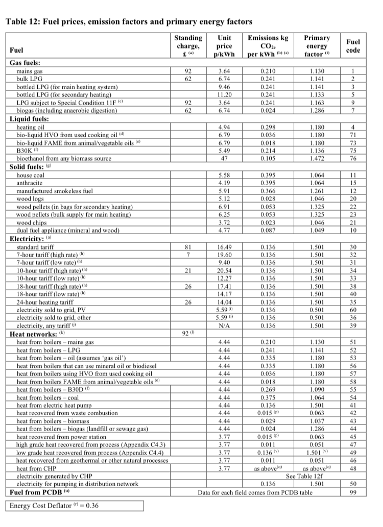

MikeGrahamT21 Posted September 3, 2023 Posted September 3, 2023 (edited) Found this on a blog… https://myhomefarm.co.uk/our-bivalent-heat-pump-and-hvo-biofuel-are-we-still-green HVO derived from waste cooking oil and fat has a verified carbon emission factor of 0.036kg/kWh, compared to 0.298kg/kWh for kerosene. This is based on the latest edition of the government’s Standard Assessment Procedure for Energy Rating of Dwellings (SAP 10.2). Edited September 3, 2023 by MikeGrahamT21
saveasteading Posted September 3, 2023 Posted September 3, 2023 4 minutes ago, MikeGrahamT21 said: 0.036kg/kWh, compared to 0.298kg/kWh for kerosene Is there a rogue decimal point in there,ie both close to 0.3 or 0.03?
MikeGrahamT21 Posted September 3, 2023 Posted September 3, 2023 (edited) no looks correct to me as far as the official figures suggest Edited September 3, 2023 by MikeGrahamT21
ProDave Posted September 3, 2023 Author Posted September 3, 2023 1 hour ago, MikeGrahamT21 said: HVO derived from waste cooking oil and fat has a verified carbon emission factor of 0.036kg/kWh, compared to 0.298kg/kWh for kerosene. I would love to know the convoluted thinking that came up with that. They are obviously not suggesting that the actual burning of the fuel actually creates 1/10 the CO2 that burning the same quantity of fossil fuel diesel or kerosene does. So they must somehow be counting it as a boifuel and falling into the same old "The CO2 was only just removed from the atmosphere so it's carbon neutral to let it back" nonsense. If that is the logic then sorry but we are doomed. I just can't understand how people fall for that, other than if they don't actually care about the outcome, they just view it as an easy way to comply and claim to have reduces CO2.
