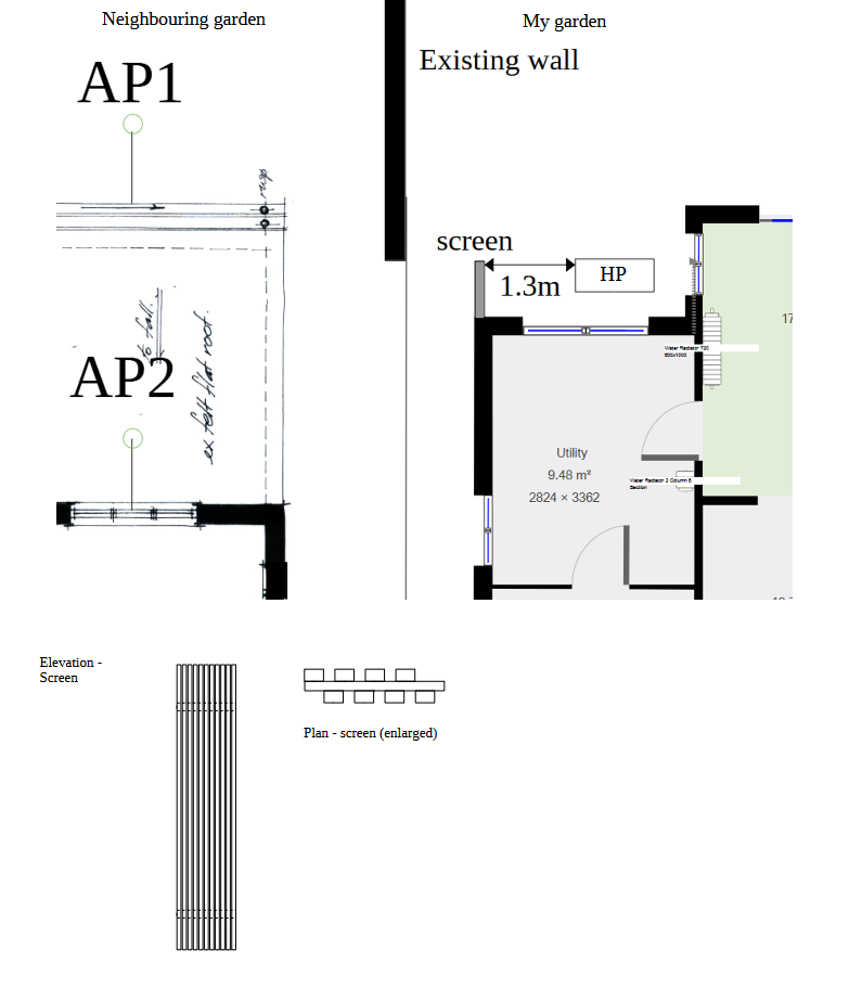

JamesPa Posted August 31, 2023 Posted August 31, 2023 I'm finalising the details of my ASHP installation, now scheduled for mid October under PD. As part of the design there will be a ~2.3m high 750mm wide 'screen' which will provide both sound isolation from the neighbours and, serendipitously, resolve a visual mess visible from one of our windows. The screen supplements a barrier already provided by a wall of my house and an existing brick wall. Im thinking of an offset 'hit and miss' design built from 20mmx45mm cedar, sketches of location and screen design below. The requirements are Not to reflect too much sound back towards (my) window to the right of the HP Attenuate sound reaching AP2 (mostly its attenuated by my house wall anyway look superb (or at least visually attractive) not cause a problem with air flow I am certain it achieves 2 - 4. I have a slight worry about 1, but am hoping that the complexity provided by hit and miss will resolve this. There is probably going to be an element of trial and error, and to be honest I'm not expecting it will cause any problem for the neighbours even without the screen, as the unit itself is the '7kW' (8.5kW in reality at -2/45) Vaillant which is one of the quietest on the market and Quietmark certified. Does anyone wish to/feel able to comment in order to help improve the design?

saveasteading Posted August 31, 2023 Posted August 31, 2023 The use of alternating planks is crucial to sound reduction, so that is a great start. Is it about 5m high as the elevation suggests? I'd make the panel longer, overlapping the wall position, as noise will bounce through that gap. 1 hour ago, JamesPa said: mostly its attenuated by my house wall anyway I'm not confident of that: any gap allows a high proportion of sound through. I wouldn't put any roof or insulation in. You need lots of unobstructed air flow.

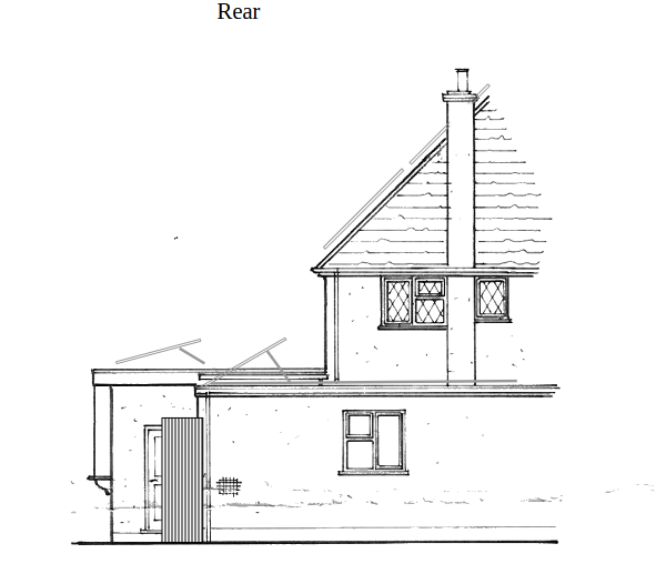

JamesPa Posted August 31, 2023 Author Posted August 31, 2023 (edited) 1 hour ago, saveasteading said: The use of alternating planks is crucial to sound reduction, so that is a great start. Is it about 5m high as the elevation suggests? I'd make the panel longer, overlapping the wall position, as noise will bounce through that gap. I'm not confident of that: any gap allows a high proportion of sound through. I wouldn't put any roof or insulation in. You need lots of unobstructed air flow. Thanks. Its about 2.3m high in order that assessment point (1m in front of the window) is not visible from any position 25cm from the pump. Thats just a bit less than the height of the (single storey) wall that it abuts (which obscures most of the view) - elevation below (panel being the arrangement of vertical rectangles) I intend to have no gap between wall and panel however the planks will have gaps between them (because the horizontal member holding them together passes between them to let air through (including wind!) but without any direct line of sight. (edit, by wall did you mean the boundary wall not the house wall?) 1 hour ago, Beelbeebub said: The best approach woukd be to "suck it and see" Install it and see how much the sound bounces about. Having worked with noise attenuation (from roads and industrial sites) itvs really tricky. Sometimes barriers can make things worse! It may be the noise is perfectly acceptable with no barrier, then the issue is simply visual. Pretty much my intent. I may even build a prototype out of cheap wood first (I happen to have plenty kicking around) before committing £300 worth of cedar) Edited August 31, 2023 by JamesPa
saveasteading Posted August 31, 2023 Posted August 31, 2023 22 minutes ago, JamesPa said: did you mean the boundary wall yes. noise will bounce of the house wall and door and through the gap.
JohnMo Posted August 31, 2023 Posted August 31, 2023 You should really should go through the noise assessment for MCS. From your sketch you appear to have 4 walls to reflect the noise. Have you considered moving else where, like where it says Existing wall. Way less surfaces to bounce noise off.
JamesPa Posted August 31, 2023 Author Posted August 31, 2023 (edited) 37 minutes ago, JohnMo said: You should really should go through the noise assessment for MCS. From your sketch you appear to have 4 walls to reflect the noise. Have you considered moving else where, like where it says Existing wall. Way less surfaces to bounce noise off. Thanks for the comment. Two walls and the ground within 1m = 3 reflective surfaces according the MCS noise assessment which has of course been done. 'Existing wall' is the boundary wall so not allowed because within one metre of boundary. The words themselves are in the middle of the route from patio to garden and would definitely be visible from ap2. It might just pass the MCS criterion but by a smaller margin than proposed location without visibility. 2 hours ago, saveasteading said: yes. noise will bounce of the house wall and door and through the gap. Thanks also for the comment. The thin line below the wall in the diagram is a fence which, according to MCS, is a barrier because there is not visibility (although I have my doubts MCS is correct, but that's generally the case!). More importantly I can't see the trajectory to which you refer. Can you clarify? The barrier design currently ends more or less level with the end of the wall (based on a projected perpendicular from the house). This gives a 'solid and massive' overlap of 100mm due to the fence ending with a concrete post. Edited August 31, 2023 by JamesPa

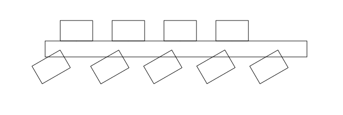

sharpener Posted August 31, 2023 Posted August 31, 2023 6 hours ago, JamesPa said: Not to reflect too much sound back towards (my) window to the right of the HP If there is scope to cant the screen outwards (i.e. rotate anticlockwise in plan) then any reflections would miss the window on the right. In other respects I think you have a good chance of it working. The hit and miss screen will give rise to multiple internal reflections between wood surfaces which should absorb a lot. I don't think scrap iron would be very effective, you have the mass but OTOH the surfaces are reflective and it has virtually no internal damping. Now if only I could remember the handle of the acoustics consultant who was posting on here in the spring...
saveasteading Posted August 31, 2023 Posted August 31, 2023 2 hours ago, JamesPa said: I can't see the trajectory to which you refer. It's not like snooker where the bounce is precise and predictable. Sound waves will bounce off the wall in multiple directions, and probably make it between your new screen and the existing wall. There is also a science to the dimensions of the planks you use, hit and miss, but I have long forgotten any details. You clearly know to adopt hit and miss so perhaps have info on plank sizes too?

ReedRichards Posted September 1, 2023 Posted September 1, 2023 Isn't it going to obstruct the door? Why not move it up and to the right (on the plan view). Or is that a bay window shown on the side elevation?

JamesPa Posted September 1, 2023 Author Posted September 1, 2023 13 hours ago, sharpener said: If there is scope to cant the screen outwards (i.e. rotate anticlockwise in plan) then any reflections would miss the window on the right. Something like this might be possible. At 30degrees slat rotation the reflected sound in principle misses the window and the wall and there is still no line of sight through. Reflections from the rear slats still head towards the window but through a fairly small aperture. Not particularly easy to build though - I think I'm going to suck it and see.
