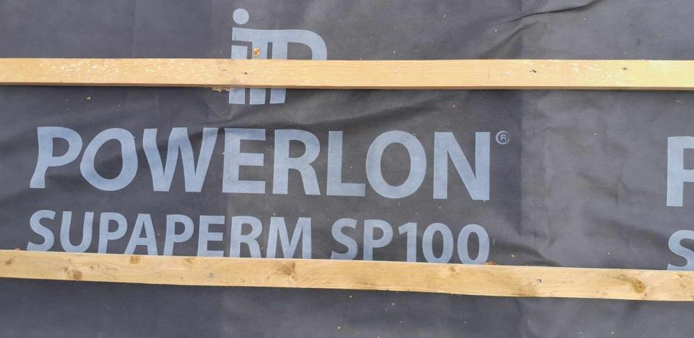

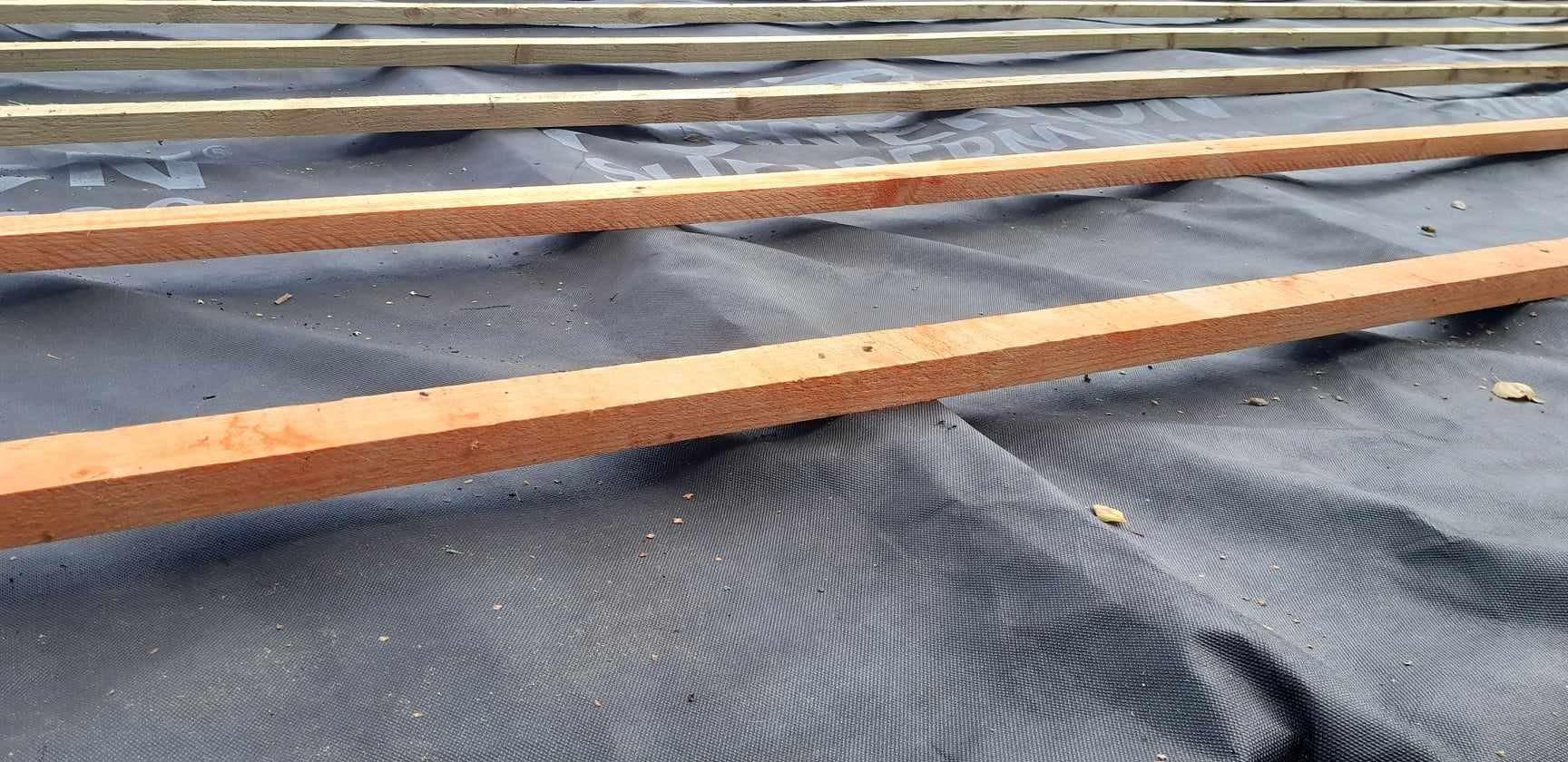

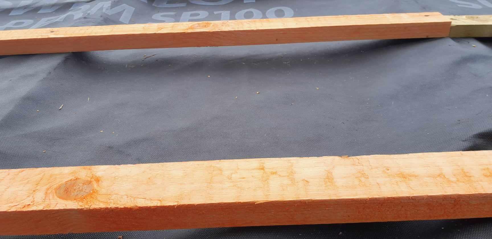

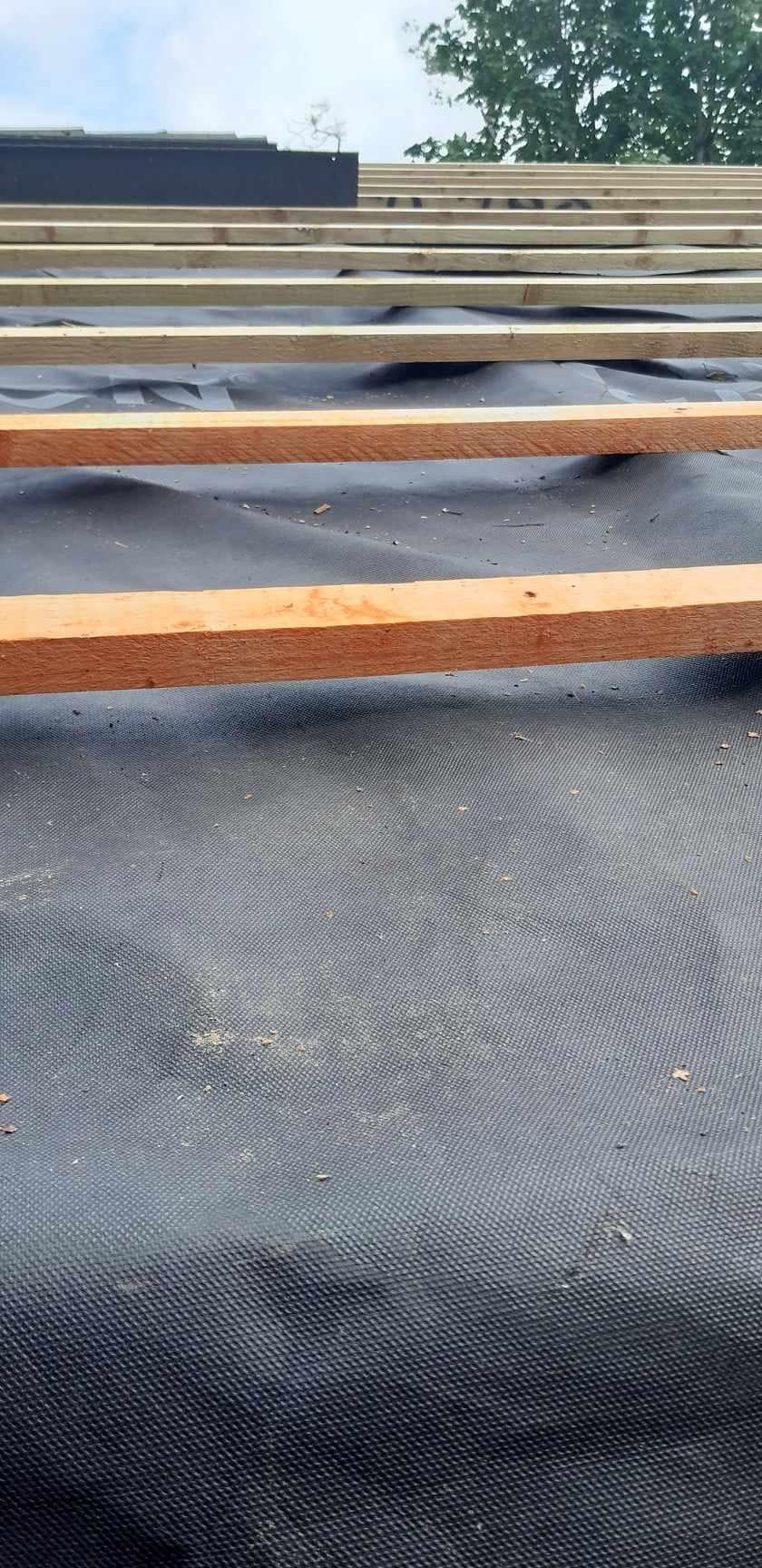

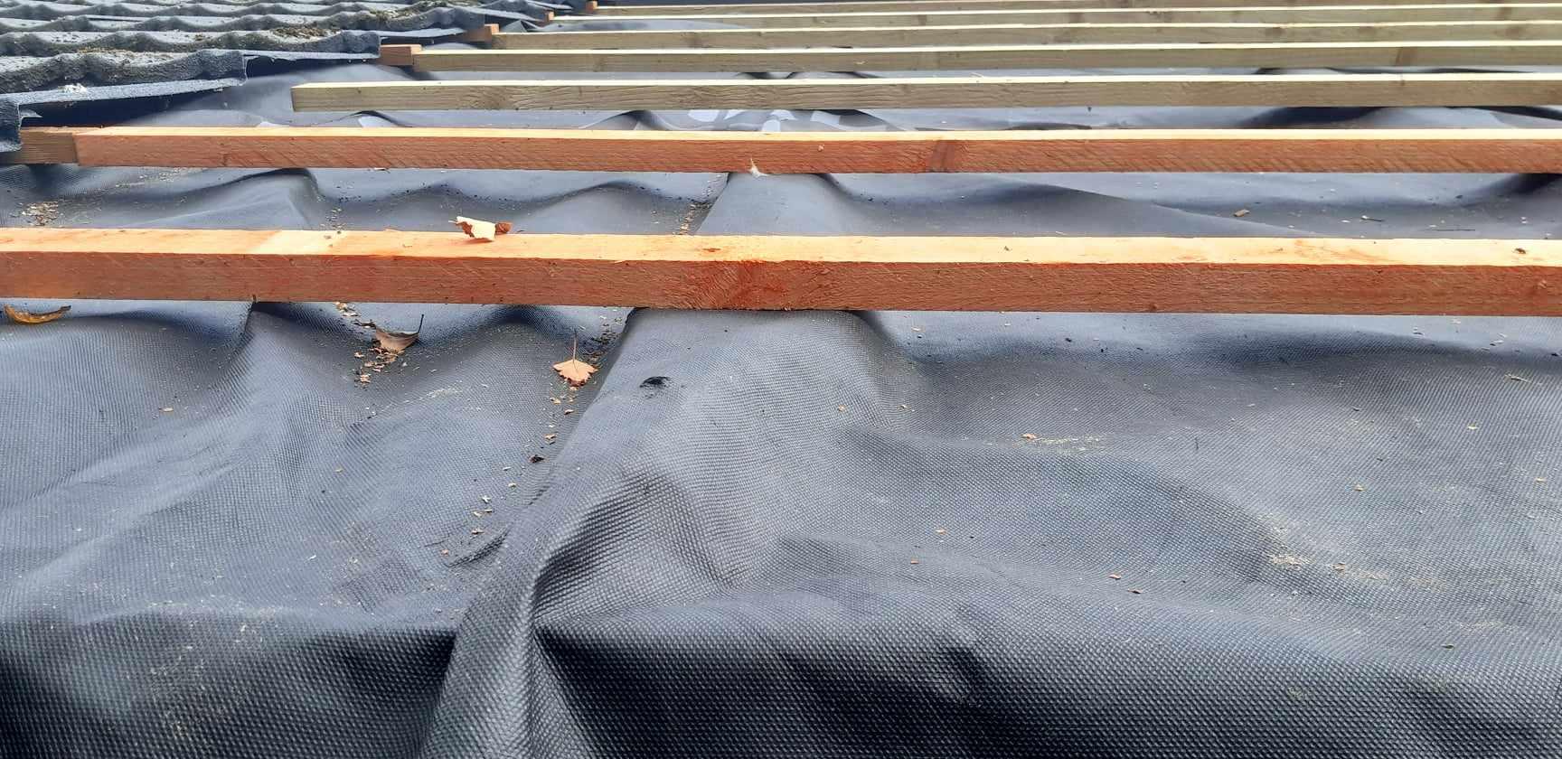

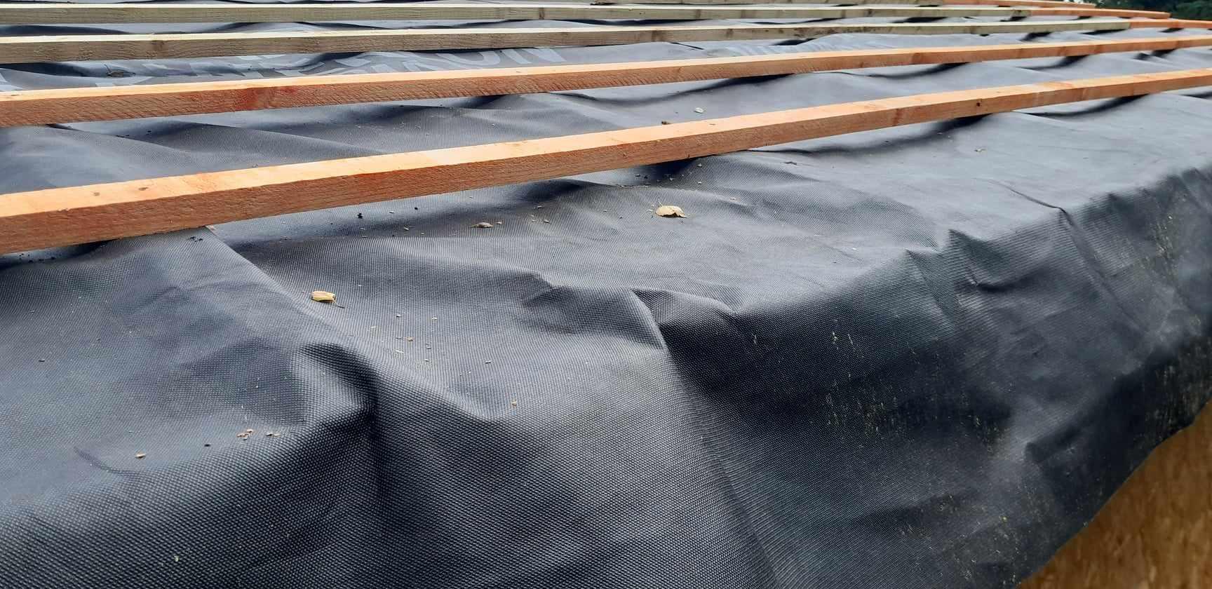

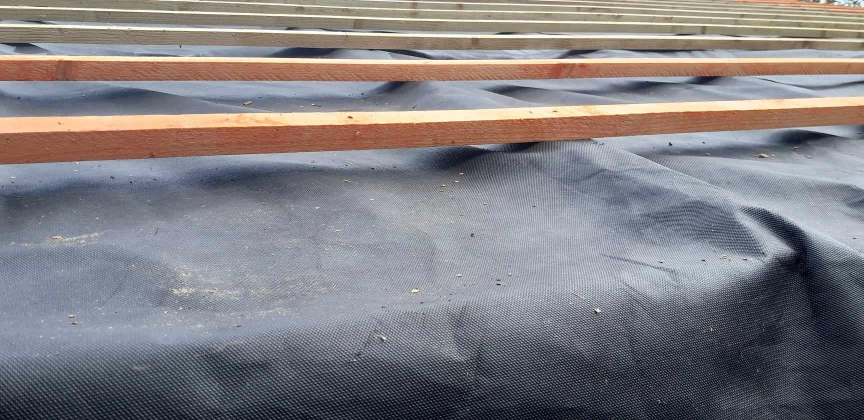

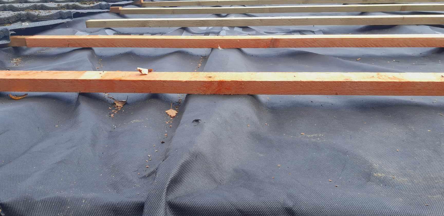

ConcernedCustomer Posted August 28, 2023 Share Posted August 28, 2023 Hi Hope you can advise. We have an extension being built and the builders have put the roofing membrane on which is Powerlon SupaPerm SP100. However it is leaking in several places. We are led to believe that roofing membrane should be put on fairly tight on the battens but we looked at what they have done and it's all very saggy. Have attached photos. Worried that this is a terrible job. This is a general builder - not a roofer who has done this. Should this all be watertight now? Have attached photos Link to comment Share on other sites More sharing options...
joe90 Posted August 28, 2023 Share Posted August 28, 2023 2 minutes ago, ConcernedCustomer said: This is a general builder - not a roofer who has done this. He is not even a good general builder. Yes it’s a crap job 3 minutes ago, ConcernedCustomer said: We are led to believe that roofing membrane should be put on fairly tight on the battens Do you mean this membrane or membranes in general?. Some recommend sagging very slightly to allow any moisture to run down to the guttering but nothing like what he has done. I repeat, a crap job IMO. Link to comment Share on other sites More sharing options...
Big Jimbo Posted August 28, 2023 Share Posted August 28, 2023 Total crap. Roof battens are not even the same size. Sack him off. That is shocking. Link to comment Share on other sites More sharing options...

ProDave Posted August 29, 2023 Share Posted August 29, 2023 11 hours ago, Big Jimbo said: Total crap. Roof battens are not even the same size. Sack him off. That is shocking. And they are not even the coloured ones that are coloured so that building control can easily see that they are treated. No colour, they are probably not treated and building control could fail the job. It needs ripping off and starting again. Sorry. 2 Link to comment Share on other sites More sharing options...

ConcernedCustomer Posted August 29, 2023 Author Share Posted August 29, 2023 Well I contacted his boss last night who is actually a roofer. And guess what - this morning he walks in and says that his boss says the whole lot has to come off and redone. What a relief. We are going to get building control involved as well to inspect everything they do. Thanks for the advice everyone. They said they are going to use different membrane because it should not have leaked like that. I hope they pick the right one for the metro tiles. 4 Link to comment Share on other sites More sharing options...
BadgerBadger Posted August 29, 2023 Share Posted August 29, 2023 Well done! I've just membraned our roof, and you shouldn't really have any obvious leaks. Keep an eye on the battens they're using too, they should be graded and marked. The colour dye thing can be a bit misleading, but if you look at a bundle you should see the BS marking. It's an easy thing for building control to spot check. Link to comment Share on other sites More sharing options...
Kelvin Posted August 29, 2023 Share Posted August 29, 2023 1 hour ago, ConcernedCustomer said: Well I contacted his boss last night who is actually a roofer. And guess what - this morning he walks in and says that his boss says the whole lot has to come off and redone. What a relief. We are going to get building control involved as well to inspect everything they do. Thanks for the advice everyone. They said they are going to use different membrane because it should not have leaked like that. I hope they pick the right one for the metro tiles. Good stuff. Get onto whoever makes the tiles and ask them which membrane they use, require, recommend. Tell builder to use that one. Link to comment Share on other sites More sharing options...
Temp Posted August 29, 2023 Share Posted August 29, 2023 17 hours ago, ConcernedCustomer said: We are led to believe that roofing membrane should be put on fairly tight on the battens No. The membrane should drape/sag slightly between the rafters and not be tight under the battens. If you make it tight you risk dirt and pollen sealing the batten to the membrane and water pooling above the batten causing rot. Any water blown through tiles or slate should run down the membrane into the gutter passing under the batten. That said I think yours is much slacker and more wrinkled than it should be. 4 hours ago, ConcernedCustomer said: Well I contacted his boss last night who is actually a roofer. And guess what - this morning he walks in and says that his boss says the whole lot has to come off and redone. What a relief. We are going to get building control involved as well to inspect everything they do. Thanks for the advice everyone. They said they are going to use different membrane because it should not have leaked like that. I hope they pick the right one for the metro tiles. Good. Link to comment Share on other sites More sharing options...
Temp Posted August 29, 2023 Share Posted August 29, 2023 https://www.roofingsuperstore.co.uk/help-and-advice/project-guides/pitched-roofing/how-to-install-breathable-roof-membrane/ Ensure draping occurs The breathable roof membrane should drape slightly between the timber rafters or counter battens, meaning there is a dip of around 10-15mm. Once you’ve checked that this is the case, add temporary clout nails to the top of the membrane – try to ensure they are above the line at which the second length of the membrane will overlap. When the tiles or slates are fitted they will provide a more secure fixing. Link to comment Share on other sites More sharing options...
