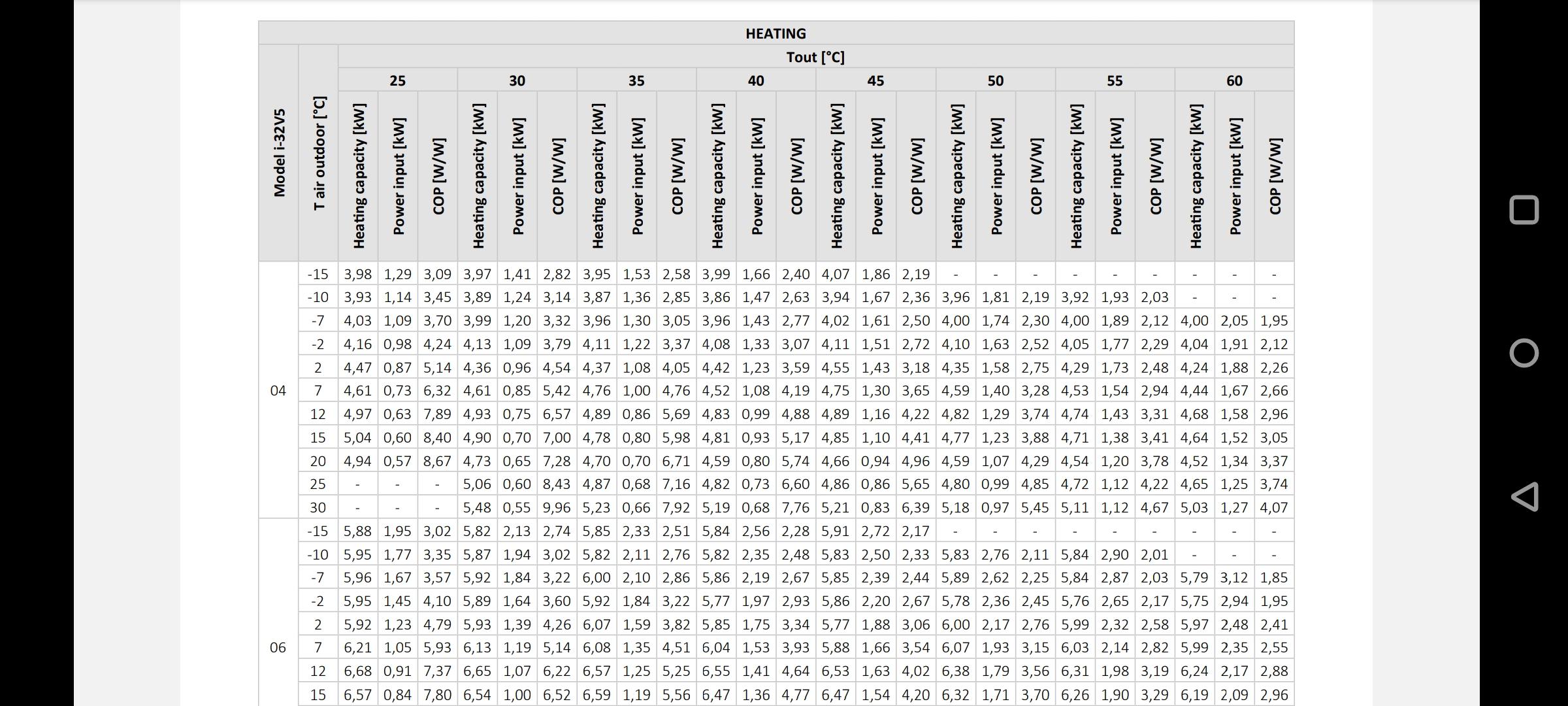

Making a bit more sense now.
Just probably need to do a bit of fine tuning on the flow temps for CH to use the full cheap rate window and have the heat stored you need at the lowest input temp.
Your problem could be you are also trying to heat the cylinder and charge for the floor in only 7 hours.
You may need a simple spreadsheet, to work out best time to heat water and best flow temp to charge the floor, for the least money.
Have attached my ASHP tech spec, which should be good enough to get you going. It outside temp, flow temp, power output, power input and cop. If your heat pump is bigger than 6 have numbers up to 16kW.
