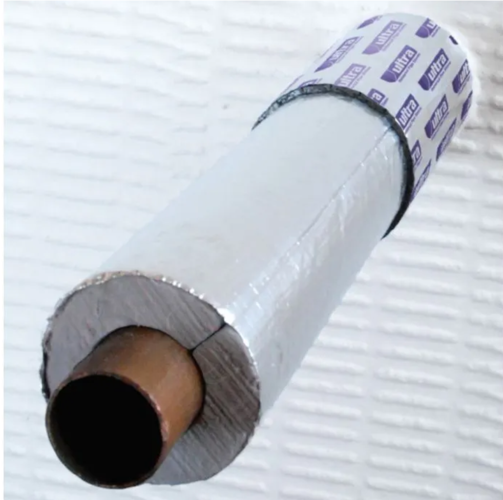

Dave Jones Posted August 25, 2023 Posted August 25, 2023 Looking at our soil pipe layout and it occurs to me this is a large 110mm sized cold radiator running all over the building sucking nice cold air through it from the roof. While I cant find any requirements in SAP to mitigate it, need to do something. Easiest fix is the council house option of putting the stack outside. Obviously a no go. I think I will lag using something like this rather than rely on rockwool. Then there is the issue of venting, standard is to run it to a tile vent in the roof to breath nice freezing cold air. Dergo air admittance at the top of the pipes at ceiling level. BUT we have a combined foul and grey water so the gutters are going into the same run, wonder if the regs would allow the downpipes to act as a vent as they will be the highest point on the run anyway ?

Iceverge Posted August 26, 2023 Posted August 26, 2023 I worried long and hard about this. We have an AAV in the internal soil stack in the house and vent externally on a soil pipe on the garage. Seems to work ok. However you really won't loose as much heat as I thought. Here's a study. Basically is states that 25mm of insulation will make it a non issue. 50mm if you're bothered. https://www.elementalsolutions.co.uk/wp-content/uploads/2012/08/Heat-loss-via-internal-drainage-vent-pipes-full.pdf The dual function of the stack can be split. 1. Use a small (maybe 50mm or smaller) soil stack vent to air to allow for gases to escape and prevent pressurisation while minimising the chimney effect. 2. Add an AAV internally to ensure the traps don't empty. 1 1
Dave Jones Posted August 27, 2023 Author Posted August 27, 2023 very interesting read, good find! In the conclusion they suggest treating the SVP as a cold bridge to ground confirming my suspicions. Will vent through tile vent and insulate as much as possible. probably a bit OTT but we have a long runs throughout the house. "In our uninsulated SVP the average temperature increases by up to 2K, but when insulated the air temperature will be <1K above ground temperature, so we suggest treating this as a thermal bridge to ground rather than air."
