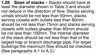

I know it's not ideal, but I need to work out a smaller size if I can. I see in Part H the paragraph below. Am I to understand from that it's OK to have a 75mm waste pipe from an <=80mm outlet toilet:
https://assets.publishing.service.gov.uk/government/uploads/system/uploads/attachment_data/file/442889/BR_PDF_AD_H_2015.pdf
1.28 is referring to the vertical stack, not the connection to the WC.
The part between the WC and the stack is the 'branch connection'. So the rule at 1.15 applies and for an 80mm outlet toilet you either need a minimum 80mm or 75mm pipe. But, as Temp says, in practice you're limited by what's on the market. And I too would stick to 110mm - unblocking drains isn't my idea of fun.
