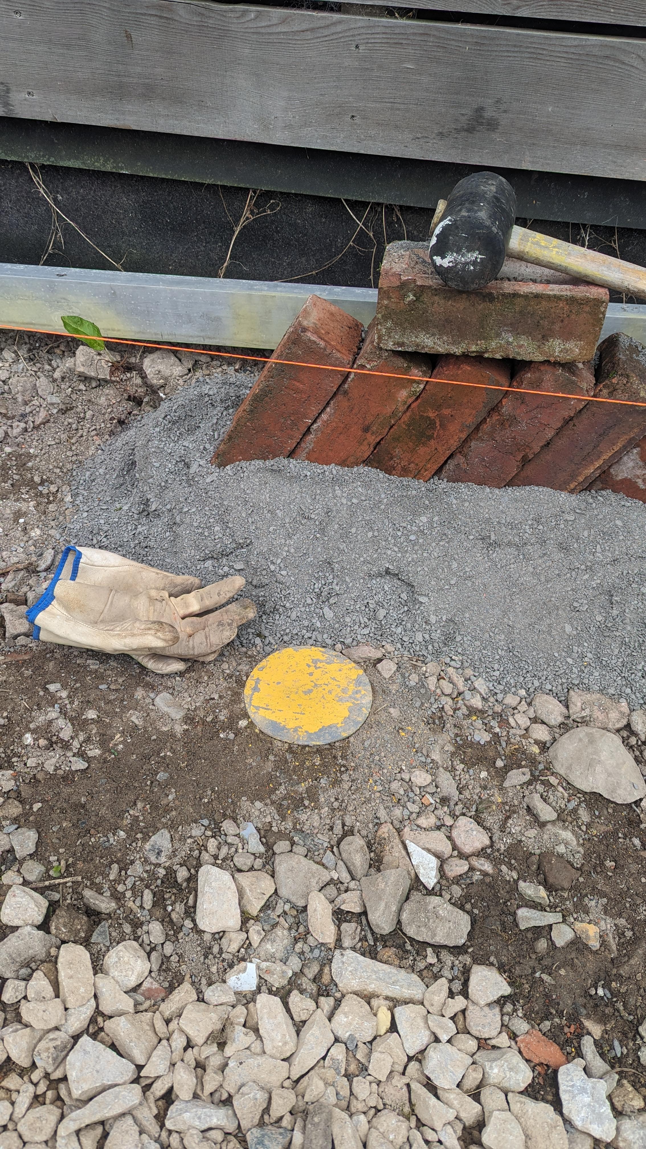

ToughButterCup Posted August 22, 2023 Share Posted August 22, 2023 After forgetting it was there, and starting to lay the path around the outside of the house, I rediscover our radon outlet. I feel like ignoring it, but I suppose I'd better cover it with a rodding eye cover hadn't I? Or can I just ignore it and just lay the path over the top of it. She Who Must Be Obeyed suggests we just put a large plant pot there. You decide, please would you? I'm just too knackered and frankly I can't be ar@ed. Link to comment Share on other sites More sharing options...
ProDave Posted August 22, 2023 Share Posted August 22, 2023 Isn't it to vent radon gas so should it not be open? Where does it actually go? What happens if it is so open rainwater gets in? Link to comment Share on other sites More sharing options...
Big Jimbo Posted August 22, 2023 Share Posted August 22, 2023 No idea. Sorry. But the path edge is going to be nice if that helps. 1 1 Link to comment Share on other sites More sharing options...
saveasteading Posted August 22, 2023 Share Posted August 22, 2023 It has to be free to air and best to have a rain cap. Is there only one such? It is best to have one each end of a porous pipe under the building. Link to comment Share on other sites More sharing options...
ToughButterCup Posted August 22, 2023 Author Share Posted August 22, 2023 Its just a pipe laid to a radon sump under the middle of the sitting room floor, about 500mm below my feet as I write (below FFL). Rainwater? Hmmm, hadn't thought of that. 2 minutes ago, saveasteading said: It has to be free to air and best to have a rain cap. Is there only one such? It is best to have one each end of a porous pipe under the building. Christ I have to give it wee bonnet as well now ? Jesus. The BR spec says it has to be vented above ground. I suppose I ought to dig down now - while I still can without too much bad language - shorten the pipe and bring it to the surface just behind (inside) the brick edging. Oh Lord ... rats ... how to prevent ingress? Link to comment Share on other sites More sharing options...
BotusBuild Posted August 22, 2023 Share Posted August 22, 2023 My groundworker said the pipes will just fill up with water, you've ticked the BC boxes, as long as you can show you have a way to blow the "heavier than air" Radon out of the pipes if needed, you're good to go 🤣. So, cap it, leave it. Link to comment Share on other sites More sharing options...
ProDave Posted August 22, 2023 Share Posted August 22, 2023 26 minutes ago, BotusBuild said: My groundworker said the pipes will just fill up with water, you've ticked the BC boxes, as long as you can show you have a way to blow the "heavier than air" Radon out of the pipes if needed, you're good to go 🤣. So, cap it, leave it. In @ToughButterCup case could you not run the pipe underground horizontally with a slight fall and vent it out further down the slope, that would let the heavier than air gas out. 1 Link to comment Share on other sites More sharing options...

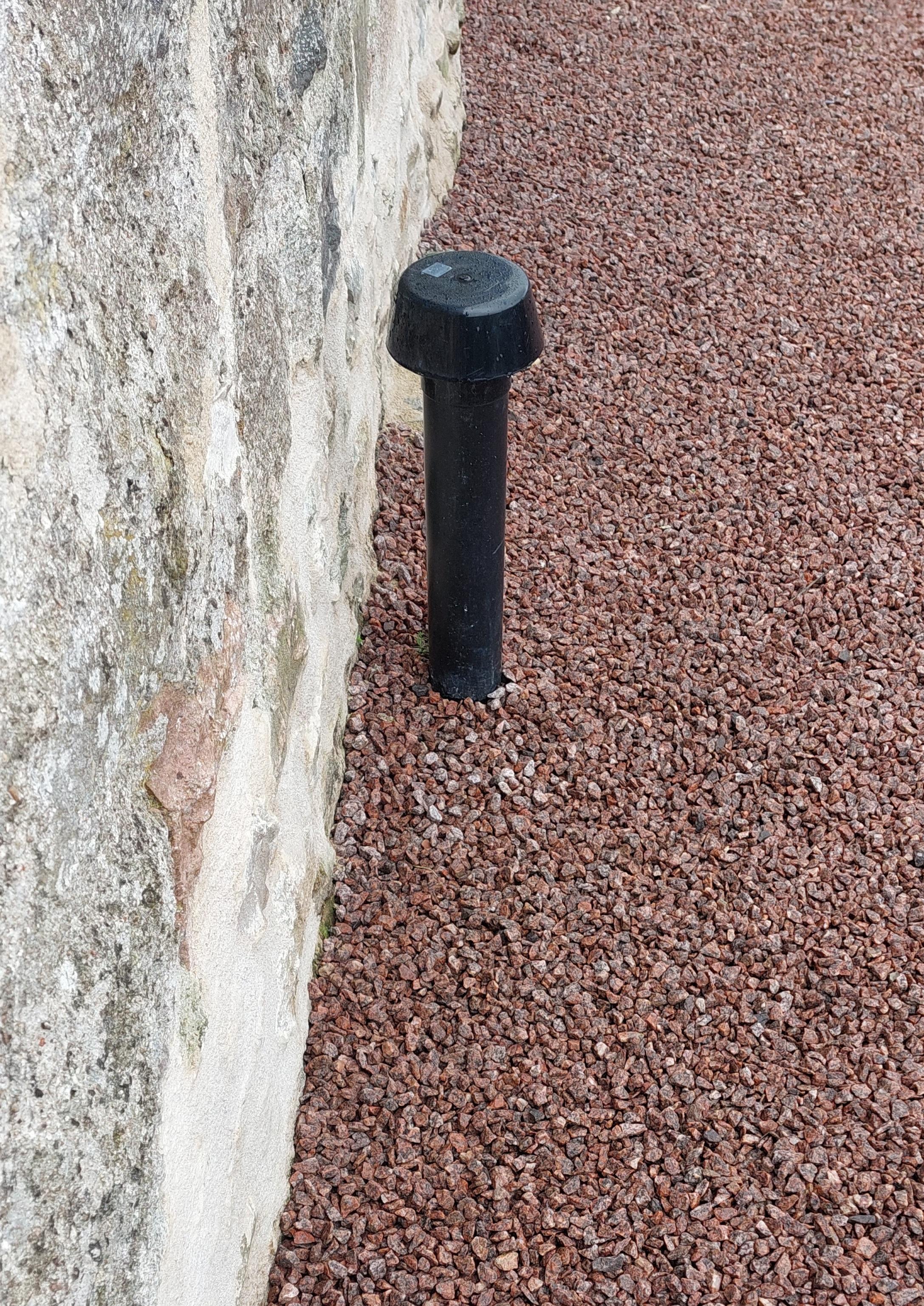

saveasteading Posted August 23, 2023 Share Posted August 23, 2023 Don't just tick the box. This is radioactive gas that could build up in your house. It is necessary that the gas exits the vent rather than sit in the pipes. A continuous pipe with 2 vents will create a draught. Any outlet to air will allow pressure release, and the idea is for the pipe to be an easier route than any gap in the membrane. To keep the rain out there are hoods, or put on a 90° bend. But if a little rain gets in it might escape from a perforated pipe if used to collect gas. 1 Link to comment Share on other sites More sharing options...
ToughButterCup Posted August 24, 2023 Author Share Posted August 24, 2023 On 22/08/2023 at 21:38, ProDave said: .... run the pipe underground horizontally with a slight fall and vent it out further down the slope,... Thats the best idea, I think. It exits the house under the foundation (1.5 m down) and i'm reluctant to dig that far. Since the gas is heavier than air, can I assume that its OK to expose the riser -say 300mm of it - put a 90 in, then a short traverse across the path and into a gabion wall .... ? With an appropriate rodent barrier. The thought of rats under the house floor .... I suppose I'd better check the radon sump first too - for all I know its full of water. Inspection camera's on the shelf in the container : hardly ever need it, but when ya do, ya do. Link to comment Share on other sites More sharing options...
saveasteading Posted August 24, 2023 Share Posted August 24, 2023 8 hours ago, ToughButterCup said: can I assume that its OK to expose the riser -say 300mm of it - put a 90 in, then a short traverse across the path and into a gabion wall .... ? Sounds OK. The gas would have reached your barrier under pressure. Once it reaches your vent system it will only fill it under more of the same, then flow or dribble out to free air. Can't you just bring it above ground and put a hat over it? Link to comment Share on other sites More sharing options...

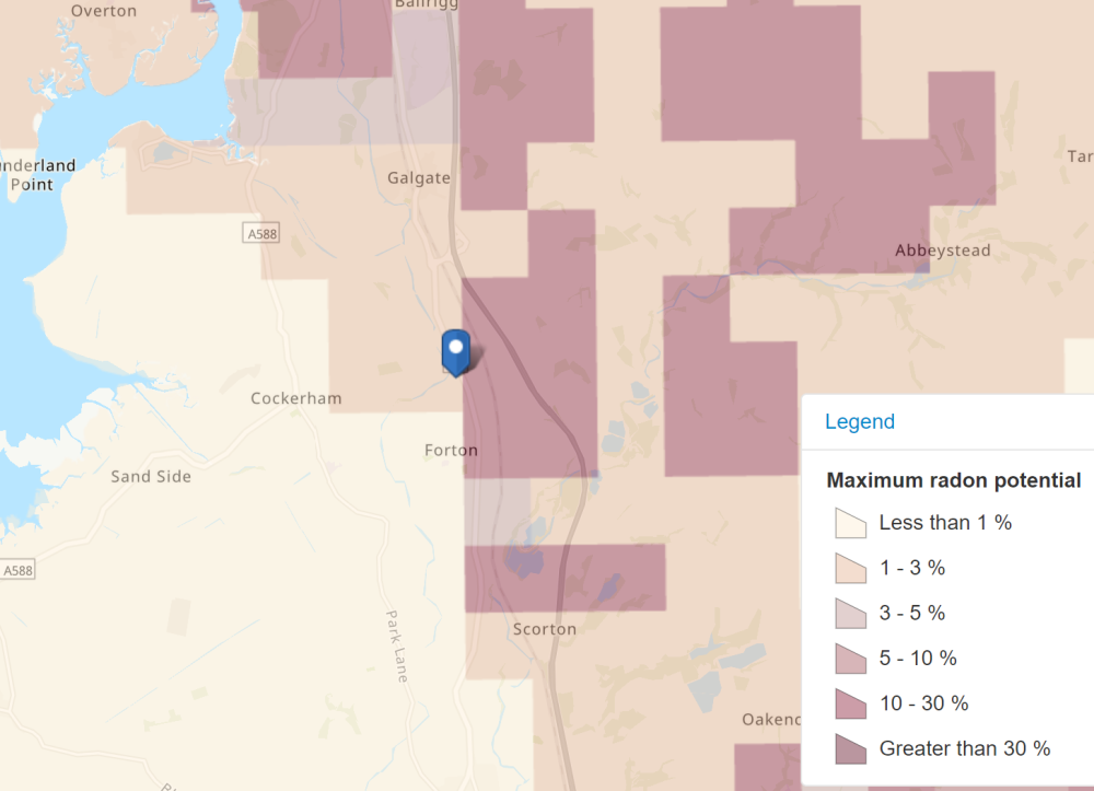

dpmiller Posted August 24, 2023 Share Posted August 24, 2023 What is the level of radon risk locally- do you actually need a vent or is a barrier actually sufficient? Link to comment Share on other sites More sharing options...

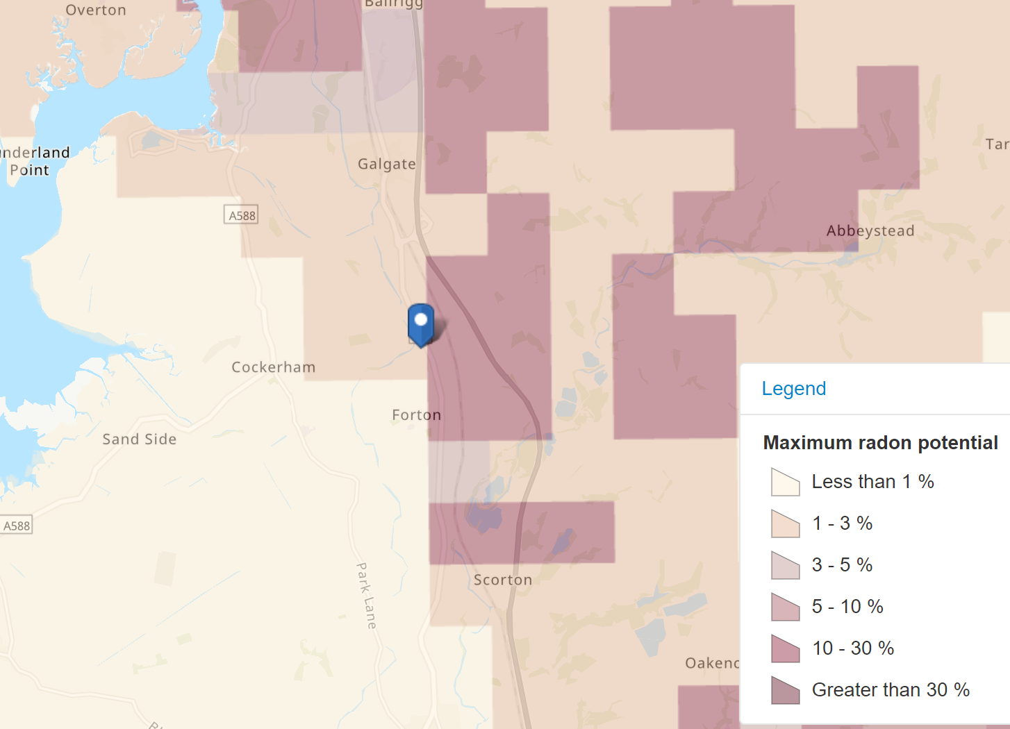

ToughButterCup Posted August 25, 2023 Author Share Posted August 25, 2023 (edited) 11 hours ago, dpmiller said: What is the level of radon risk locally- do you actually need a vent or is a barrier actually sufficient? I'm not sure . Our house falls only just within the one grid square on the edge of a bigger area on the Radon map I think that puts us in the 1 - 3% risk area. We have a barrier in place The risk appears to me to be minimal., therefore. Quite why we were required to have a sump in there as well, I really don't know.. I took the cap off the sump pipe yesterday. Full of water. So that means the sump is also full of water. That means pumping it - constantly. At least there's unlikely to be rats down there Stuff it. That's OFFICIAL Edited August 25, 2023 by ToughButterCup Link to comment Share on other sites More sharing options...
dpmiller Posted August 25, 2023 Share Posted August 25, 2023 We were/ are in the same situation Ian- bordering the 1% and 5% lines. Local BC made no requirement so we chose to just go with membrane- if anything *does* rise and escape it'll get blown away 2 Link to comment Share on other sites More sharing options...

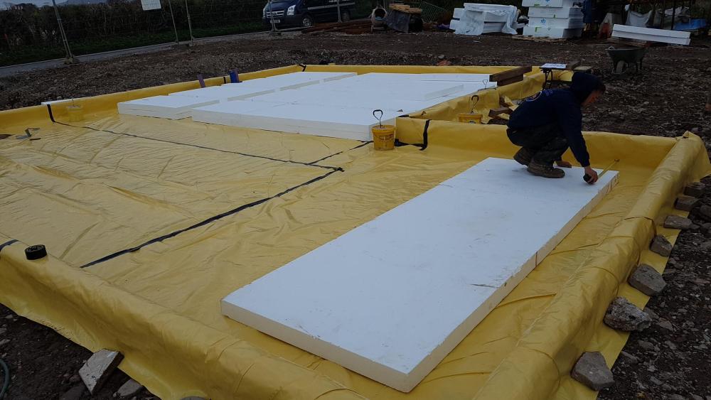

BotusBuild Posted August 25, 2023 Share Posted August 25, 2023 On 23/08/2023 at 17:16, saveasteading said: A continuous pipe with 2 vents will create a draught. and this is what we have put in. All blocked while still building - to be vented later. Link to comment Share on other sites More sharing options...

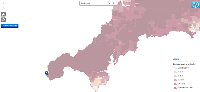

SteamyTea Posted August 26, 2023 Share Posted August 26, 2023 19 hours ago, ToughButterCup said: I think that puts us in the 1 - 3% risk area. 19 hours ago, dpmiller said: bordering the 1% and 5% lines. Pussies, we get the highest marks here. Link to comment Share on other sites More sharing options...
ToughButterCup Posted August 26, 2023 Author Share Posted August 26, 2023 Maybe that explains things..... Link to comment Share on other sites More sharing options...
SteamyTea Posted August 26, 2023 Share Posted August 26, 2023 (edited) 26 minutes ago, ToughButterCup said: Maybe that explains things..... Explains why building ventilation is important, but also must not be wasteful i.e. MVHR. Cornwall used to have extremely high incidences of lung cancer. This was put down to high levels of smoking. They dropped when buildings were retrofitted with radon control systems. Edited August 26, 2023 by SteamyTea Link to comment Share on other sites More sharing options...
