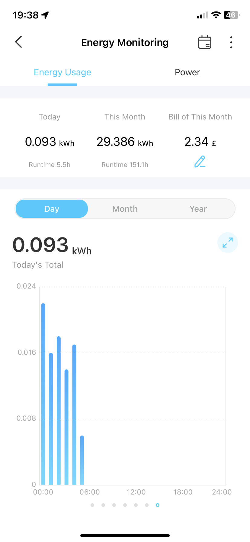

cwr Posted August 21, 2023 Posted August 21, 2023 Hi folks I am trying to find a simple (and cheap) way of logging how how much my oil boiler is on. I thought there might be some simple devices available (I've used Elitech for temp data logging, that sort of thing) but am struggling to find something that will record either voltage or current. I'm don't have the time right now to learn how to program the likes of arduino or raspberrypi's. Any suggestions? Thanks

cwr Posted September 15, 2023 Author Posted September 15, 2023 Thanks for all suggestions. I am now the proud owner of a Shelly 1PM. Up and running, it's a nice device, I can see me getting a few more for various other projects. The way it's wired in, both the pump and boiler are being monitored. I can't seem to get a good resolution on the data to differentiate between them, ie it just gives total power consumption for a period. Guess a little rewiring will be necessary unless there is a way to get it to record on a shorter time base? I've also noted that the on/off times are only displayed for the past day, are these stored and accessible somehow?
cwr Posted September 22, 2023 Author Posted September 22, 2023 Hi folks, anyone any idea on whether there is a way to download all of the on/off events? I can only find the past day's.
