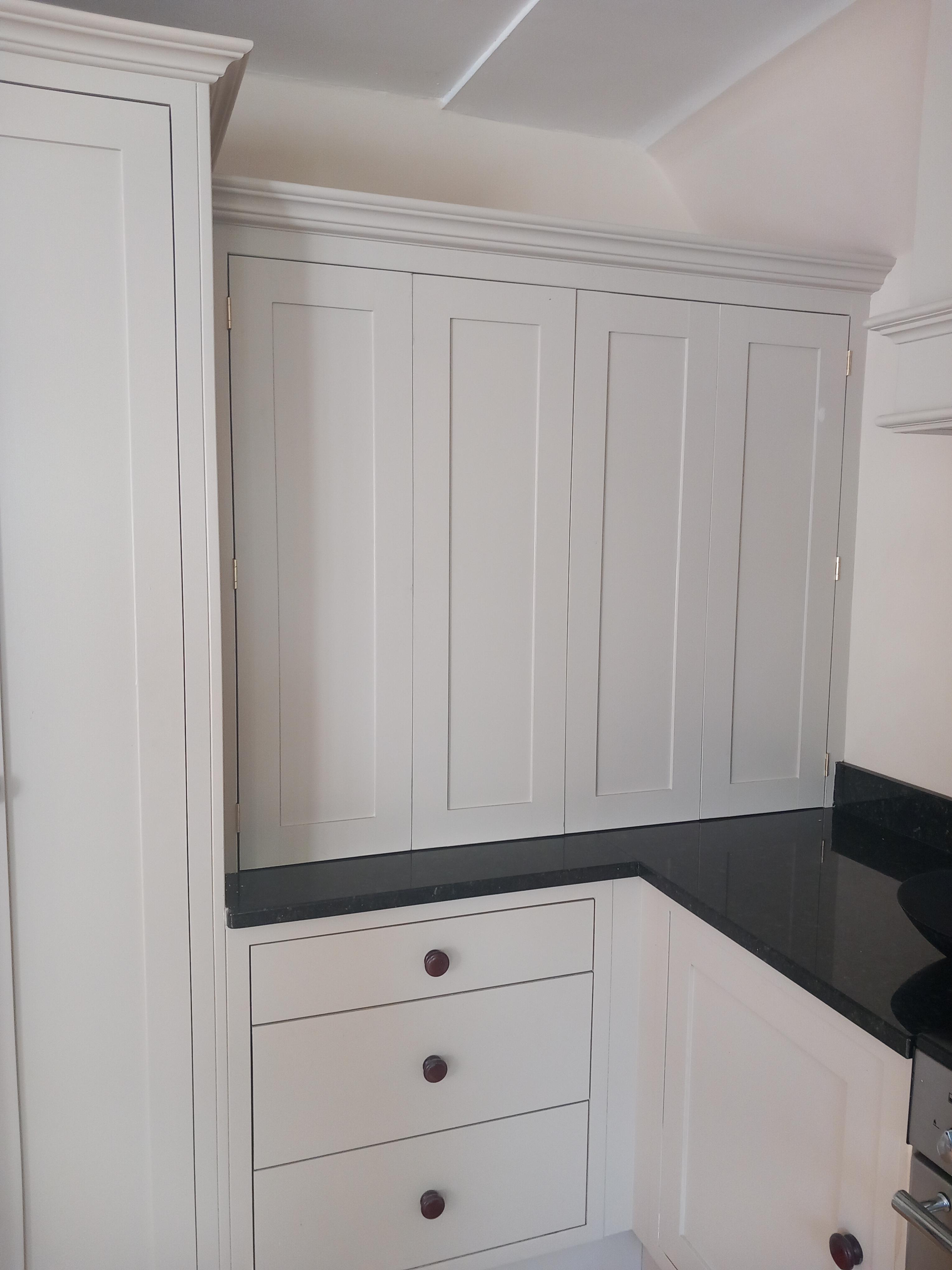

Dee Posted August 18, 2023 Posted August 18, 2023 (edited) Hi I've painted MDF kitchen cabinet doors that I've made but didn't realise they should be sealed prior! Ive painted using Farrow and ball eggshell and a basic undercoat. 12hrs later its still tacky. Can I seal retrospectively? Any advice?? Edited August 18, 2023 by Dee Additional info

Dee Posted August 19, 2023 Author Posted August 19, 2023 In the end I put the doors in the sun which helped to dry out more. Tge next day they were pretty dry, sanded down with 120 grit and just applied a second top coat. Will now wait 24hours before final coat....absolute pain and an email on its way to FB with feedback!! 1

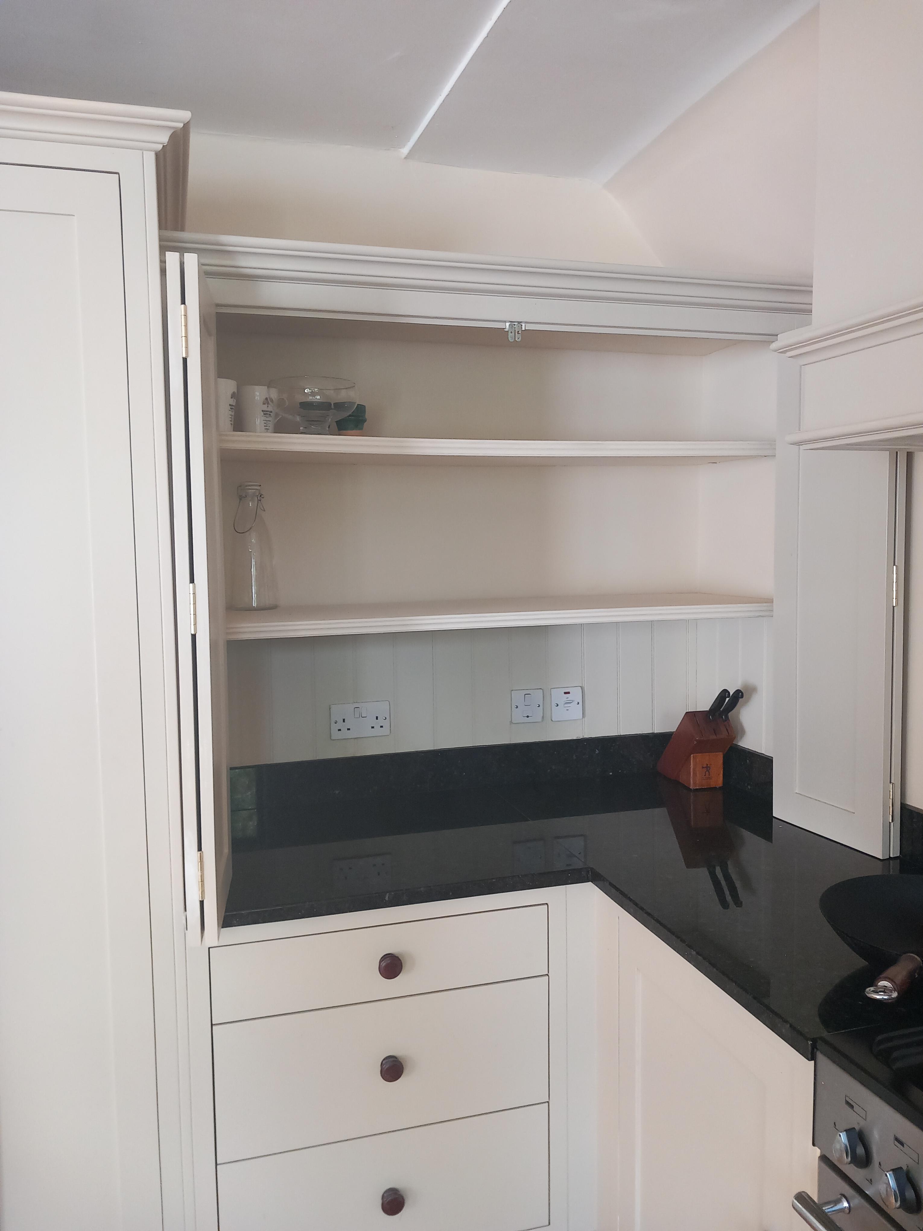

Dee Posted August 20, 2023 Author Posted August 20, 2023 Finished cupboard. Fairly happy with it but made soooo many mistakes, learned alot though.

Dee Posted August 21, 2023 Author Posted August 21, 2023 Dont over think...... Accept that as a DIYer with basic tools it'll not be perfect. Measure, measure and measure again. Be patient! Don't use Farrow an Ball Eggshell paint!! Seal the MDF....I forgot to. Don't use 6mm stripwood, too unstable, it warps and cups. Use 9mm mdf for the panel and 6mm for the rails ect to make 22mm'ish thick doors. Ideally have the rails ect machined if you don't have the capacity. Get an accurate level! 2
Dee Posted August 21, 2023 Author Posted August 21, 2023 Oh, and sand and seal the edges to within an inch of their lives
