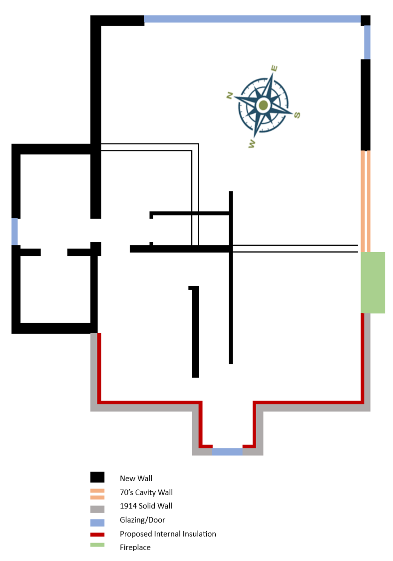

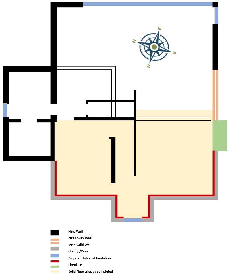

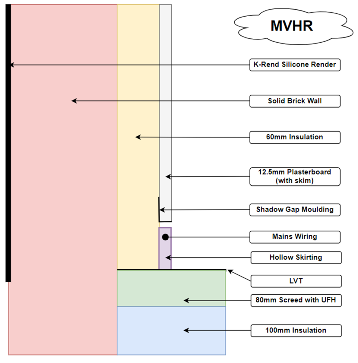

Tetrarch Posted August 7, 2023 Share Posted August 7, 2023 I'm not sure if this belongs here or somewhere else as there are Insulation, electrical, ventilation, aesthetic and other considerations all rolled in. Below is the layout (subject to planning approval). You'll note that only about 1/3 of the downstairs external wall length is actually solid/original so my concerns about damp/dewpoints etc are here. Upstairs will be like this: and this my idea to remedy the uninsulated original 1914 building: The UFH is already done. Everything else is up for grabs. Some explanations/justifications/concerns here: MVHR - To maintain humidity control without trickle vents or airbricks Silicone Render - Open to other ideas 60mm Insulation - Balance between insulation and aesthetics Shadow Gap - No regular doors downstairs - going for super minimal finish Mains Wiring - Is this allowed? Hollow Skirting - Where can I source this? LVT - Amtico Spacia - Me and Mrs Tet agree, so that's sorted Any thoughts/criticisms/recommendations very welcome Regards Tet PS There are a couple of other windows - those on the floorplan are the full-height openings/glazing Link to comment Share on other sites More sharing options...
SteamyTea Posted August 7, 2023 Share Posted August 7, 2023 With only 100mm of insulation under the UFH you are going to loose a lot of energy to the ground. Can you increase the wall insulation to compensate for it? We're is the vapour control layer? What is being done to improve airtightness? 1 Link to comment Share on other sites More sharing options...
Dave Jones Posted August 8, 2023 Share Posted August 8, 2023 100mm of celotex is definitely a good start, bump it to 150mm and you will be exceeding new build regs. 1 Link to comment Share on other sites More sharing options...

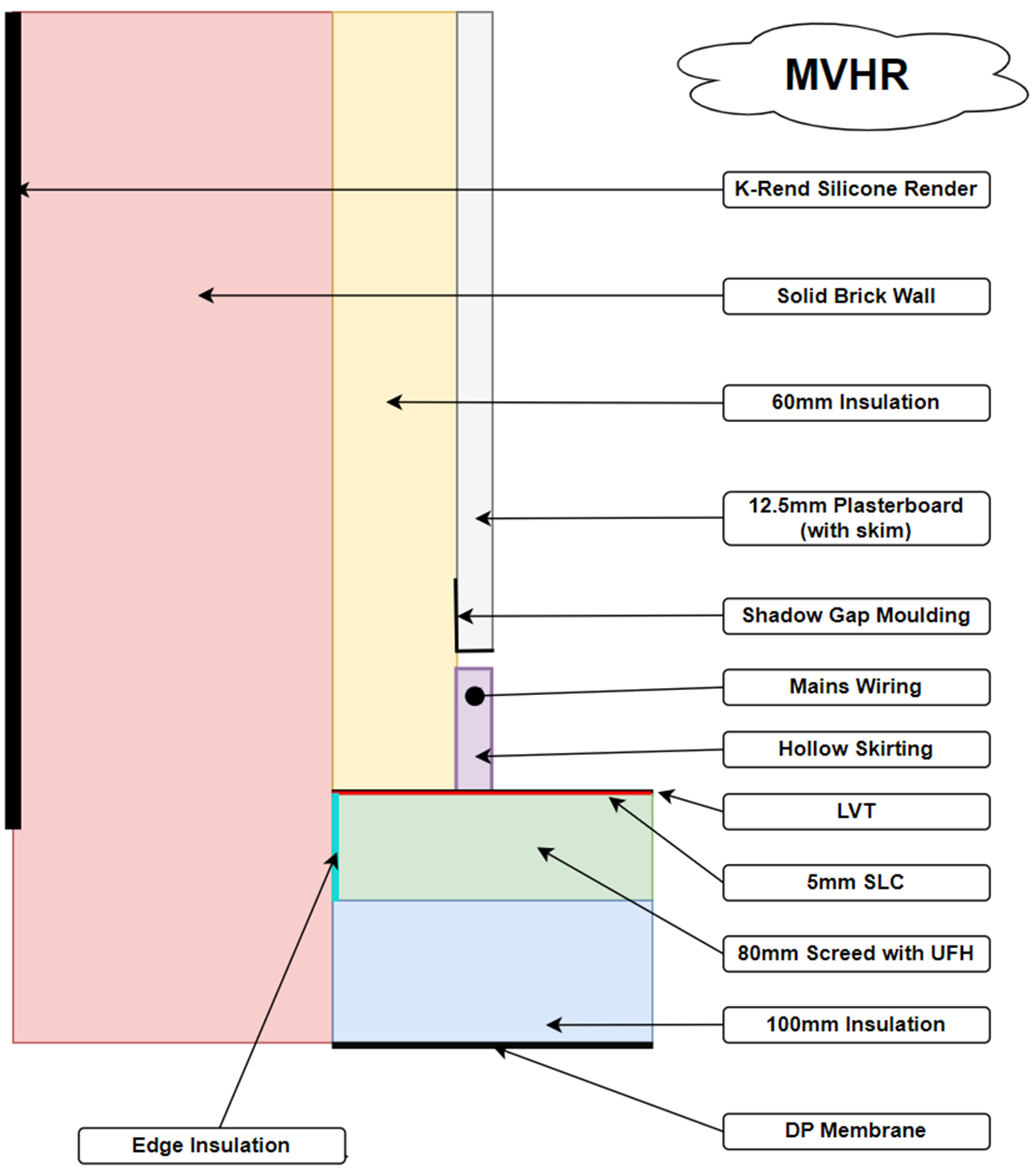

TonyT Posted August 8, 2023 Share Posted August 8, 2023 Edge insulation to stop cold bridging at the perimeter of the slab would be beneficial. Agree with Dave 150mm minimum pay for insulation once, pay for energy every month!! 1 Link to comment Share on other sites More sharing options...
Jenki Posted August 8, 2023 Share Posted August 8, 2023 No Solutions - just a few questions. How does the solid brick wall breathe ? The mains wiring is questionable. you will NEED to run vertically as well. 1 Link to comment Share on other sites More sharing options...

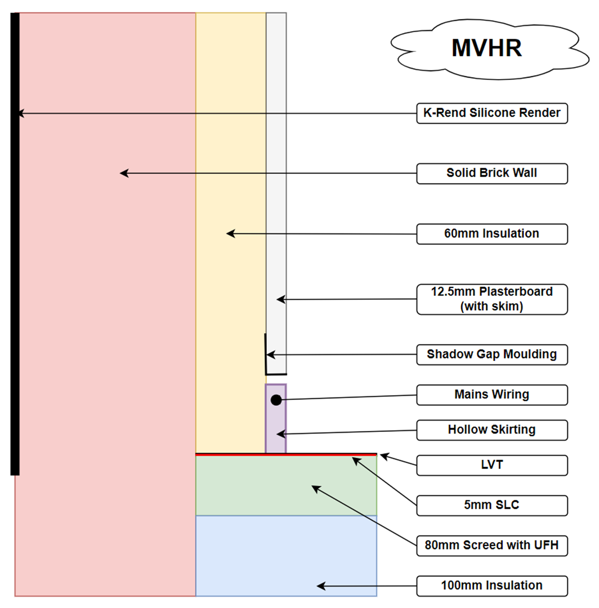

jayc89 Posted August 8, 2023 Share Posted August 8, 2023 There would be a thermal bridge at the wall/floor joint. The 60mm insulation should drop past the 80mm screed to be touching your 100mm floor insulation. (Called a perimeter upstand). Neither wall nor floor insulation is that great, I'd recommend going thicker whilst you're going to all this trouble. 150mm floor (just dig deeper?) and 100mm on the walls. You need to pay careful attention around things like floor joists, are they pocketed into the existing solid walls? If so they're a thermal bridge and at high risk of condensation and rotting. Best idea would be to remove them, insulate and refit the joists inside the new thermal envelope, this is a lot of work, so an alternative could be to repoint around the joist pockets in lime, to reduce any air leakage, and use a more breathable insulation within the floor void. For your services, do you have space to batten out the walls by 25mm to allow you to run wiring wherever you need? I did similar; adhered PIR to the walls, mechanically fix 25mm battens through the PIR into the wall, run services, plasterboard over. 1 Link to comment Share on other sites More sharing options...
Tetrarch Posted August 8, 2023 Author Share Posted August 8, 2023 Thank you so much for taking the time and trouble to reply. I have updated the images with some more detail/explanation below and will address comments/questions individually Link to comment Share on other sites More sharing options...
Tetrarch Posted August 8, 2023 Author Share Posted August 8, 2023 15 hours ago, SteamyTea said: With only 100mm of insulation under the UFH you are going to loose a lot of energy to the ground. Can you increase the wall insulation to compensate for it? We're is the vapour control layer? What is being done to improve airtightness? Underfloor Insulation - 100mm was to replace removed floor joists/floorboards. Definitely will insist on 150mm when digging out remainder of early 20th century and 1970 solid flooring - thank you VPC - diagram updated - apols Airtightedness - Not tested officially, but house seems relatively airtight. I will check this is as good as it can be as part of the MVHR install Regards Tet Link to comment Share on other sites More sharing options...
Tetrarch Posted August 8, 2023 Author Share Posted August 8, 2023 1 hour ago, Dave Jones said: 100mm of celotex is definitely a good start, bump it to 150mm and you will be exceeding new build regs. See above Link to comment Share on other sites More sharing options...
Tetrarch Posted August 8, 2023 Author Share Posted August 8, 2023 1 hour ago, TonyT said: Edge insulation to stop cold bridging at the perimeter of the slab would be beneficial. Agree with Dave 150mm minimum pay for insulation once, pay for energy every month!! Perimeter Upstand - There is a thin (10mm) blue insulation later between 80mm slab and solid wall. Diagram updated Link to comment Share on other sites More sharing options...
Tetrarch Posted August 8, 2023 Author Share Posted August 8, 2023 55 minutes ago, Jenki said: No Solutions - just a few questions. How does the solid brick wall breathe ? The mains wiring is questionable. you will NEED to run vertically as well. Solid Wall - Really good question......I was hoping to use the MVHR to control humidity/dew point. I've seen this on another thread on here - this post was really following up on that. Mains Wiring - The existing wiring ran under the floorboards. I have to either run mains wiring round the perimeter or drop down from the ceiling. My understanding is that if I use a purpose built aluminium channel as skirting board then that is allowable (unlike routing wooden skirting which is ostensibly not). There will of course be upwards tails to each of the sockets. I'm thinking of going "smart" so there may not be any lighting switches at all Link to comment Share on other sites More sharing options...
Tetrarch Posted August 8, 2023 Author Share Posted August 8, 2023 48 minutes ago, jayc89 said: There would be a thermal bridge at the wall/floor joint. The 60mm insulation should drop past the 80mm screed to be touching your 100mm floor insulation. (Called a perimeter upstand). Neither wall nor floor insulation is that great, I'd recommend going thicker whilst you're going to all this trouble. 150mm floor (just dig deeper?) and 100mm on the walls. You need to pay careful attention around things like floor joists, are they pocketed into the existing solid walls? If so they're a thermal bridge and at high risk of condensation and rotting. Best idea would be to remove them, insulate and refit the joists inside the new thermal envelope, this is a lot of work, so an alternative could be to repoint around the joist pockets in lime, to reduce any air leakage, and use a more breathable insulation within the floor void. For your services, do you have space to batten out the walls by 25mm to allow you to run wiring wherever you need? I did similar; adhered PIR to the walls, mechanically fix 25mm battens through the PIR into the wall, run services, plasterboard over. Wall Insulation - I'd agree that battening and/or 100mm wall insulaton would be best but this is really aesthetic with smallish windows to the original house that I can't change and the fireplace that I can recess a bit, but 100mm+ is just too much IMO. I can probably do 100mm on the upstairs North side as there are no windows on that aspect My general thoughts that if I go for high spec in the new parts ~(and a new roof) plus the MVHR that this will mitigate for my slightly sub-optimal efforts in the old part of the house Floor joists - Just an upstairs problem. Is this critical? There are no downstairs joists or voids Link to comment Share on other sites More sharing options...

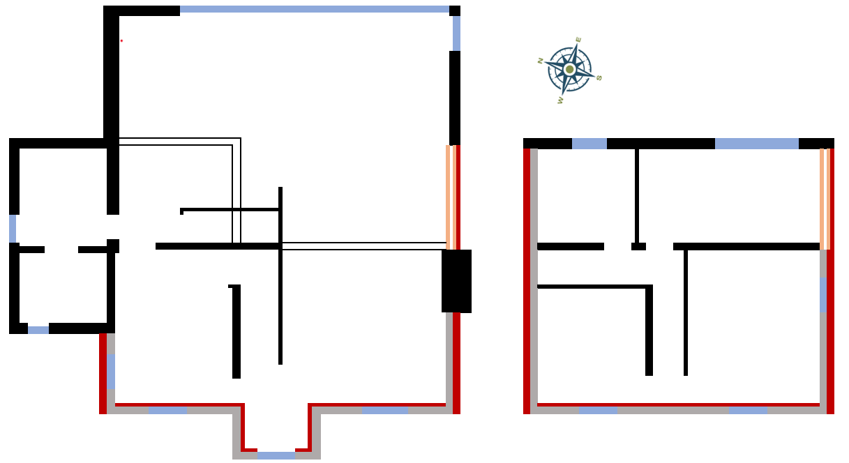

Tetrarch Posted November 27, 2023 Author Share Posted November 27, 2023 Update : Planning Permission granted so we start work in late February I will be submitting a minor planning amendment to cover the roof as well and the plan is to extend the roof slightly to deliver some broader eaves (more in line with current BR). My new insulation proposal is to have a hybrid mix of internal/external. Black is new 365mm walls Red is new insulation Orange is old 1970's cavity wall My master plan is to have the South walls (1914, 1972, 2024) lined up in such a way that the internal and external faces will be seamless and "un-stepped". This means using various thicknesses of external insulation and then K-Rendering the whole lot. The reason fo the internal imsulation on the front (West) is to preserve the aesthetic of the current sash windows My "new" question. Is it OK to just insulate and render on top of the existing painted roughcast finish? This finish is absolutely rock-hard and very difficult to remove even a small area. Regards Tet Link to comment Share on other sites More sharing options...
