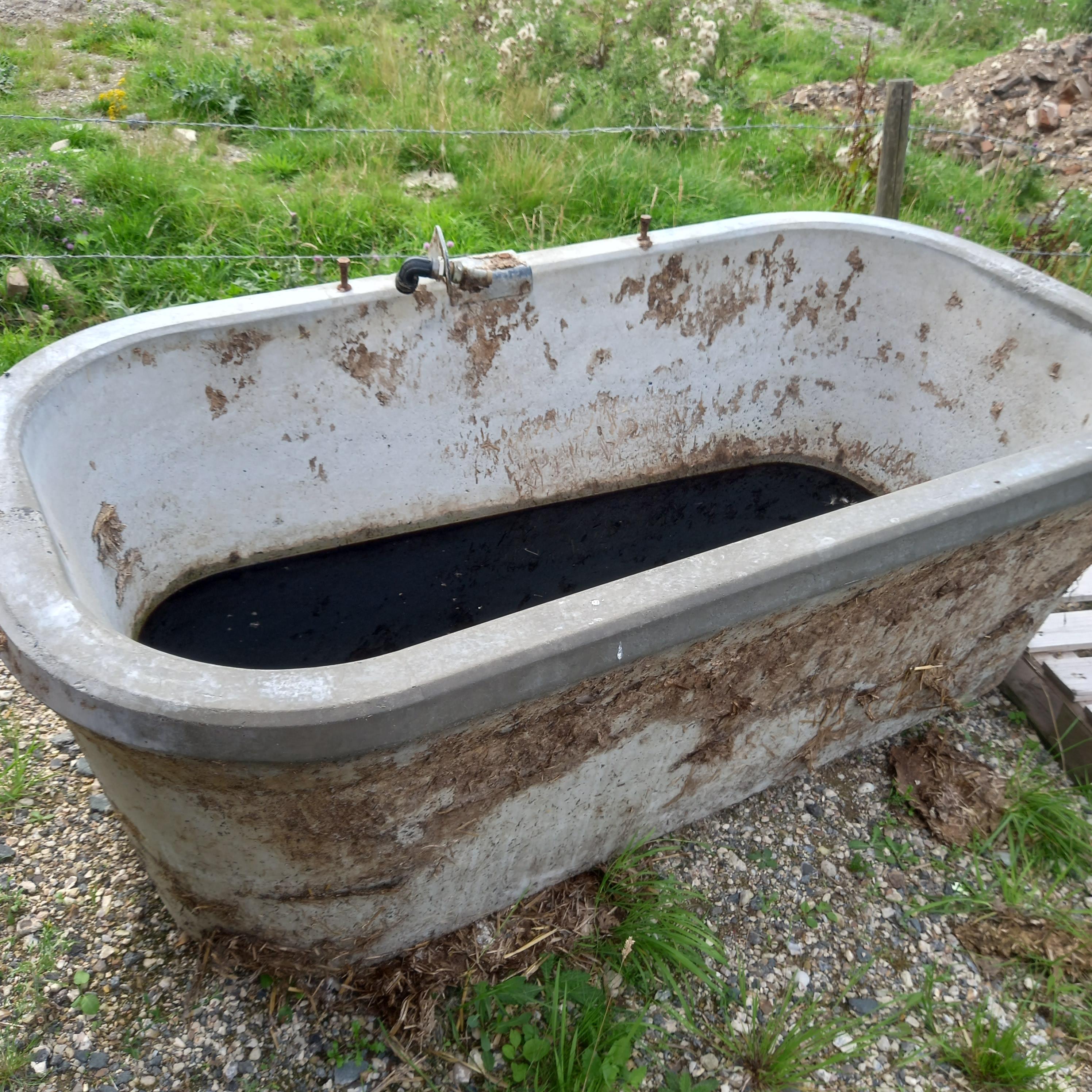

twice round the block Posted August 7, 2023 Share Posted August 7, 2023 You can have my stone bath for £100, no hairline cracks and it holds water. May need a quick clean Link to comment Share on other sites More sharing options...
