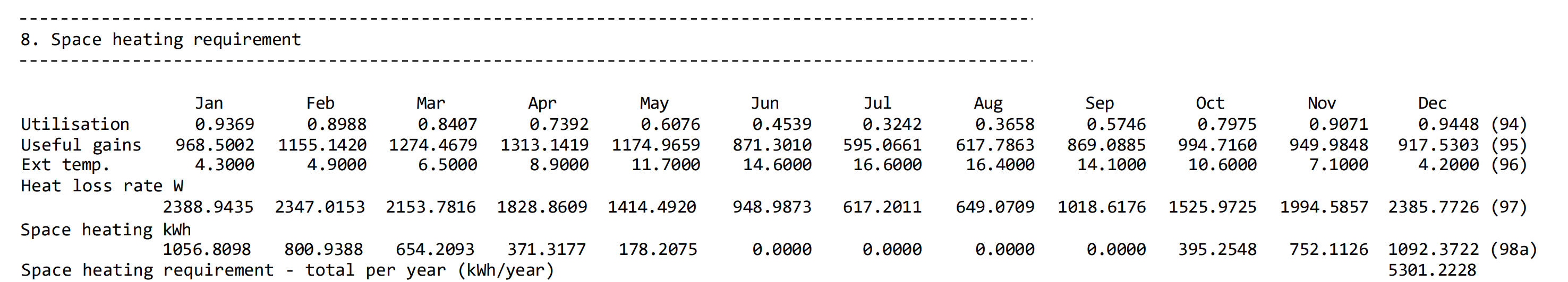

Attach it here and I'll highlight the areas you need to look at. They are quite simple to understand once you've seen one or two
Not the first SAP I've seen where they calculate the heat loss at un-realistic outside temperatures. I'd be happier if they used -2 or something instead of 4.3 degrees for January.
Anyway, you need around 2.4kW to heat this place when it's 4.3 degrees outside and you want 18 degrees inside.

Thanks Hugh
That section 8 is repeated, on page 3 it shows 26.5 W/m2 (99)
Then...
page 7   = 33
page 11  = 34.5
page 15  = 36.9
Etc
I am missing, and or, misunderstanding something in this.

Update to the apparently repeating listed 8 options within my 32 page report.
                                                                                                                    Ap50    space heating Kw          Kw/m2
  1. Emissions for regulation compliance                                               .3          5301                               26.5
  2. Target emissions                                                                          5                6617                               33
  3. Fabric energy efficiency                                                                   .3          6908                              34.5
  4. Target Fabric energy efficiency                                                   5               7372                               36.8
  5. Energy rating                                                                                      .3         4731                               23.6
  6. ECP costs, emissions & primary energy                                           .3         4532                              22.6
  7. Energy rating for improved dwelling                                                 .3         4730                              23.6
  8. EPC costs, emissions & primary energy for improved dwelling      .3         4532                              22.6
So the 'Target'  figures are, for some reason, the outliers.
