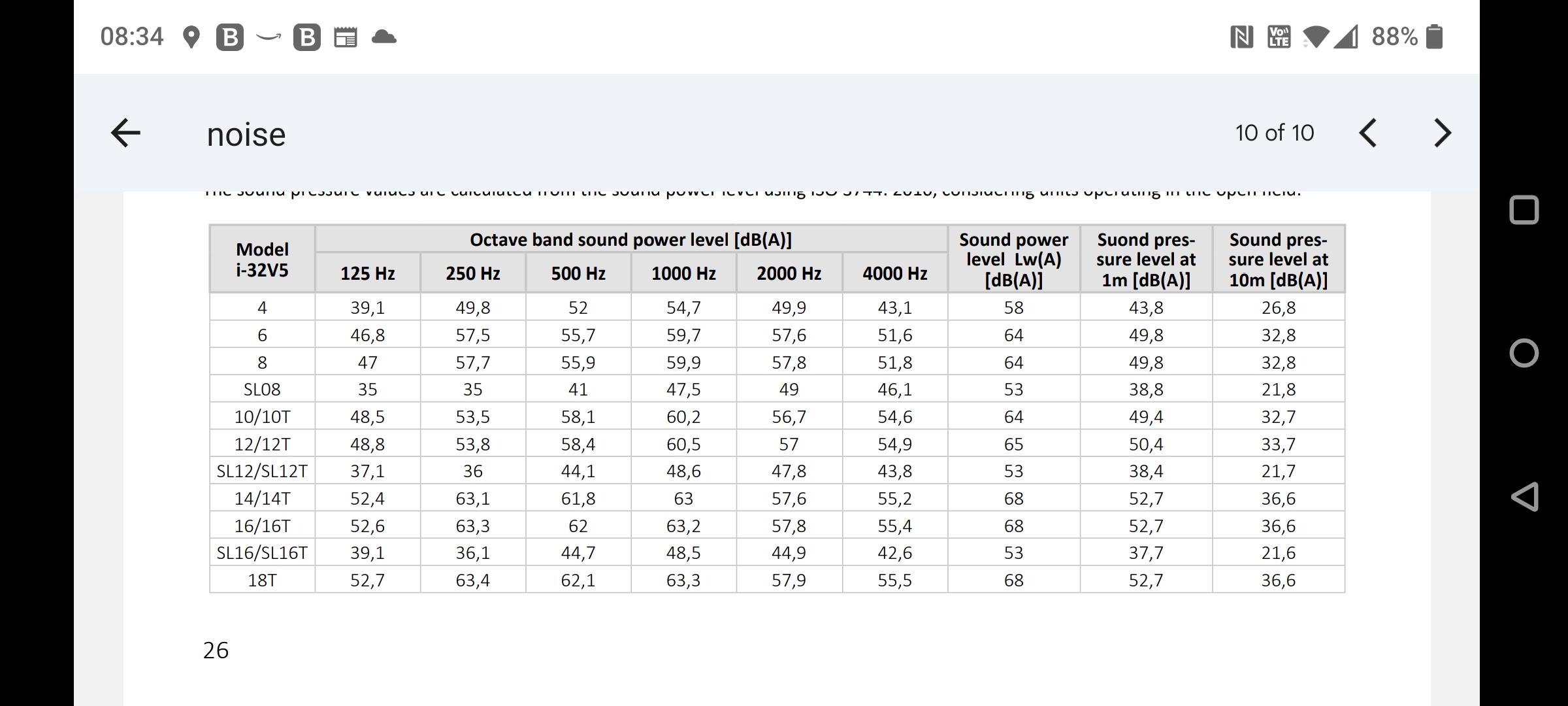

JamesPa Posted August 15, 2023 Posted August 15, 2023 9 hours ago, Post and beam said: sound power level (SWL) would be a maximum of 50dBA. 8 hours ago, JohnMo said: That is meaningless without a distance dimension. Not if it means what it says ie sound power level (as opposed to sound pressure level). The former is the total sound energy emitted from the unit and requires no distance. It's the starting point for a sound pressure level calculation. I think it probably does mean what it says because of the comment that follows.
JohnMo Posted August 15, 2023 Posted August 15, 2023 25 minutes ago, JamesPa said: Not if it means what it says ie sound power level (as opposed to sound pressure level) Shouldn't answer stuff latest night, you are correct Here is my heat pump sound data as a starter for 10.
