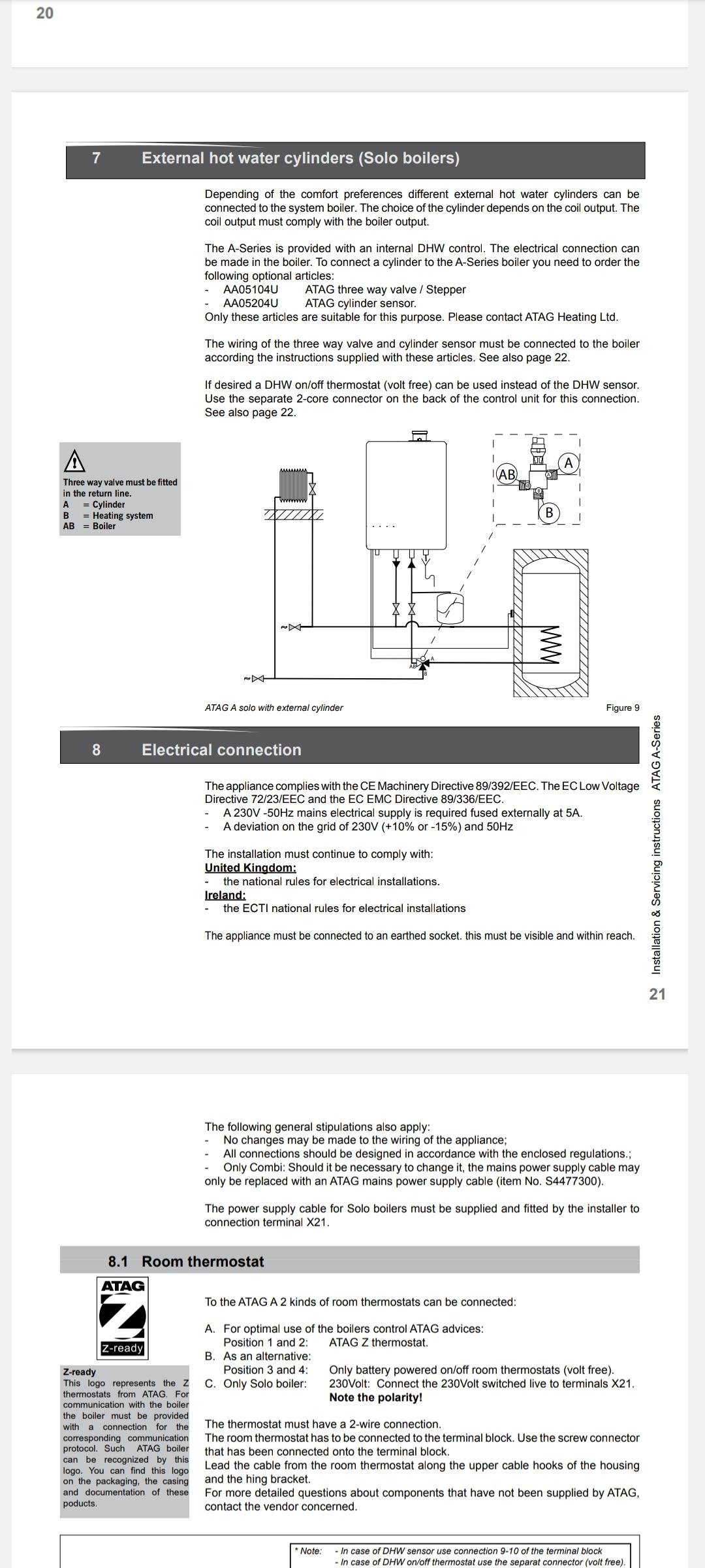

In my head I’m talking about x plan 2 temps one for heating one for recharging cylinder?
19 minutes ago, JohnMo said:
Have you pointed to the correct link, that's about priory hot water, instead of S and Y which I also think should be banned.
Opentherm is a different subject again.
W plan is just really a 3 way diverter, instead of mid point valve - X plan gives you two distinct flow temps. One can be weather compensated normally.
Can you post a system diagram of "X plan"?
As far as I can tell there really isn't any actual difference between S,Y,W or X
In essence all of them take the pumped flow through the heat generator and direct it between the cylinder and central heating zone(s)
S uses 2port valves on a T (or manifold)
Y uses a 3 port valve with a mid-position actuator
W uses a 3 port valve with a 2 position actuator.
The major difference between them seems.to be in the wiring of the various valves to each other to "hard wire" the logic
But from a plumbing perspective there is very little difference, an S or Y plan could be made to function exactly like a W plan by controling the valves with a microcontroller rather than thermostats and timers closing circuits.
The only problem might be if you have a very complex system. My parents have a horrendous system where multiple zones are actuated by the thermostat closing a contact that motors a 2port zone valve, then a microswitch in the actuator closes a circuit that power the pump (as far as I can tell directly) and commands the boiler to fire. It's a nightmare to trouble shoot with wires going every which way and multiple points of failure.
Here is a snippet out of my Atag gas boiler manual. This is X plan. 3 way wired back to the boiler, the boiler then knows what temp it fires at. ASHP are the same configuration X plan.
So basically using some actual logic (probably microprocessor based) to provide 2 "setpoints" or modes for the boiler to control it's temperature to.
As i said, the old way of doing things was just dumb hardwiring of dumb components together that had developed over the decades as more.functions were added and had to be backwards compatible.
Yeah, that crap should be ditched. All you need is a 3 port or (possibly more flexible) 2 X 2port valves (s plan) winter directly to the controler and the system works out what flow temp it should be outputting and which valves should be open or closed.
