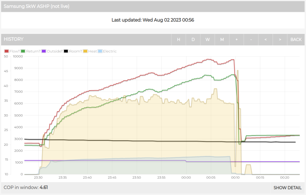

I get the point but a 16kw r32 HP has a minimum output of 6kw at 65C water temp. 16kw should be enough for most properties
From the cylinder's point of view, all it knows is that it's connected to a 65C flow source and will extract the same heat. If anything, it will extract more with a HP as the return temp is lower thus the average coil temp is higher.(65/58 Vs 65/45)
6kw is well below the output of any gas boiler so any coil that works with a gas boiler, IE can dump enough heat to stop the boiler cycling, should be fine with a HP.
The only thing I can think that might cause a problem is the follow through the coil being higher if the resistance is to much. But 22mm copper should be big enough and I can't imagine anyone using 15mm feeds for the coil in a large house.
With old r410a pumps limited to lower temps, so I get the issue.
But r32 and r290 especially can replicate the flow temps of a gas boiler.
The could even do a legionella cycle and do away with the immersion heater. That would mean there is no possibility of the cylinder boiling. That works mean we won't need expensive g3 cylinders, installer ticket or annual checks.

Let's look at a modest (7 kW nameplate; 8.6 kW at 45C flow temp at design condition) heat pump with the wick turned down to minimum (2.4 kW at current ambients) delivering DHW to a very modest 45C target in a cylinder with a hulking great big coil. (Vaillant's largest heat pump cylinder IIRC)
https://emoncms.org/app/view?name=Primary&readkey=eec7334e58f2a6927a9ff7b27c8c7e63
Coil runs at 52.5 / 46.5 C (mean temp 49.5C) for water at a nominal temp of 45C. 2.4 kW.
Call it 5C dT on the coil and 5C to the water for arguments sake.
Bump that to your 50C setpoint. Heat pump 57.5/52.5 and 2.4 kW.
Bump that to 4.8 kW. That's still lower than the largest of heat pumps but not out the question as a minimum for a 10-12 kW unit.
