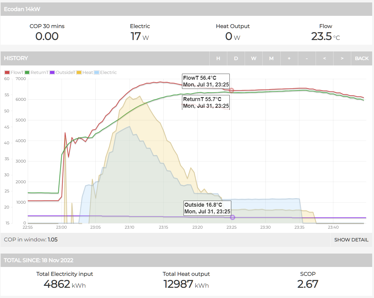

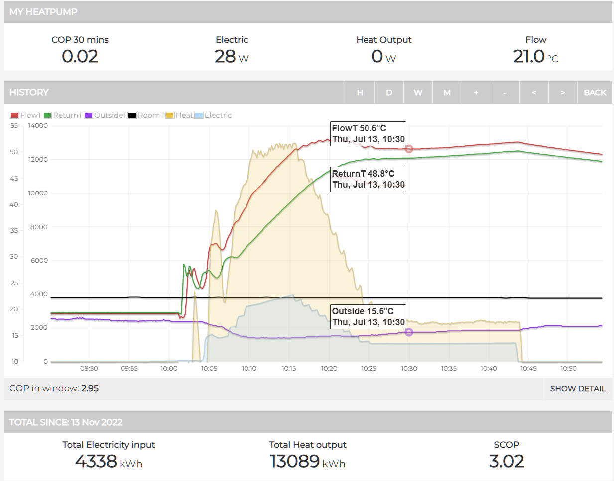

DanDee Posted August 2, 2023 Share Posted August 2, 2023 (edited) 14 hours ago, JohnMo said: All the above is great in theory, but the ASHP doesn't put out a set temp all the time, it slowly ramps up as the graph above illustrated. It has taken 40+ mins to get to 52 degs flow temp. Not sure how your small coil manages the heat transfer at the lower flow temp. The dT would too low the ASHP would ramp up temperature quickly and basically run out of temperature rise to manage dT and leave you with a slightly warmer cylinder, not hot or usable. It would then just continue to short cycle never achieving set point. No cycling in DHW, just poor performance. If it's not the low COP that would drive you crazy, the reheat time will do for sure with a minuscule coil. https://emoncms.org/app/view?name=HighbanksASHP&readkey=a6242a5576f8fa23493b70dad6c7d9fe https://emoncms.org/app/view?name=MyHeatpump&readkey=23437bdf4c5212a780f9bcf6f03cc688 Edited August 2, 2023 by DanDee 1 Link to comment Share on other sites More sharing options...

JohnMo Posted August 2, 2023 Share Posted August 2, 2023 47 minutes ago, DanDee said: No cycling in DHW, just poor performance. My heat pump doesn't run like that one does, it wouldn't tolerate the small dT. Link to comment Share on other sites More sharing options...
