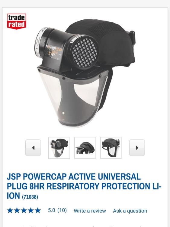

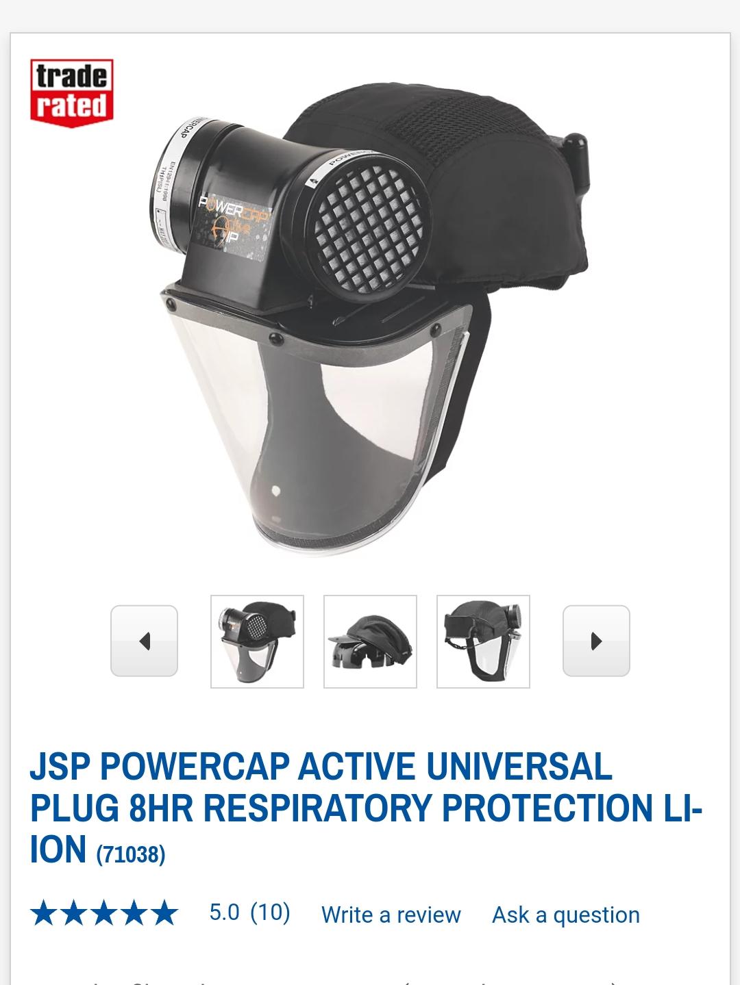

Iceverge Posted July 29, 2023 Posted July 29, 2023 Has anyone tried one of the fan assisted ones. I like the idea as they might actually be comfortable and shouldn't fog up. a bit Dear Mind you at £336
TonyT Posted July 29, 2023 Posted July 29, 2023 I have these at work for my joiner when on the saw ripping wood, sweats like a sweaty thing!! Then takes them off when I leave. I recently did some work in my loft and set up a decent workshop hepa filter hoover. no black snot, no sweaty head success. And you get to use it as a workshop-garage-car hoover afterwards so more than one use

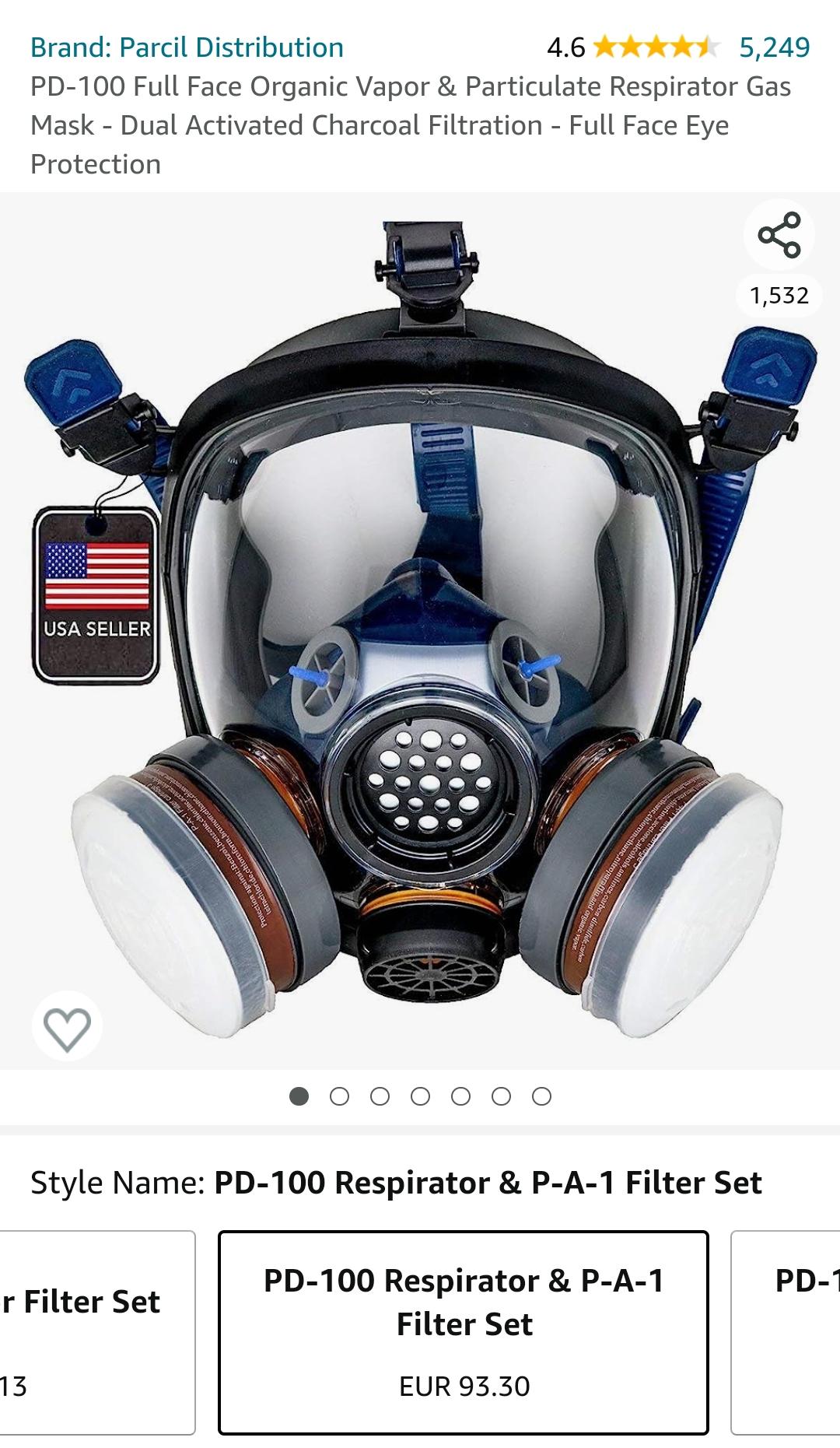

Iceverge Posted July 29, 2023 Posted July 29, 2023 This is what I use. It's the only protection I have ever had that properly seals around your eyes but doesn't fog up. 5 mins is plenty though. The thought of wearing it whilst insulating as attic fills me with dread.
Rob99 Posted July 29, 2023 Author Posted July 29, 2023 1 hour ago, Mattg4321 said: Also paper suit and gloves would help. Good shout, hadn't thought of disposable suit. Also means I can wear as few clothes as possible as I'm going to be sweaty mcsweaty face up there anyway! 1 hour ago, gaz_moose said: One with eye protection would be best but you will be boiling hot so it will just steam up I did think about that, the JSP Force 10 one is full face but I wear glasses and even using safety goggles is a pain. I might still look at one though as I'll be in the loft quite some time over several days

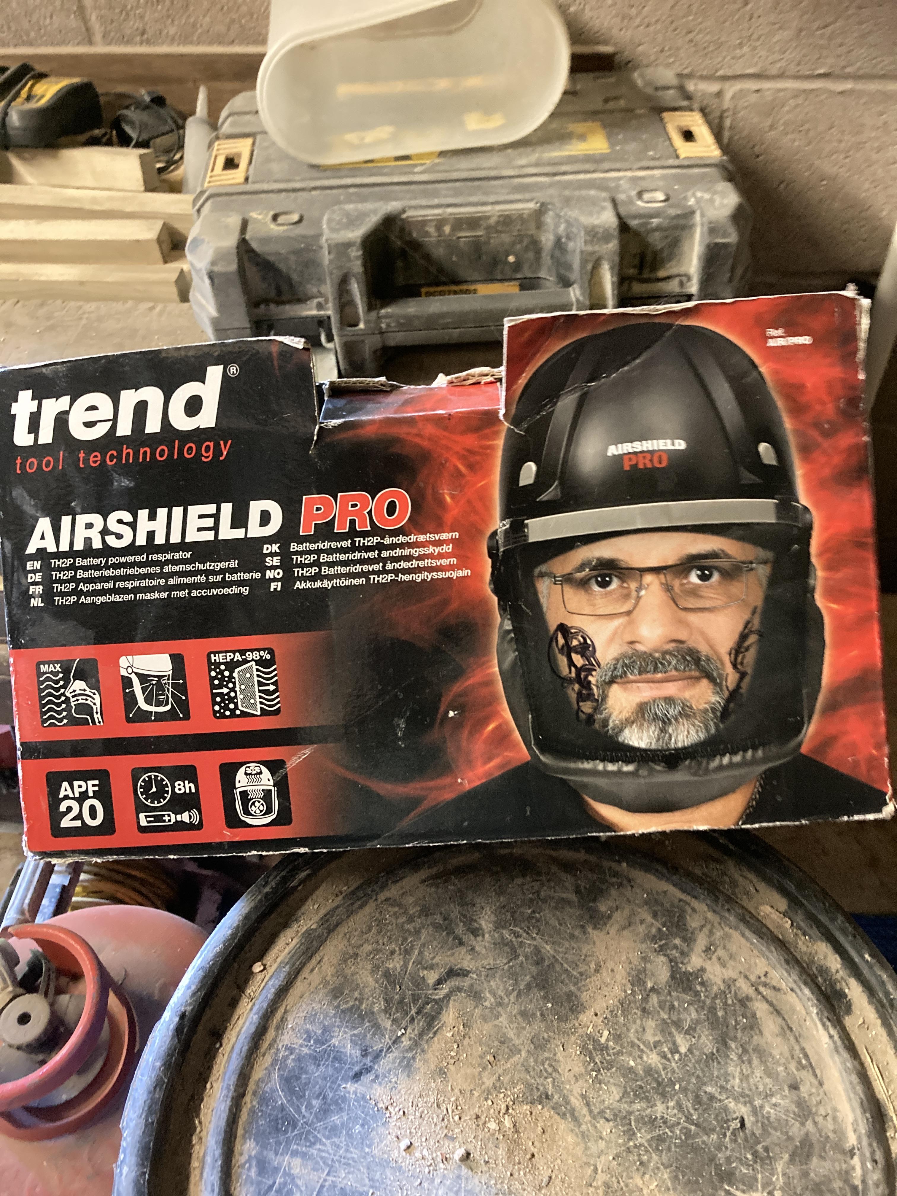

nod Posted July 29, 2023 Posted July 29, 2023 I have several of the Trend battery powered helmets Couple of hundred quid but work well for insulating They are supposed to be good for anyone wearing glasses also

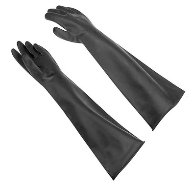

Mike Posted July 29, 2023 Posted July 29, 2023 For removal I use a 3M 6300 half mask + goggles + elbow-length heavy gloves + paper suit. I'd probably upgrade to a battery-power mask if I had a lot to remove, and I'd buy 3M - their filters have been reliably available for years, unlike some others I've had in the past. For new, I now choose something that's much more installer friendly - recycled plastic insulation on the last job, and a hemp-based insulation on the current one (though not sure if that's on the UK market).
