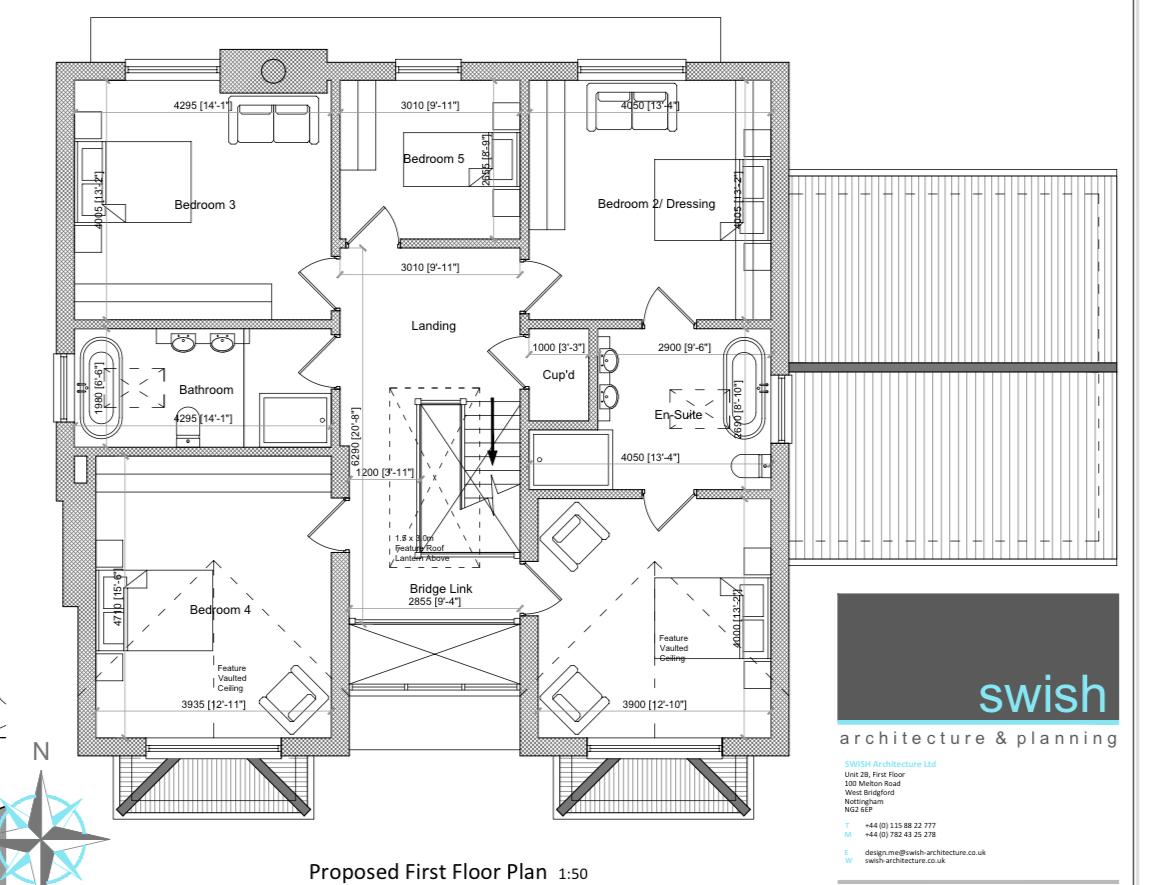

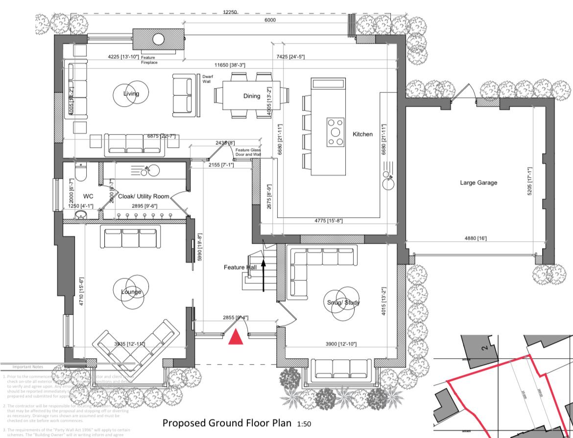

richo106 Posted July 25, 2023 Posted July 25, 2023 Hi All I am just starting my first fix, my house will be 250m2 (125 per floor) and mainly block inner wall construction. We can only get sky/bt broadband (60mb) via telegraph pole in our area. I am planning on installing 2 Ethernet ports in each bedroom, and behind the TVs in the kitchen and lounge. I will also be installing 6 x PoE cameras. My plan was to install a network cab with 24 patch panel and Poe network switch (any recommendations would be good) this cab will house the sky wi-fi router and bt master socket, I am running a cat 6 cable from where the cable comes to the house so they can connect onto that. Cab located in first floor cupboard My other concern is wi-fi coverage, I looked at the ubiquiti ap but was concerned about how they look dotted on the ceilings. Is there any other WiFi mesh/boosters available or are ubiquiti ceiling mount ap’s the best? Do these just plug into my network switch? any advice or ways to achieve what I want would be very much appreciated. I have attached my floor plans for info Many Thanks

Andehh Posted July 26, 2023 Posted July 26, 2023 (edited) I went with 2 Cat6a per TV point, then in lounge 2 behind TV and 4 in the corner of the room and a duct between corner and TV. AV kit sits in corner of room, with wall mounted TV neatly on the wall! Also did 2 per bedroom TV, 2 for kitchen TV, 2 on kitchen counter, 4 per study, 2 per garage, 2 per CCTV point. Also 2 in garden for possible garden room in future (duct under Patio) and 2 front of house in case of electric gates. Working my way through the networking installation atm... I'll post up pics later! Edited July 26, 2023 by Andehh

richo106 Posted July 26, 2023 Author Posted July 26, 2023 5 minutes ago, crispy_wafer said: I'm more worried about TV tbh, the old internet isn't too good here, we do manage with IPTV on a few devices. But would like to provision for either Sat or Aerial, I just cant decide... This is another issue I am thinking about to, I wasn't planning on installing an aerial to be honest (as my 2 gable ends are vaulted ceilings so couldn't put aerial in loft like in my other house). My plan was to have sky glass with additional pucks for the other tvs
richo106 Posted July 26, 2023 Author Posted July 26, 2023 7 minutes ago, crispy_wafer said: I'm going what seems mad with CAT6, 4 in the lounge behind the TV (pretty much a fixed location due to a glazed wall on one side, and log burner on another wall), 2 in the plant room, two in the kitchen near the consumer unit, 2 in hallway, 4 in downstairs bedroom, 2 in diff corners. Upstairs 4 in each bedroom (different corners again), two in the loft just in case... + a couple located for Wireless AP's It might seem mad, but imagine how mad you would be if you needed another CAT6 and you didn't install one when it was easy to 1

richo106 Posted July 26, 2023 Author Posted July 26, 2023 (edited) I have been looking into Ubiquiti and have been recommended these: https://www.4gon.co.uk/ubiquiti-unifi-uap-ac-pro-indoor-outdoor-access-point-uapacpro-p-6638.html If i put one on the ground floor and one on the first floor in a central location...would this be sufficient in peoples opinions? I have tried to find details on range/coverage etc and it says 122m...that seems a lot (to me anyway) Edited July 26, 2023 by richo106
richo106 Posted July 26, 2023 Author Posted July 26, 2023 I have also been recommended this PoE network switch https://www.4gon.co.uk/ubiquiti-unifi-24-port-poe-pro-switch-uswpro24poe-p-8532.html It seems quite expensive, is this worth the extra money? What are the benefits? Can i use Ubiquiti AP's with any PoE switch? Many Thanks
crispy_wafer Posted July 26, 2023 Posted July 26, 2023 (edited) Have a play with this, map out your floorplan and place the AP's to work out best location for coverage. UniFi Design Center (ui.com) 27 minutes ago, richo106 said: Can i use Ubiquiti AP's with any PoE switch? I use Aruba POE switches with Ubiquiti AP's at work, so I'd say yes, but that buying decision is mine and its company money, buying privately and advising over the internet, I'd advise to double check the POE requirements for the AP against the switch you are going to purchase. Edited July 26, 2023 by crispy_wafer
