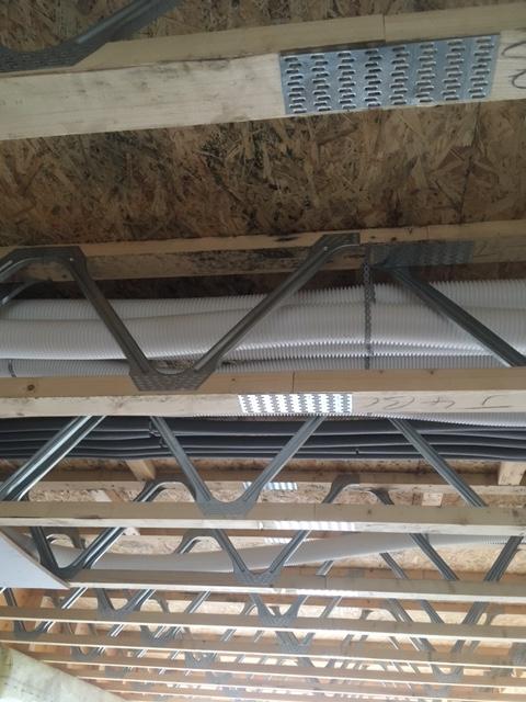

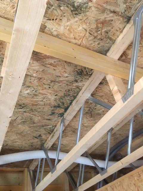

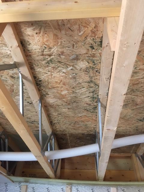

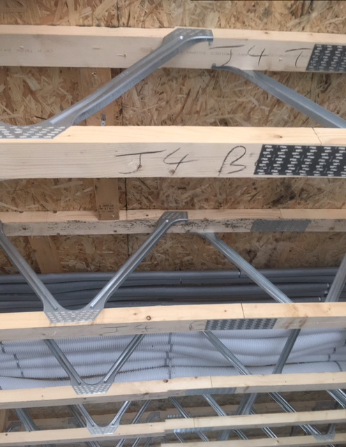

lizzie Posted August 20, 2017 Posted August 20, 2017 Hi all be grateful for some help on a worrying (to me) scenario that has developed on our mbc frame in the last few days. Lots of rain and the building is not watertight, the roof boards leak like a sieve even with a membrane. We are going as fast as we can with trusses to get it ready for single ply membrane finish. The mbc roof boarding is really wet in places and so are the joists underneath. The walls are wet but too a lesser degree. We have puddles all over the place inside with water collection in dips in the slab so its a very warm moist atmosphere due to window openings being covered in heavy duty polythene awaiting window arrival. Yesteday I notice what appears to be black mould spots on the roof boards and the joists. Can anyone tell me if this is an issue both for construction and health. I have a serious health issue and cannot tolerate any mould whatsoever, part of the reason for the build was to have a clean air healthy house and now I have seen the mould I am very worried and in something of a panic. Pics attached. All input gratefully received. Many thanks Liz
dpmiller Posted August 20, 2017 Posted August 20, 2017 Is there a problem with the picture (stitched?), or do the last three posijoists in the bottom pic have a break in them towards the middle of the image?
lizzie Posted August 20, 2017 Author Posted August 20, 2017 2 minutes ago, dpmiller said: Is there a problem with the picture (stitched?), or do the last three posijoists in the bottom pic have a break in them towards the middle of the image? I think it must be something with the photo I dont recall seeing anything like that on site. Well spotted!
Barney12 Posted August 20, 2017 Posted August 20, 2017 Hi Liz Don't panic. Our MBC frame got drenched for weeks during and after installation, it's rains up here like knowhere ive ever seen (well apart from the Western Isles of Scotland!). Pools of water everywhere (our slab too is far from level). As you say the roofing membrane doesn't keep the water out. Flooring was completely soaked. It will dry dry out relatively quickly once you're watertigh and you're problably going to need a mild bleach solution to wash away that surface mould. The only damage we have as a result of the water is all the floorboard edges have swelled. When the time comes I'm going to have to hit the floor deck with 40g on a belt sander but when I think just how drenched it was that's not any great hardship. Oh oh and if you read through the archives you'll see that I didn't want to build in the winter to stop this very issue. British summertime!! yeh right!! 1

Mr Punter Posted August 20, 2017 Posted August 20, 2017 It is not ideal but will not be an issue as it is short term. Sweep out any big puddles on the floors. Try to get the roof on ASAP.
Jeremy Harris Posted August 20, 2017 Posted August 20, 2017 Our MBC frame also got thoroughly drenched, as we had a day of very heavy rain whilst the frame went up. No significant impact, other than some discolouration and a little bit of minor swelling of the OSB flooring at the joints when it dried out. The latter was easily sanded out, and there was no long term damage. I think it's just one of those hassles of trying to build in the UK - the chances are it will rain a lot at some point before you get the roof on............
