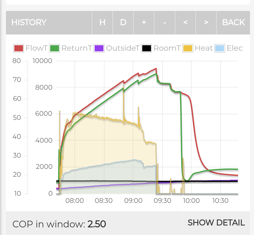

Beelbeebub Posted August 6, 2023 Author Share Posted August 6, 2023 Just on the topic of HP's and undersized cylinder coils. Came across this plot of an Arotherm+ (r290) system. It's doing a legionella cycle and the outside air temp is 10-15C over the cycle. As you can see it tops out at 75C where the CoP is a little under 2. At this point it's about on parity with a gas boiler for primary energy (gas burned) efficency. But running at 65C the CoP is 2.4, very much ahead of a gas boiler. Clearly this is a well set up system and the cylinder probably a fairly big coil. But if we had a smaller coil and had to run at high temps throughout the cycle it would be possible. Link to comment Share on other sites More sharing options...

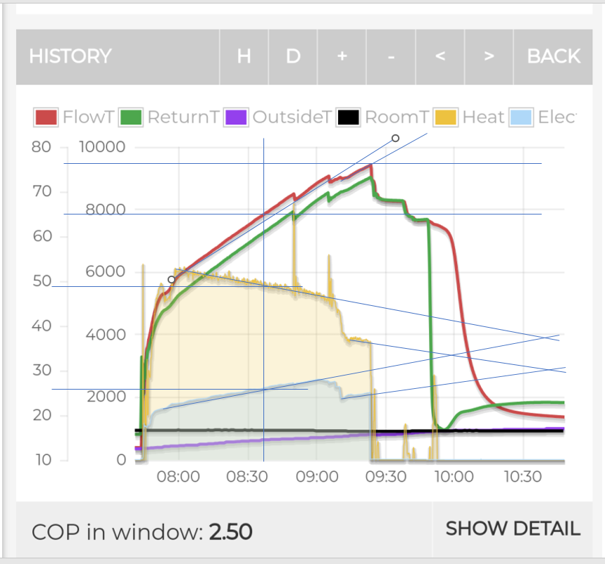

MikeSharp01 Posted August 6, 2023 Share Posted August 6, 2023 That's interesting data. I am curious about the steps at about 09:15 - 09:25 the trends carry on but are stepped lower, does the machine decide it is approaching setpoint and back off (Modulate down)? It does slow It does look like it could get the Flow even higher, for a lower CoP. Have added a few, very crude, lines to help me get it all in my head. I appreciate that the two trends (Power in / Power Out) won't ever meet but I thought is was interesting to see where they are going! Link to comment Share on other sites More sharing options...

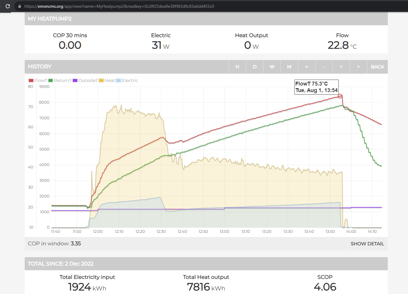

DanDee Posted August 6, 2023 Share Posted August 6, 2023 9 minutes ago, MikeSharp01 said: That's interesting data. I am curious about the steps at about 09:15 - 09:25 the trends carry on but are stepped lower, does the machine decide it is approaching setpoint and back off (Modulate down)? It does slow It does look like it could get the Flow even higher, for a lower CoP. Have added a few, very crude, lines to help me get it all in my head. I appreciate that the two trends (Power in / Power Out) won't ever meet but I thought is was interesting to see where they are going! another example to study https://emoncms.org/app/view?name=MyHeatpump2&readkey=0c28f25dea9e38f983d9c83a6dd455c0 Link to comment Share on other sites More sharing options...
SteamyTea Posted August 6, 2023 Share Posted August 6, 2023 6 minutes ago, MikeSharp01 said: I am curious about the steps at about 09:15 - 09:25 the trends carry on but are stepped lower, They coincide with the 'heat' plots. What are the heat plots actually measuring? When dealing with thermodynamics, nothing is a straight line, even if it looks like it sometimes. Using my very favourite equation ekt, it is only when k is set to 0, or infinity, that you get a strait line. Link to comment Share on other sites More sharing options...
SteamyTea Posted August 6, 2023 Share Posted August 6, 2023 2 minutes ago, SteamyTea said: What are the heat plots actually measuring 4 minutes ago, DanDee said: another example to study Right, quite correctly, 'Heat' is energy. Link to comment Share on other sites More sharing options...
Beelbeebub Posted August 6, 2023 Author Share Posted August 6, 2023 1 hour ago, MikeSharp01 said: That's interesting data. I am curious about the steps at about 09:15 - 09:25 the trends carry on but are stepped lower, does the machine decide it is approaching setpoint and back off (Modulate down)? It does slow It does look like it could get the Flow even higher, for a lower CoP. Have added a few, very crude, lines to help me get it all in my head. I appreciate that the two trends (Power in / Power Out) won't ever meet but I thought is was interesting to see where they are going! My guess is that the pump was unable to eject enough heat to the cylinder at the deltaT between the 75C flow and cylinder temp, which would have led to an unacceptably high system temp and pressure. So it modulated it's speed down so the power output was lower with the same flow temp IE lower water flow rate. This allowed it to continue operating, but at a lower COP. All a bit of guesswork tho. Link to comment Share on other sites More sharing options...
MikeSharp01 Posted August 6, 2023 Share Posted August 6, 2023 1 hour ago, SteamyTea said: When dealing with thermodynamics, nothing is a straight line, even if it looks like it sometimes. Using my very favourite equation ekt, it is only when k is set to 0, or infinity, that you get a strait line. You are right but PowerPoint, that I used to add those trends, only really does straight lined. I hated thermodynamics at Uni - I only did one course and decided my future did not lay in that direction so steered well clear. Even though now it might have been useful I wouldn't have wanted to clutter my brain with it for 40 years only to find it useful now! Respect to those that get it though🤩 Link to comment Share on other sites More sharing options...
sharpener Posted August 6, 2023 Share Posted August 6, 2023 28 minutes ago, Beelbeebub said: My guess is that the pump was unable to eject enough heat to the cylinder at the deltaT between the 75C flow and cylinder temp, which would have led to an unacceptably high system temp and pressure. So it modulated it's speed down so the power output was lower with the same flow temp IE lower water flow rate. This allowed it to continue operating, but at a lower COP. All a bit of guesswork tho. That seem a good explanation. But what are the spikes in heat o/p at 0850 and 0905, there a corresponding dips in the F & R temps but nothing on the elec consumption, what is going on here? Link to comment Share on other sites More sharing options...

DanDee Posted August 6, 2023 Share Posted August 6, 2023 1 hour ago, sharpener said: That seem a good explanation. But what are the spikes in heat o/p at 0850 and 0905, there a corresponding dips in the F & R temps but nothing on the elec consumption, what is going on here? That's when you use the hot water from the tank. Link to comment Share on other sites More sharing options...
Beelbeebub Posted August 6, 2023 Author Share Posted August 6, 2023 4 hours ago, sharpener said: That seem a good explanation. But what are the spikes in heat o/p at 0850 and 0905, there a corresponding dips in the F & R temps but nothing on the elec consumption, what is going on here? At a guess, there was a transient (eg water pump and/or compressor speeds changed) at that point, that confused the heat meter. it doesn't affect the total heat quantity delivered because the spike is relatively short, but does muck up the instantaneous reading. Link to comment Share on other sites More sharing options...
