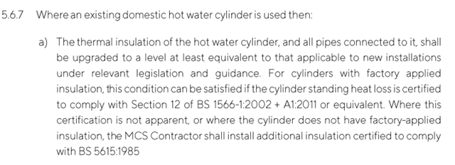

Returning to the question of retaining existing dhw cylinders discussed upthread, para 5.6.7 of mis 3005-d might wipe that idea out.  It's ambiguous, but one reading says that, if the primaries to the retained cylinder aren't already insulated, then insulation needs to be fitted to the primaries.  This might involve accessing pipes under solid flooring that can't be lifted easily like carpet/floorboards can, together with all associated works on skirting and fittings, in some cases (including my own) adding thousands to the cost.
I have taken this up with the MCS helpdesk.  Their initial reaction was to confirm that this unreasonable interpretation was the correct one, but on further questioning admitted that they weren't actually sure and had escalated it to the technical team.  I am awaiting further feedback which I will post here.  If they confirm the unreasonable explanation then that's another nail in the coffin for a reasonably affordable ashp retrofit.  Let's hope they see sense!
Has anyone else queried this in the past?

Here is the quote from Part L  I have italicised what I believe is the relevant text.
4.24 In a new system, all of the following new pipework should be insulated.
a. Primary circulation pipes for heating circuits where they pass outside the heated living space, including where pipework passes into voids.
b. All primary circulation pipes for domestic hot water.
c. All pipes that are connected to hot water storage vessels, for at least 1m from the point at which they connect to the vessel.
d. All secondary circulation pipework.

So "primary circulation" (rule b) seems to trump the "1 metre" bit (rule c).
All qualified by "In a new system". Does an old hw system incorporated into a new HP system become "new" or not @JamesPa ?

In short, yes according to MCS (not according to building regulations):
From MIS 3005-I
From MCS Helpdesk
"Firstly, yes we can confirm ‘new’ installations means new installations in existing or new buildings.
The reason for the clause regarding upgrading the insulation on existing cylinders is to ensure heat loss is minimised via existing pipework and existing primary feeds to promote higher efficiency of heat pump systems. Due to the unknown condition of the existing insulation, we cannot assume that the insulation is adequate enough to meet the same standards as new installations. If we relied on the existing insulation, we pose the risk of poorly performing systems.
The difference between the first and second sentences is whether the existing insulation was factory fitted to Section 12 of BS 1566-1:2002 + A1:2011, rather than installed by the installer on-site and not compliant with the above standard. The reason the quality of the existing insulation can be satisfied by this sentence is that compliance with this standard provides enough evidence of higher quality insulation, in comparison to on-site installation.
If the insulation was not factory fitted to Section 12 of BS 1566-1:2022+A1:2011, we require the insulation to be upgraded to BS 5615:1985.
However, we appreciate your concerns on how this may cause major disruption with the need to lift flooring, but essentially, we cannot risk reducing system performance based on a lack of/poor existing insulation. I have fed your comments/concerns back to our technical working for comment as we are always looking to improve our standards in anyway we can. "
This says,at least in my reading, that the primaries must be upgraded.   I have called them, talked them through why this is utter madness, and have been told that the emails 'have been passed to the technical team'.  I think I am due a further response but, as it stands installers who do not replace the cylinder would be right to insist on upgrading insulation on primaries if it doesn't meet the latest standards, even if that means
  • lifting and replacing 30sq m of Amtico (just a random example - not what I have, but perfectly plausible)
  • removing and replacing skirting (and making good),
  • removing and replacing fixed furniture (eg sanitary fittings) and
  • relocating primaries in notched joists elesewhere so they can pass through using drilled holes (I cant see how you can insulate piped which are bang up against the floorboards).
all to insulate 5m of pipe.

Update on the above, for once good news.  MCS now accept that, where it is not reasonable to upgrade existing pipework to a retained DHW cylinder, and where Building regulations do not require it to be ungraded, MCS wont insist that they be upgraded.
Here is the email I received from MCS today:
"Thank you for your patience whilst I awaited a reply from our working group. As our working group is made up of volunteers, this is why it took some time to get a reply.
Firstly, thank you for highlighting the ambiguity of the clause around using existing cylinders . As part of 5.6.7 clause a), we mandate that the cylinder and pipes in an existing system are to comply with relevant legislation. Below is a screenshot of the relevant requirements under building regulations around the insulation of pipework:
[screenshot of regulations 4.24 and 4.25 in building regulation part L]
MCS mandate that the above building regulations are adhered to when using an existing system as the clause states that the insulation shall be upgraded to at least the equivalent of what’s stipulated in 4.24 in the building regulation requirements above. However, 4.24 above uses the word ‘should’ in which MCS use this term as “prescribes and requirement or procedure that is intended to be complied with unless reasonable justification can be given”. Therefore, if it is unreasonable to insulate all pipework (in this instance due to the significant disruption of lifting flooring), then that would be accepted under building regulations and therefore also by MCS. Reasonable attempts should be made to insulate all pipework, however, if this is not the case, then it would be expected that the contractor properly assesses the effects of this on the system performance and efficiency and advise the customer accordingly.
As a response to this query, MCS will make the necessary changes to clause 5.6.7 a) with MIS 3005 D in the next rewrite to allow for clearer understanding. "
Thank you again for raising this
Well done for persisting @JamesPa, another small step in the right direction.
