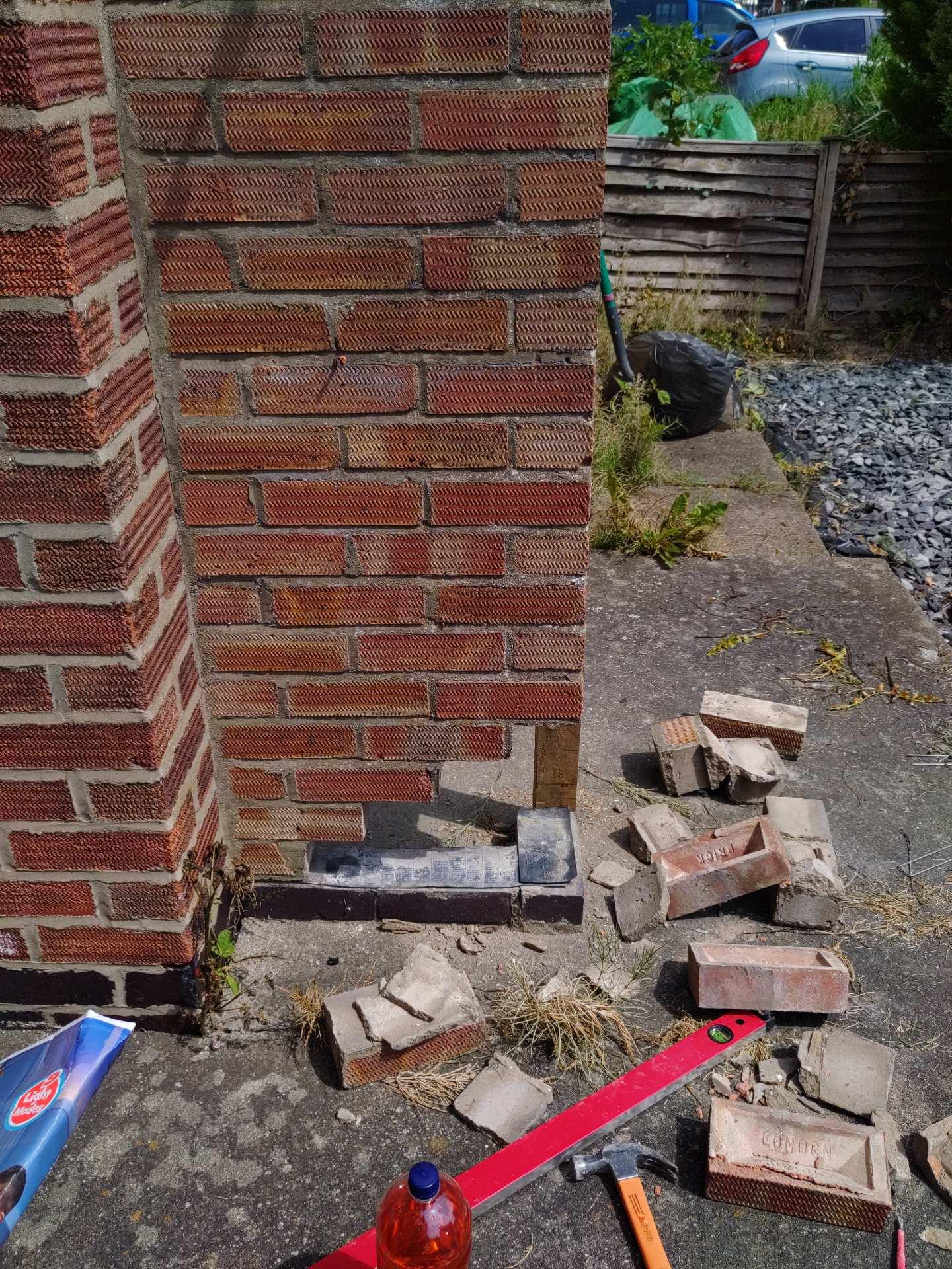

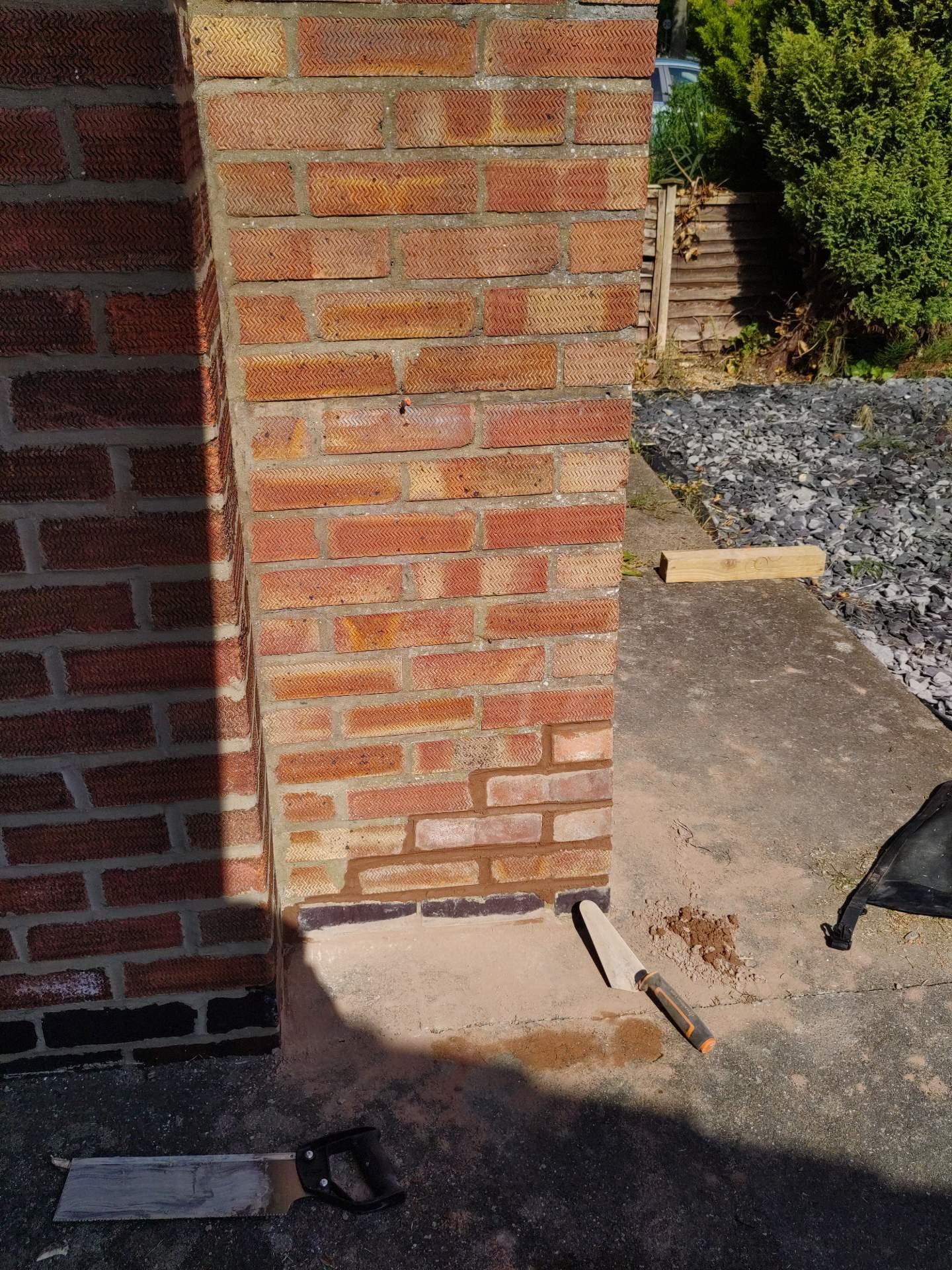

Heh, I did a small repair on my sister's brick-built porch made of "london brick" back in May, which I think are the same thing.
To add to the varieties you've researched here, the original work was done so that the frogs were facing each other - i.e. you got a diamond-shaped void filled with mortar every two courses. I assume it's like this all the way up the porch. I was not expecting that! The diamonds came out of the bricks very easily, so I decided to re-use them, copying the original method.
It was an absolute pig to get the "down" frogs filled when I was replicating it (I had/have no idea what is correct, of coursE).
Oh, and these bricks also had two different face textures - smooth vs. wavy imprints. I was focused enough on the frog situation that I didn't notice that and put them all in back-to-front 😬. My sister was kind enough not to insist that I re-do it.
It's a world away from your bigger projects, but I enjoyed reading your research and thought this real-world application might amuse you. Have some before/after pics!
lc1.thumb.jpg.cc983c82d4445baf6b196cf5ce4de016.jpglc2.thumb.jpg.d93d422176b2e55394a0cb6632273cb8.jpg
You can see a bit of spalling on a few of them too 🤷‍♀️
Edited by Nick Thomas
note spall
