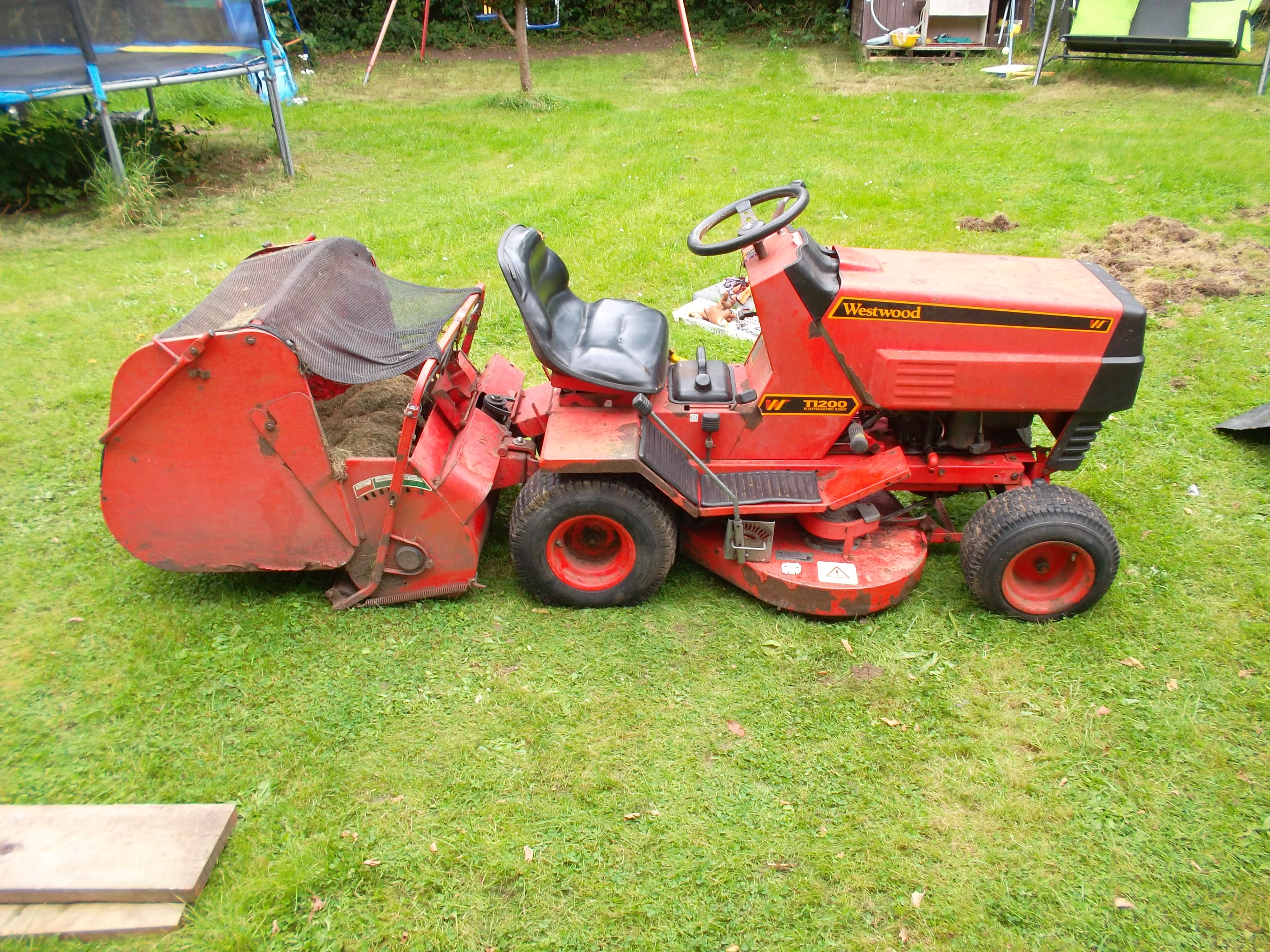

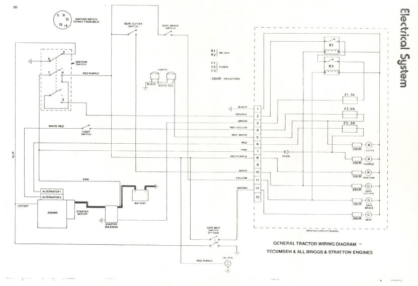

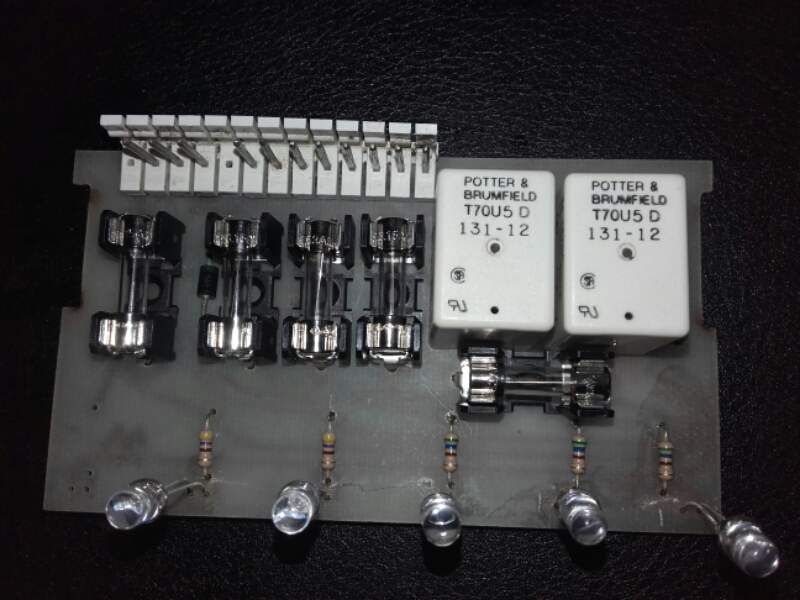

Onoff Posted August 19, 2017 Share Posted August 19, 2017 Got given a Westwood T1200 in need of repair a while back. Sorted the grass collection flail system ages ago with some 1" (not 25mm) box section I had from a clothes display rack I scored somewhere. Had my son fit the starter motor gear set the other day. So that's the electric start back running once we sort the charging circuit so his next project is to sort the pcb: One duff fuse before the diode and a broken pin after seems the issue. £20 of components from CPC on their way He'll take the board back to bare bones, replace the fuse holders and fuses, LEDs with new value resistors to suit etc, then make good all the joints. Link to comment Share on other sites More sharing options...

Temp Posted August 20, 2017 Share Posted August 20, 2017 I think my wiring is similar. All it really needs is a kill switch to short out the coil but there are numerous relays and switches for "safety" reasons (eg to stop you starting the engine unless the brake is on, the cutter is off and someone is sitting in the seat). If you ever decide to replace the battery beware that Halfords sells two mower batteries that are identical except the +ve and -ve are swapped over. Link to comment Share on other sites More sharing options...
Onoff Posted August 20, 2017 Author Share Posted August 20, 2017 (edited) 6 hours ago, Temp said: I think my wiring is similar. All it really needs is a kill switch to short out the coil but there are numerous relays and switches for "safety" reasons (eg to stop you starting the engine unless the brake is on, the cutter is off and someone is sitting in the seat). If you ever decide to replace the battery beware that Halfords sells two mower batteries that are identical except the +ve and -ve are swapped over. Ta. Old battery though showing 12V after a charge has no real life so new battery time I think. Pic of the beast in question: Been out playing with the mechanics of it today. Only started on it yesterday as the wife had been using it and said it was hard to get in gear. Took the blades off and sharpened them and tack welded one of the little blade ends back on that was loose. For some reason the belt wants to jump off the rear pulley atop the gearbox all the time. Was just happening in reverse but now more often when trying to pull away in gear. I fitted an M12 bolt to try and stop it but it still does it. Amazed how as the shank is pretty much touching the pulley without impeding it. I'm pointing here to nyloc nut on the bolt I added: And from the underside. You can see where the belt is sitting underneath having come off. Quite how it jumps off the pulley with the bolt there amazes me as I say. Seems more likely to happen if you let your foot off the clutch/brake quickly. Do it very slowly and it happens far less. To get the belt back on I have to loosen that bolt every time now. Garden ornament at the mo! EDIT: That's the badger's handiwork in the background on the lawn. Every year we wake up to random patches that have bee excavated. Heard they're searching for the larvae of certain insects; leatherjackets, cockchafers etc. Not sure what other than they make a mess! Edited August 20, 2017 by Onoff Link to comment Share on other sites More sharing options...

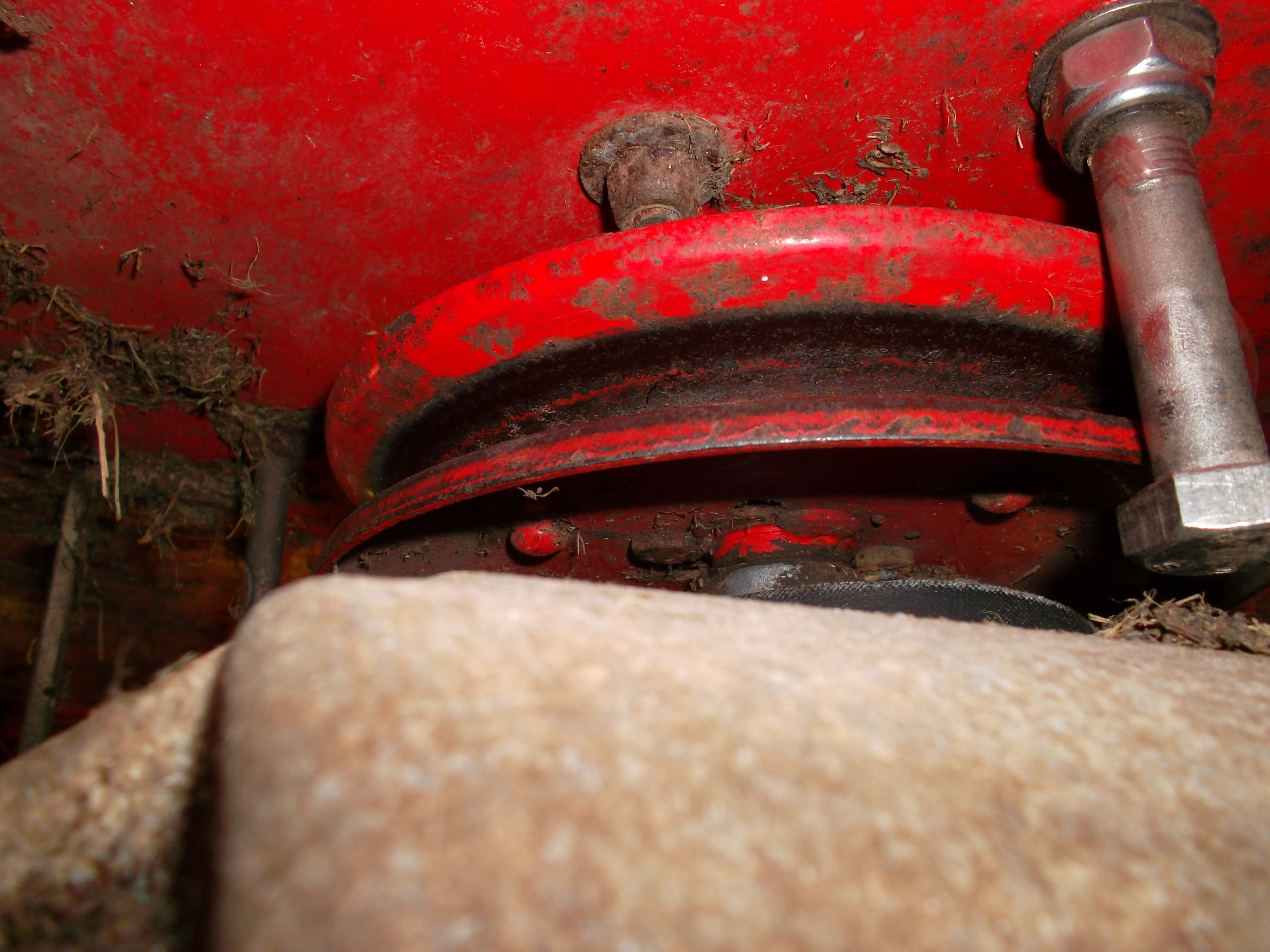

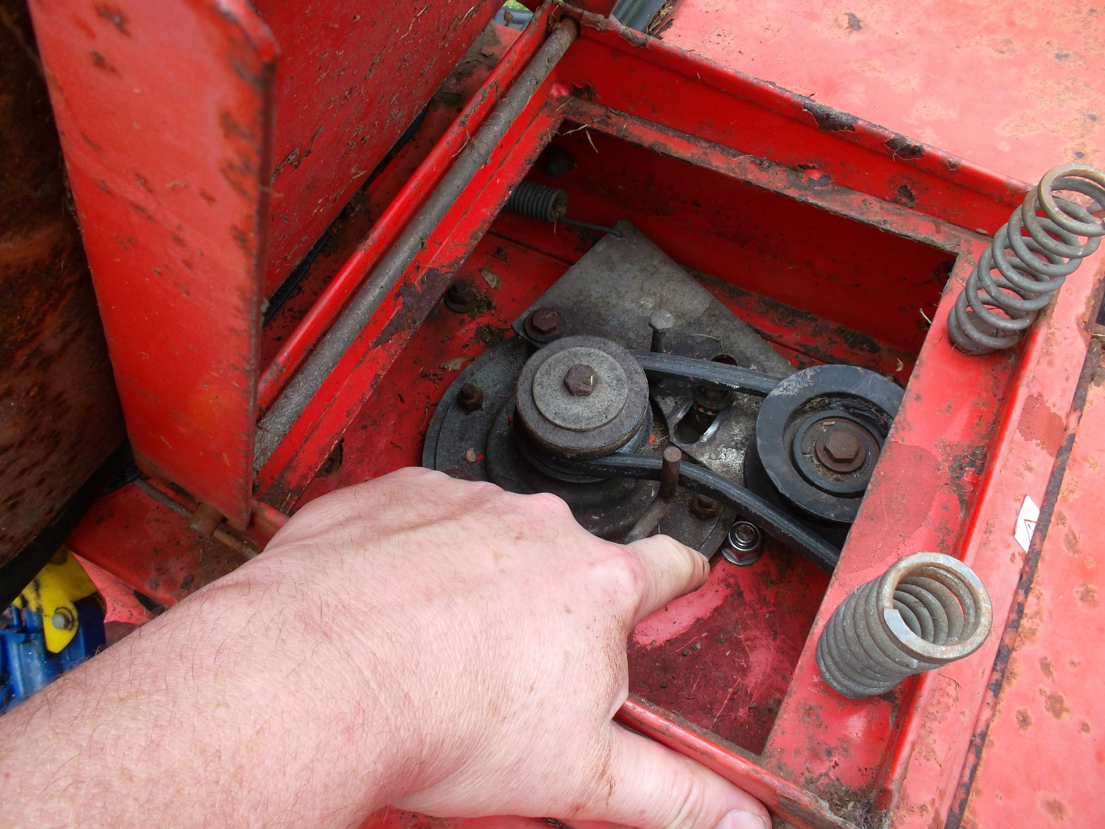

Temp Posted August 21, 2017 Share Posted August 21, 2017 (edited) Is there a lot of play in the pulley bearing? Otherwise hard to see how the belt came off. Edited August 21, 2017 by Temp Link to comment Share on other sites More sharing options...
Triassic Posted August 21, 2017 Share Posted August 21, 2017 Mine needs a new cutter deck! Link to comment Share on other sites More sharing options...
Onoff Posted August 21, 2017 Author Share Posted August 21, 2017 6 hours ago, Temp said: Is there a lot of play in the pulley bearing? Otherwise hard to see how the belt came off. No, nothing, no apparent play. The belt is actually getting a little frayed and has a chunk out of it so maybe that's catching. Getting boring now but there is really NO gap between that added bolt and the pulley. I almost want it up on a car ramp and running to see what makes it come off. Seems it's part number 1688 for the belt, only about a tenner for repro ones off eBay so I'll get a couple. Westwood kindly emailed me a user manual and parts list (hence the circuit diagram above). A bitch to get in gear so something's going on there. There's a rod comes off the brake/clutch pedal and attaches to the side of the gearbox. Doesn't seem to be doing a lot at the mo as in you can depress the pedal but it's not rotating the shaft going into the box. That's a starting point I think. Sod's Law it's easy to get to if you remove the o/s rear wheel. Link to comment Share on other sites More sharing options...

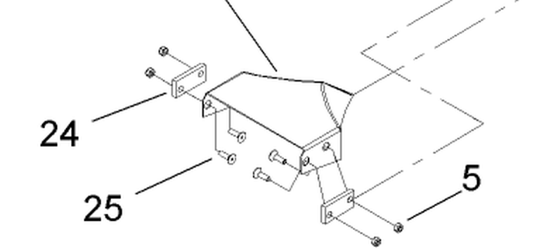

Temp Posted August 21, 2017 Share Posted August 21, 2017 (edited) Just had to pay out £100 on my Toro :-(. Under the desk there is small pointed box of metal that deflects grass up the chute. I caught the nose of that on a kerb bending it downwards 90 degrees. It ploughed a groove across the lawn before I noticed. Was a pig to get the deck out from under the mower because with that sticking down I couldn't lower the deck. Second time it's happened, first time I was able to bash it back into shape but this time it was impossible so had to order new. Looks easy to make but for the double curves on the front. I imagine it cost <£1 to make in China. Cheapest supplier was this place in Germany.. https://www.ersatzteil-service.de/ Edited August 21, 2017 by Temp Link to comment Share on other sites More sharing options...

Onoff Posted August 21, 2017 Author Share Posted August 21, 2017 (edited) As you press the "combined brake clutch control pedal" forward: This assembly coming o/of the gearbox, behind the o/s rear wheel pivots, on the bottom bolt, backwards. Looks ideally placed to interfere with the belt, being so close to the pulley. Slack belt more likely to catch I'm thinking. Edited August 21, 2017 by Onoff Link to comment Share on other sites More sharing options...
Onoff Posted August 26, 2017 Author Share Posted August 26, 2017 Boy's tidied the pcb up: New belts came today but I was playing in the bathroom. Link to comment Share on other sites More sharing options...
Temp Posted August 26, 2017 Share Posted August 26, 2017 Almost looks new. Link to comment Share on other sites More sharing options...
Onoff Posted August 26, 2017 Author Share Posted August 26, 2017 Just now, Temp said: Almost looks new. Yep, he did alright with it! Replaced the broken pin 7 on the connector with the unused pin 9. The track side's a bit worn. Tried re-tinning some tracks but not good even with flux. Pcb would be easy enough to remake if necessary. Link to comment Share on other sites More sharing options...

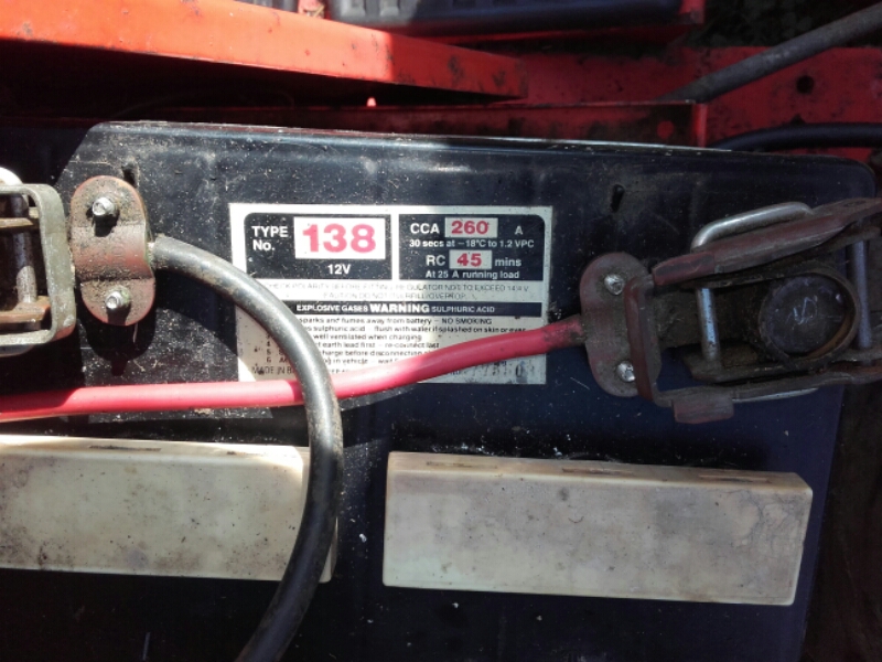

Onoff Posted August 28, 2017 Author Share Posted August 28, 2017 Yeah! The refurbed mower pcb works, good lad! All LEDs seem to do what they should in response to ignition, charge, cutter engage, lights and brake. Stuck a Capri battery on it just to test (but physically too big). Best price I've found is £45 delivered for a new battery. Had to cut off a cranked M8 bolt in order to fit the new drive belt so I'll make a new one tomorrow out of some 9mm bar I've here. I just couldn't get any purchase on the inaccessible, original, rounded, rusted nut. 1 Link to comment Share on other sites More sharing options...
Onoff Posted August 28, 2017 Author Share Posted August 28, 2017 Anyone know a cheaper place for the battery than here? https://advancedbatterysupplies.co.uk/product/abs-138/ Cheers Link to comment Share on other sites More sharing options...
