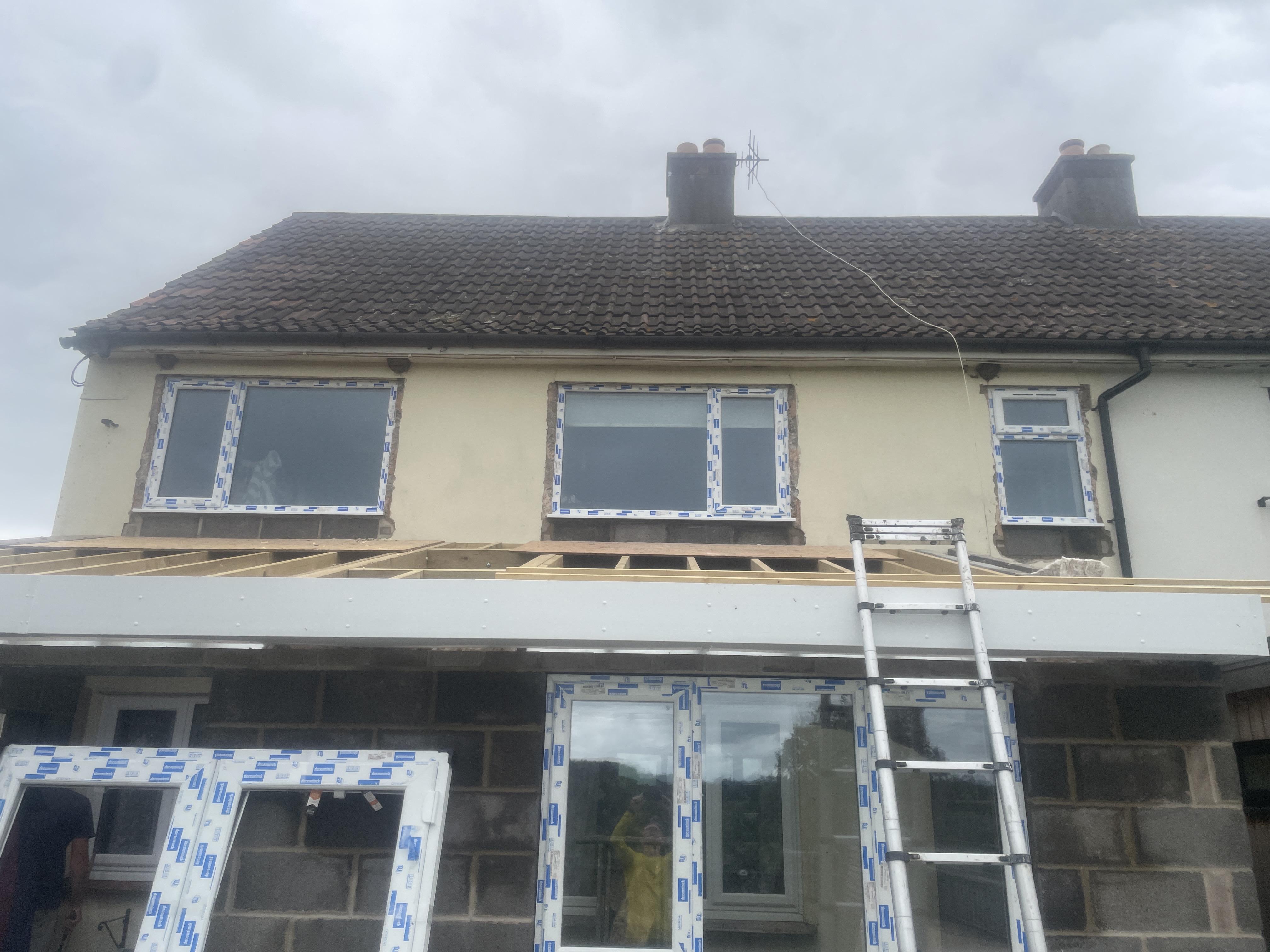

HughF Posted August 1, 2023 Author Posted August 1, 2023 Update….. as I had gapped the windows to be ‘nice and tight’, and as three of them were retrofit (didn’t want to remove too much internal reveal plaster), I didn’t use the me508. Used a mixture of 13-25 and 3-7 Compriband, positioned mid-frame in the channel where the brackets would go. 330 foam where I could see daylight after the Compriband expanded. BCO came today and seemed happy… didn’t care about the lack of trickle vents on the extension windows (we did say we were fitting dMVHR), didn’t even comment on the position related to the cavity 🤣
