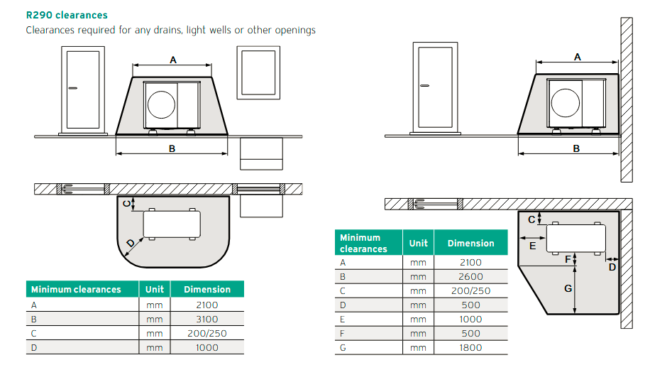

Post and beam Posted July 13, 2023 Share Posted July 13, 2023 A company that provided me a quote for ASHP has told me that the present proposed location as per my planning elevations and floor plans is not allowed. It is between 2 kitchen windows. Apart from noise to neightbours and clearance for airflow i did not realise there were such restrictions. I have looked through the building regs 2022 and cannot see what the issue is. Can anyone enlighten me please Link to comment Share on other sites More sharing options...

JamesPa Posted July 13, 2023 Share Posted July 13, 2023 Units with R290 refrigerant have restrictions because it's heavier than air and flammable. They will be detailed in the instructions, suggest you check them. 1 Link to comment Share on other sites More sharing options...

sharpener Posted July 14, 2023 Share Posted July 14, 2023 16 hours ago, JamesPa said: Units with R290 refrigerant have restrictions because it's heavier than air and flammable. They will be detailed in the instructions, suggest you check them. Here you are (from Vaillant brochure), not quite to scale, their units are 1100mm wide: Link to comment Share on other sites More sharing options...

Post and beam Posted July 16, 2023 Author Share Posted July 16, 2023 Thanks guys. That Vaillant diagram from @sharpener is exactly the one that i was given. It is a 7kw Vaillant that has been quoted for. As i am not keen on looking for a new location i think the best option is to find an R32 install Link to comment Share on other sites More sharing options...

Beelbeebub Posted August 27, 2023 Share Posted August 27, 2023 Aren't you looking to put your HP under a window? The diagrams show exclusion to the side, in front, behind, but not above the top of the HP. R290, propane, is heavier than air. The worry is any leak might allow propane to sink down and flow into the house, say through an air brick or pool in a light well or drain gully. It's not going to float up into a window. Link to comment Share on other sites More sharing options...
Post and beam Posted August 28, 2023 Author Share Posted August 28, 2023 15 hours ago, Beelbeebub said: Aren't you looking to put your HP under a window? Yes 15 hours ago, Beelbeebub said: It's not going to float up into a window. I know. But it was not me that said i could not do it. It was a heat pump installation company. Just goes to show that getting ' expert advice' from the industry cannot always be relied upon. As it happens a second opinion from another company,(In Ipswich) advocating a Vaillant R290 machine have said that as long as the window sill is at leat 1mm above the top of the pump then all is good. Link to comment Share on other sites More sharing options...
Beelbeebub Posted August 28, 2023 Share Posted August 28, 2023 2 hours ago, Post and beam said: Yes I know. But it was not me that said i could not do it. It was a heat pump installation company. Just goes to show that getting ' expert advice' from the industry cannot always be relied upon. As it happens a second opinion from another company,(In Ipswich) advocating a Vaillant R290 machine have said that as long as the window sill is at leat 1mm above the top of the pump then all is good. That sounds better. The vaillant machines look really good anyway. Link to comment Share on other sites More sharing options...
