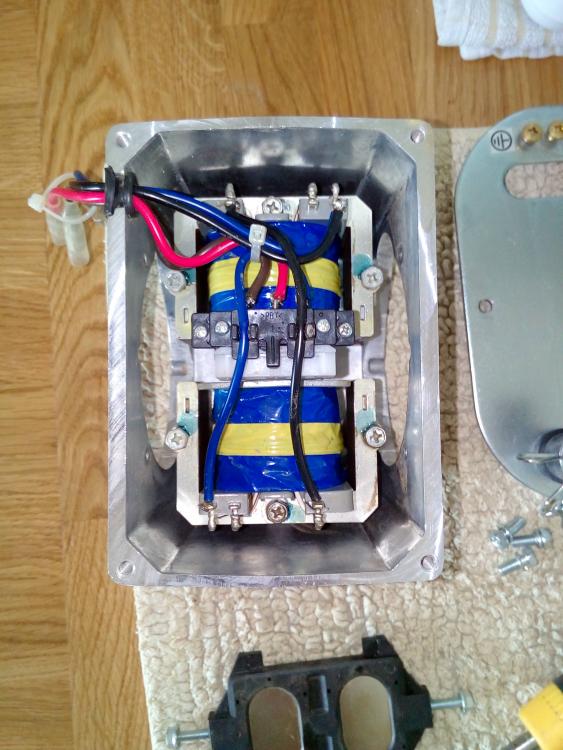

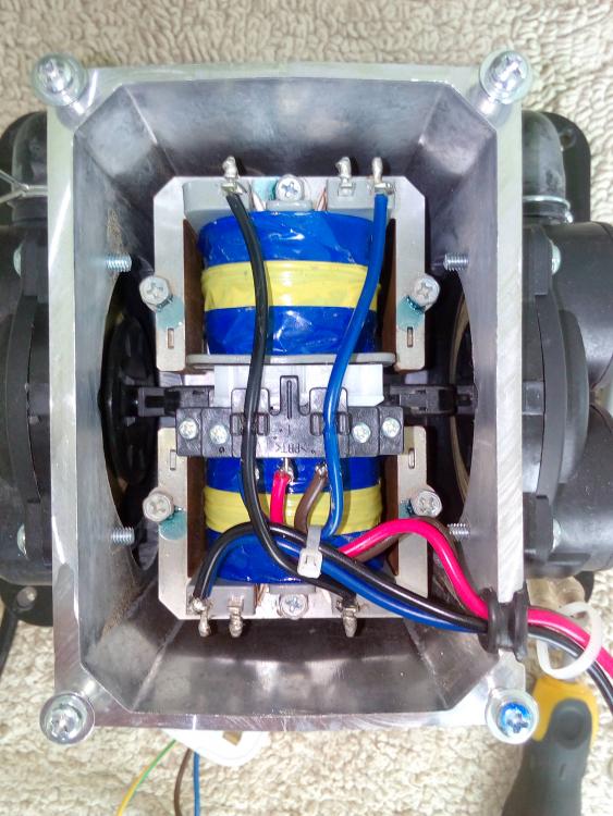

Jeremy Harris Posted August 26, 2017 Posted August 26, 2017 Bear in mind that some of these pumps have a diode in series with the coils, in order to reduce the operating frequency from 50 Hz to 25 Hz. This means that, depending on where the diode is, that you may get an odd resistance reading on a multimeter, and the resistance may appear to change between one multimeter and another (because the diode forward resistance will depend on the test voltage and current that the meter uses in resistance mode). I've yet to strip and check the Secoh to see if it has diodes, and if so, where they are, but it's something I need to get around to doing in the next few weeks, as I pulled it out and fitted the spare, with the intention of servicing the old one, fitting new diaphragms etc and putting that "back into stock" as a spare. When I do I'll try and remember to post the details here, for reference.
ProDave Posted August 26, 2017 Posted August 26, 2017 Not sure how a diode halves the frequency? the waveform is still 50Hz but now somewhat lumpy. I can see it as a crude way to reduce power, not one the electricity suppliers would like.
Jeremy Harris Posted August 26, 2017 Posted August 26, 2017 (edited) 37 minutes ago, ProDave said: Not sure how a diode halves the frequency? the waveform is still 50Hz but now somewhat lumpy. I can see it as a crude way to reduce power, not one the electricity suppliers would like. You're right, I was wrong - brain fade. The one I've already had apart (a smaller one I was playing about with) used a diode in series with each coil, and I'm guessing this is to create a crude pulse, followed by a pause when the coil is de-energised (because of the diode blocking the other half wave), that allows the armature to move back via the diaphragm springs. Without the diode in series with the coils, the armature would probably just stay at one end, rather like a contactor. Edited August 26, 2017 by JSHarris
dpmiller Posted August 26, 2017 Posted August 26, 2017 No, it would attempt to shuttle at 50Hz and make a horrendeous noise. Contactors, solenoid valves and the like "stick" either because the laminations form a complete coil when closed or there's a "shading ring" acting as a second coil of sorts. Two diodes give you that 25Hz pulse and the diaphragms damp it sufficiently that it isn't clattering off endstops.
ProDave Posted August 26, 2017 Posted August 26, 2017 If the armature was a permanent magnet, it would shuttle back and forth at 50Hz with just a simple coil energising the armature. I would have thought they would have designed the mechanics to be resonant at 50Hz so it would shuttle back and forth at 50Hz very efficiently. Any other mechanical resonant frequency and it will need more power to force it to move at an unnatural frequency.

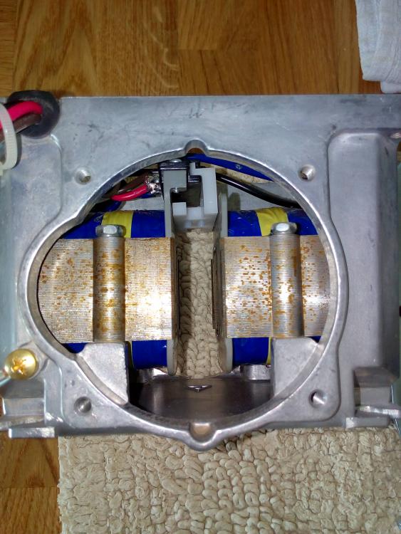

Jeremy Harris Posted August 26, 2017 Posted August 26, 2017 (edited) The armature in the one I took apart (a smaller pump that I thought might be able to do the job) was just a bit of steel or iron. I would guess that a magnet would end up being demagnetised by the coils, as we used to have a tool de-magnetiser that was just a big coil with an open gap in the core, into which you could insert tools and then slowly pull them away to remove any residual magnetism. There were soft limit stops at either end of the one I stripped, intended to prevent the armature travelling too far and over-stressing the diaphragm as much as reduce noise, I think. There was also a switch, that would be operated if the armature moved too far off-centre, that turned off the pump. I have a feeling that the switch was there as a fail-safe in the event of the support springs breaking. EDITED: SEE POST BELOW THAT CORRECTS SOME INFO ABOUT THE SECOH PUMPS Edited August 26, 2017 by JSHarris
Jeremy Harris Posted August 26, 2017 Posted August 26, 2017 OK, I've just pulled the cover off the old pump and started to take it apart. This is a Secoh JDK-60, without the alarm switch (the newer JDK-60 I used to replace this a couple of weeks ago has an alarm light on the top, so I assume also has a switch, like the small unit I stripped a couple of years ago). First off, there is no obvious sign of diodes inside this Secoh pump, unlike the Hailea pump that I stripped previously. Secondly, the armature inside the Secoh pump does seem to be magnetic, again, unlike the Hailea pump. I can see from just looking at the top of the core unit of the Secoh JDK-60 that the two coils are directly wired in parallel, with no diodes. I'll carry on stripping it down and replacing the diaphragms, and if I spot anything else that differs from the Hailea I'll edit this post. As a word of caution, it seems that not all of these pumps work on the same principle, so generalising about them may be unwise!
