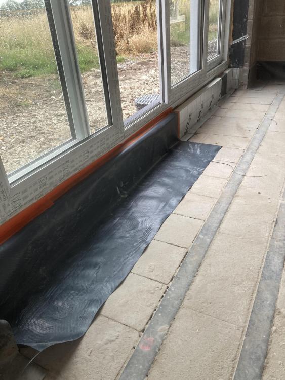

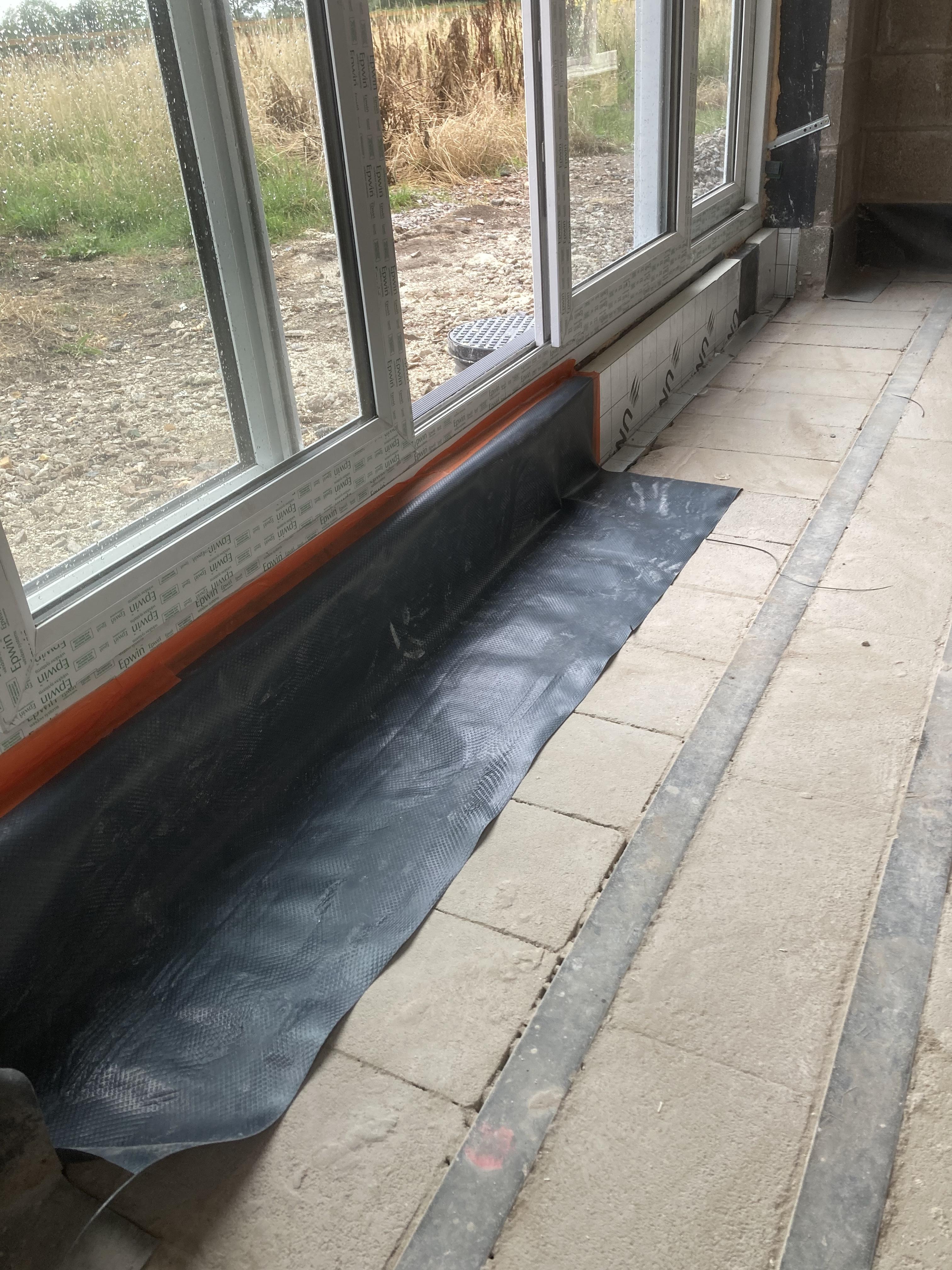

nod Posted July 8, 2023 Posted July 8, 2023 Just thought I’d post this as it crops up as a question regularly I knocked the block work out around the five openings today 2 2
JackofAll Posted July 8, 2023 Posted July 8, 2023 49 minutes ago, nod said: Just thought I’d post this as it crops up as a question regularly I knocked the block work out around the five openings today Is that Dpm covering the cavity in the top right corner?
Big Jimbo Posted July 8, 2023 Posted July 8, 2023 @nod How much screed cover will you end up with above the pir upstand fella.
nod Posted July 8, 2023 Author Posted July 8, 2023 Nothing above the upstands Last time I just ran the tile matting over them and tiled on top 1

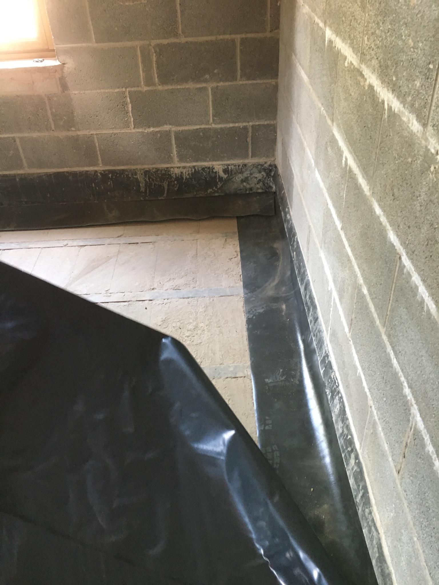

nod Posted July 8, 2023 Author Posted July 8, 2023 39 minutes ago, JackofAll said: Is that Dpm covering the cavity in the top right corner? Yes it’s curled behind the up stand In any case it’s all below dpc There will be an apron of dpc around the perimeter taped to the high load damp course Then two more membranes No chance of anything coming through 2
Iceverge Posted July 8, 2023 Posted July 8, 2023 @nod What's taking the weight of the door? Is it resting on the outer leaf?
nod Posted July 8, 2023 Author Posted July 8, 2023 44 minutes ago, Iceverge said: @nod What's taking the weight of the door? Is it resting on the outer leaf? yep Only ever the outer leaf
dpmiller Posted July 9, 2023 Posted July 9, 2023 9 hours ago, nod said: yep Only ever the outer leaf that'd be a good trick with check reveals
nod Posted July 9, 2023 Author Posted July 9, 2023 37 minutes ago, JackofAll said: @nod what size cavity did you go with? 150

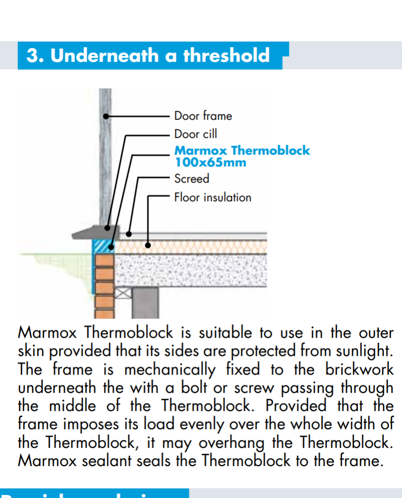

Dave Jones Posted July 9, 2023 Posted July 9, 2023 this is how im doing ours to climate the massive cold bridging issue, albeit with permiter upstand as well. Using marmox as the outer skin as they wont be seen (level threshold). 1
JackofAll Posted July 9, 2023 Posted July 9, 2023 9 hours ago, nod said: 150 Thanks, what is the black stuff you closed the cavity with?
