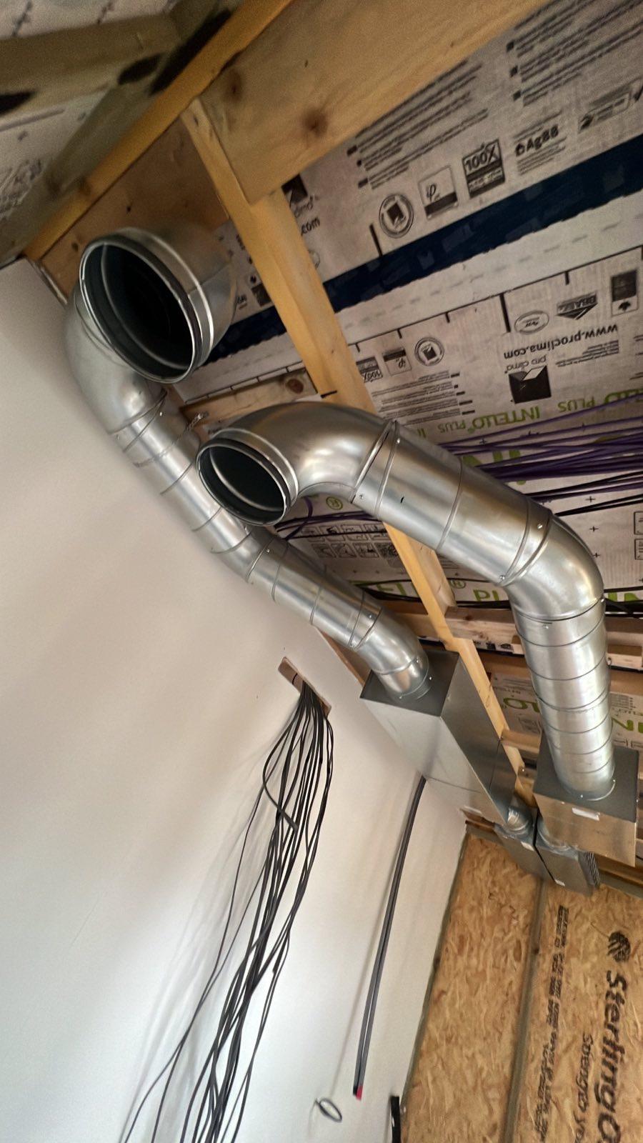

I’ve had this battle just today. Due to our ceiling height problem we can’t lose this above the ceiling which was the original plan ad we’ve had to push the ceiling header up reducing the void above. 031F95E6-4939-4AD2-822D-5E5B41C592DF.thumb.jpeg.82f20b3c1536d1df55a90b5ac2e8a496.jpeg
Drop ceiling where you have this?  That's what we had to do..
Same. We have 2760 ceiling + 150 void and we're dropping to 2400 (so a 510 void.. for....:
boom. :)
