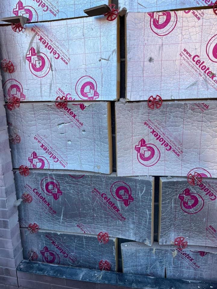

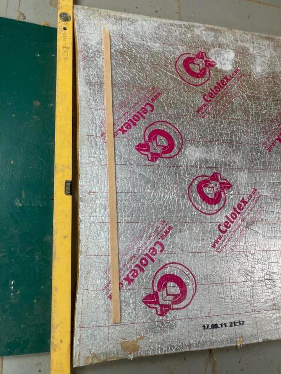

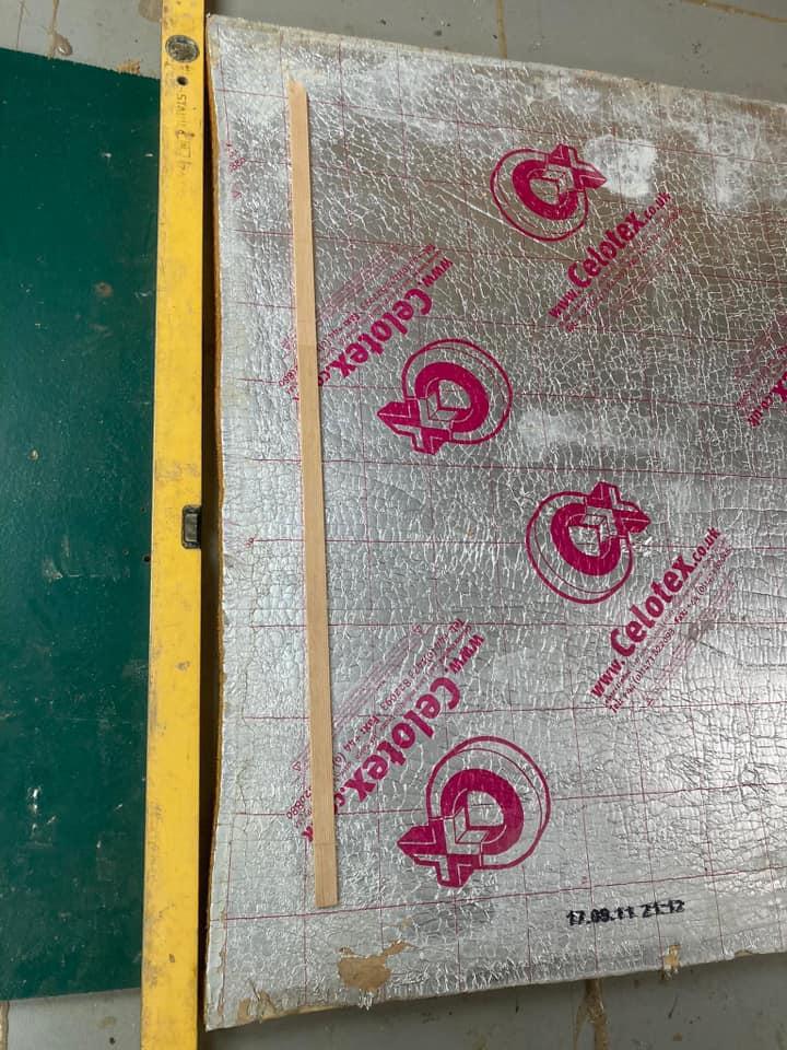

jayc89 Posted July 4, 2023 Posted July 4, 2023 Came across a guy on Facebook claiming Celotex shrinkage is pretty bad and then posted this; Never seen anything like it
MikeGrahamT21 Posted July 4, 2023 Posted July 4, 2023 Thats got to be a faulty batch. I've had PIR in the loft which is years ago (odds and sods), and still looks the same as it did when i bought it
Mr Punter Posted July 4, 2023 Posted July 4, 2023 It seems to deteriorate when exposed to the weather.
SteamyTea Posted July 4, 2023 Posted July 4, 2023 Polyurethanes can shrink quite a bit. We used to work on 3 to 5% depending on the mix. Some of the fast setting elastomers can easily be 10% and continue to shrink for years (Look at a Panther Kalister dashboard, it was a perfect fit when I made the tooling). Think how plump your new furniture was compared to when it is a few years old. I have heard that you can buy 'aged' insulation, but not really convinced it is of any benefit. As for the picture, that looks like something went wrong in the manufacturing and storage. Probably it got wet somewhere along the line as it is warped and shrunk (warping is actually caused by shrinkage, think bimetalic strip). It is not a unique problem to just polyurethane, really a problem for all composite materials.
Conor Posted July 4, 2023 Posted July 4, 2023 I've sheets that have been sitting outside in the elements for over a year that look way better than those. Looks like all the walls will have to come down?!!!
saveasteading Posted July 4, 2023 Posted July 4, 2023 That is date stamped 17/8/11. I wouldn't be surprised to find it is second hand, and badly stored at that. The top ones are smaller, maybe cut out of bigger sheets. I used a load of salvaged PIR in my house, and it handled as if new. I think it does shrink but not much. It would take some effort to bend it as shown. So don't worry about the product in principle.
Tims Posted July 4, 2023 Posted July 4, 2023 A neighbour tried to sell me some like that that his builder had left when he'd kicked him off his job. It was obviously ripped out of some where and then stored out in the elements for some time and had a similar date stamp. I pulled some out of a dry 15 year old conservatory floor that looked perfect, so I expect that the stuff shown has had a hard life and been out in the elements for some time.
Iceverge Posted July 4, 2023 Posted July 4, 2023 https://475.supply/blogs/foam-fails/foam-fails-reason-5-excessive-shrinkage https://www.rdh.com/wp-content/uploads/2017/06/Long-term-Polysio-Movement-and-Thermal-Performance-Study.pdf Alas it does. "Dumb" insulation with K value of no less than 0.032W/mK is a better bet long term. Cheaper too.
eandg Posted July 4, 2023 Posted July 4, 2023 Used fairly fresh Celotex in our build, which had mostly been up for 6 months until the sheets of plasterboard have closed in around it over the past few weeks. Any gaps foamed and taped. Zero shrinkage. PIR in loft will remain exposed unless I can be bothered sheeting it so will be a good wee experiment to see if that changes.
