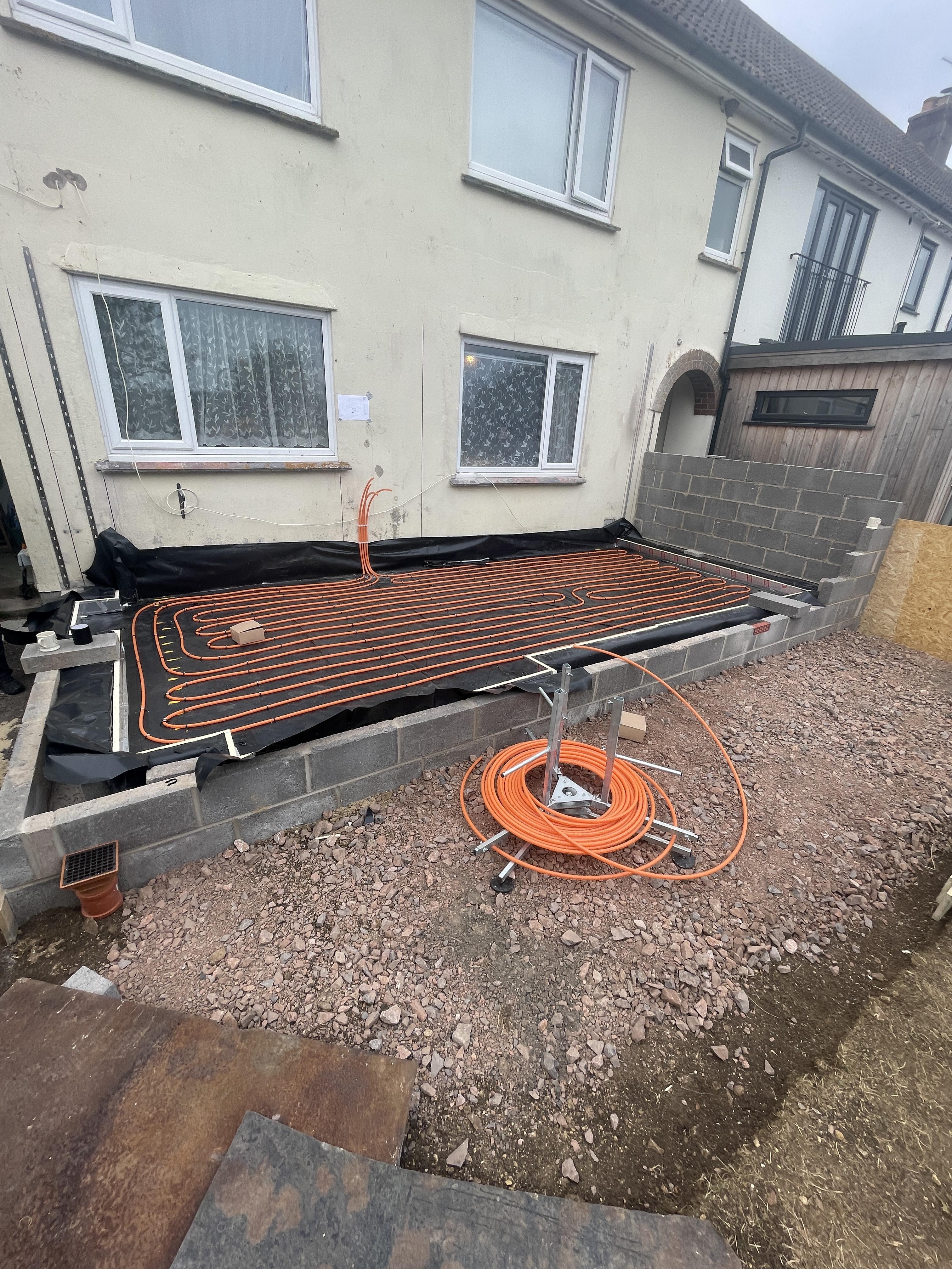

vala Posted June 27, 2023 Share Posted June 27, 2023 Should be starting a little extension which will form part of the UFH on the ground floor. Plan is to have the existing slab taken up, dug down, insulation and a new slab with UFH within. Plan is for the finished floor to be polished concrete but just the 'cream' standard. I need to discuss with the builder but from info I've read on here and other sources, I thinking of a baseline to be: hardcore compacted, sand binding, 200mm PIR, UFH on mesh, 100mm concrete slab. Would this be ok? Or should I be looking into other thicknesses of concrete, different amount of insulation, different insulation, UFH clipped onto PIR instead of tied to mesh, etc etc? Any help would be much appreciated. Link to comment Share on other sites More sharing options...
PeterW Posted June 27, 2023 Share Posted June 27, 2023 Why mesh ..? What size is the slab..? if no differential movement I would just go with 100mm slab and make sure there are no stress points such as changes in depth of the hardcore. Link to comment Share on other sites More sharing options...
vala Posted June 27, 2023 Author Share Posted June 27, 2023 24 minutes ago, PeterW said: Why mesh ..? What size is the slab..? if no differential movement I would just go with 100mm slab and make sure there are no stress points such as changes in depth of the hardcore. builder mentioned it when we were discussing floor build up due to the UFH. not set on using it, just looking at other option and then will discuss with him. if we can lose the mesh then great, and can then just clip the pipe work to the PIR. slab is only circa 55sqm. Link to comment Share on other sites More sharing options...

vala Posted July 25, 2023 Author Share Posted July 25, 2023 So looks like polished concrete may off be table now, so the back up option is to go tiles. Spoke to my tiler who noted that if the UFH pipes were installed above the slab, on clips or in trays, they could lay a 60-65mm screed and then tile on this (with the use of a decoupling mat). However also seen I could install the pipes on the insulation, have the slab poured, then look to have the tiling done. Is there any benefit to either option and would one be suited more depending on house make up? For reference its a 70's built semi detached with ~65mm cavities which will be filled with beads. Aside from the 200mm PIR which will be under the ground slab, first floor has UFH in a pug mix, and loft has ~250-300mm insulation. Link to comment Share on other sites More sharing options...
JohnMo Posted July 25, 2023 Share Posted July 25, 2023 10 minutes ago, vala said: UFH pipes were installed above the slab, on clips or in trays, they could lay a 60-65mm screed and then tile on this Doesn't that just add more expense for little or no benefit. Staple UFH pipes to the PIR, then fibre reinforced concrete, tile to concrete So hardcore compacted, sand binding, DPM 200mm PIR, Polythene separating layer UFH stapled to PIR, 100mm fibre reinforced concrete slab. 1 Link to comment Share on other sites More sharing options...
vala Posted July 25, 2023 Author Share Posted July 25, 2023 1 minute ago, JohnMo said: Doesn't that just add more expense for little or no benefit. Staple UFH pipes to the PIR, then fibre reinforced concrete, tile to concrete So hardcore compacted, sand binding, DPM 200mm PIR, Polythene separating layer UFH stapled to PIR, 100mm fibre reinforced concrete slab. Hi, the pipes in trays, and screeded over was mentioned to me by the tiler. But I would much rather lose the screed if possible, maybe have to have a latex poured in case if the concrete isn't flat enough for the tiler but I'll let them deal with that. I just wasn't aware whether the different options would suit different house make ups? But yes, if the above is suited for the house then I'd rather go with that. Link to comment Share on other sites More sharing options...
Dave Jones Posted July 26, 2023 Share Posted July 26, 2023 why do you want to lose the screed its your finished floor ? pipes stapled to the insulation then 75mm sand/cement screed on top. Link to comment Share on other sites More sharing options...

vala Posted July 26, 2023 Author Share Posted July 26, 2023 4 hours ago, Dave Jones said: why do you want to lose the screed its your finished floor ? pipes stapled to the insulation then 75mm sand/cement screed on top. Thought on losing screed to save on how much to dig up. Current potential build up is as per @JohnMo's reply above. Then with tiles on top. Link to comment Share on other sites More sharing options...

LiamJones Posted July 27, 2023 Share Posted July 27, 2023 On 26/07/2023 at 06:42, Dave Jones said: pipes stapled to the insulation then 75mm sand/cement screed on top. Im a bit confused by this, is a concrete slab not required? I’ve always though it’s was 100mm min concrete slab (either over or under insulation) plus 70mm ish of screed on top? Link to comment Share on other sites More sharing options...
PeterW Posted July 28, 2023 Share Posted July 28, 2023 20 hours ago, LiamJones said: Im a bit confused by this, is a concrete slab not required? I’ve always though it’s was 100mm min concrete slab (either over or under insulation) plus 70mm ish of screed on top? old school design - you can put all the concrete on top of the insulation and put the UFH in that and creates one big storage heater. Just need to get your internal floor levels right from the outset Link to comment Share on other sites More sharing options...
LiamJones Posted July 28, 2023 Share Posted July 28, 2023 2 hours ago, PeterW said: old school design - you can put all the concrete on top of the insulation and put the UFH in that and creates one big storage heater. Just need to get your internal floor levels right from the outset so if you go 100mm slab on top of insulation you don’t need screed? Is it decent enough to tile on (if done well)? Link to comment Share on other sites More sharing options...
JohnMo Posted July 28, 2023 Share Posted July 28, 2023 6 minutes ago, LiamJones said: so if you go 100mm slab on top of insulation you don’t need screed? Is it decent enough to tile on (if done well)? Yep no issue. We did our finished floor before the walls got built. A few low spots were sorted with a few bags of self leveling screed. Link to comment Share on other sites More sharing options...
HughF Posted August 6, 2023 Share Posted August 6, 2023 Hardcore-> PIR -> bag -> pipes in 125mm conc… No need for screed. Link to comment Share on other sites More sharing options...
LiamJones Posted August 28, 2023 Share Posted August 28, 2023 On 06/08/2023 at 20:26, HughF said: Hardcore-> PIR -> bag -> pipes in 125mm conc… No need for screed. hi @HughF, I’m getting closer to this and learning more. I’m now trying to work out the spec for the concrete that UFH is laid in. Some do 100mm, some more. Some use rebar, some use fibre, some use none. Can you shed any light on your choice to use 125mm concrete with no reinforcement? Link to comment Share on other sites More sharing options...
HughF Posted August 29, 2023 Share Posted August 29, 2023 10 hours ago, LiamJones said: hi @HughF, I’m getting closer to this and learning more. I’m now trying to work out the spec for the concrete that UFH is laid in. Some do 100mm, some more. Some use rebar, some use fibre, some use none. Can you shed any light on your choice to use 125mm concrete with no reinforcement? We’re on stable ground, I was going to go with 100mm but my builder suggested 125mm would be better. We just used regular concrete as that’s what we’ve always done for slabs. Perhaps if it was bigger we would have put some control joints in it along with a bit of mesh. Link to comment Share on other sites More sharing options...
Dave Jones Posted August 29, 2023 Share Posted August 29, 2023 On 06/08/2023 at 20:26, HughF said: Hardcore-> PIR -> bag -> pipes in 125mm conc… No need for screed. only issue will be it wont be flat enough to put a floor on no matter how much you float it. Screed is. Link to comment Share on other sites More sharing options...
