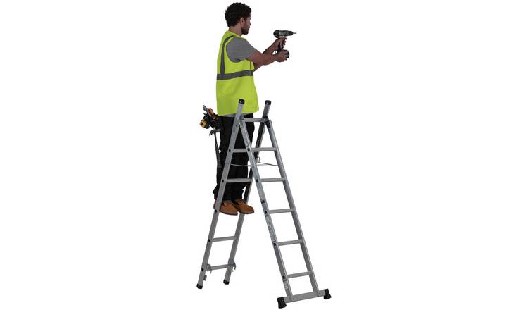

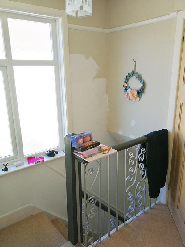

Sparrowhawk Posted June 24, 2023 Posted June 24, 2023 (edited) After making do with a hand-me-down set of wooden decorators steps, I need to get to two places I can't reach from them. Also they're getting increasingly wobbly and need to go! I want to get to and remove the fascias and gutters from first floor roof height, which are 2.9m off the ground; and in our stairwell I need to get up there and lever the dado rail from the wall and then replaster and paint. The staircase is 0.75m wide and is inclined at 45(ish) degrees I've looked at https://www.screwfix.com/p/werner-3-section-5-way-aluminium-combination-ladder-with-platform-2-48m/420kh but with the stabilisers fitted it's too wide for the stairs and I'm unclear if the platform will grip at any height - or it cannot be level on the stairs. What are good options to consider? Second question are stabilising bars the best option to make working up a ladder safer? They look like they should make it more stable when pulling/pushing stuff at the top of the ladder. Edited June 24, 2023 by Sparrowhawk
ProDave Posted June 24, 2023 Posted June 24, 2023 I would buy something like this https://www.argos.co.uk/product/2026659?clickPR=plp:1:3 Can be used as a step ladder, straight ladder, or offset step ladder on stairs. Mine are a much older variant on this design and both halves are just an ordinary ladder without that annoying bar on one section that makes it wider at the bottom. If you can find one the older design, imho it is better.

SteamyTea Posted June 25, 2023 Posted June 25, 2023 (edited) I have this one from Wickes. https://www.wickes.co.uk/Werner-Aluminium-12-in-1-Multi-Purpose-Ladder-with-Platform/p/250167 The stabilisers, like a kids bike, can be removed, and I have long ago lost the platform insert. It is heavy, but that makes it flex less, which is nice, none of that leg shaking vibration. Have had it over 20 years, think I got it in a sale for £25. As if folds up small, it fits in the boot of a small car. My stairwell is similar to yours, I stand on the banister when I paint the top corner. Put some grippy shoes on, one hand on the wall for triangulation, and make sure the paint tray is in reach of the other hand. (caveat, like @joe90, we have both done rock climbing, so are pretty confident, but cautious about it, and we don't put our fairy dancing shoes on). Edited June 25, 2023 by SteamyTea 1

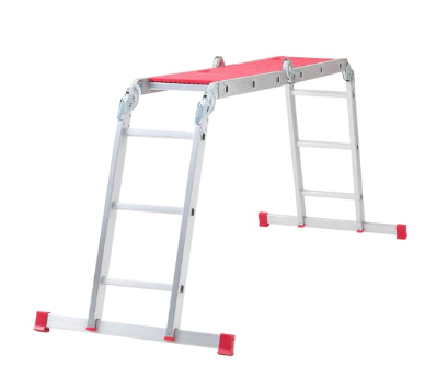

S2D2 Posted June 25, 2023 Posted June 25, 2023 I prefer a platform for above the stairs, like this but without the top steps if you don't need the extra height: Much more comfortable than being up a ladder.
Sparrowhawk Posted June 25, 2023 Author Posted June 25, 2023 18 hours ago, ProDave said: I would buy something like this https://www.argos.co.uk/product/2026659?clickPR=plp:1:3 Can be used as a step ladder, straight ladder, or offset step ladder on stairs. Thanks, looks handy. Sellers don't like stating the max standing height or even safe working height in each combination, do they?! Werner have a handy page about where you should stand and do give figures on their site which I'm using as a starting point. For the fascias I'll need to stand 1.5m off the ground to work easily. Am I right in thinking that having the ladder as an A frame is more stable than leaning the top against the wall and the bottom on the patio?
ToughButterCup Posted June 25, 2023 Posted June 25, 2023 34 minutes ago, Sparrowhawk said: .... Am I right in thinking that having the ladder as an A frame is more stable than leaning the top against the wall and the bottom on the patio? No ........... Yes, an A Frame is likely to be a more stable platform on which to work. But it isn't if , standing on the A frame, you work to the side of the ladder - in other words push across the line of the ladder. Your weight , leaning in line with the ladder, makes the set up much more stable. And thus safer. Try it. Stand on the first step of the ladder, in line with the ladder. And push against the wall. Next make the ladder into a A frame, set it alongside the wall. And push against the wall at the same height as before... 1 1
