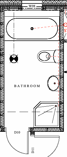

Pocster Posted June 22, 2023 Posted June 22, 2023 So bco came out today after 6 yrs ( as I was advised then to call them once finished ) I recorded the conversation. oh dear here we go … Bathroom door should open outwards not into the bathroom . It’s in the plans I was told . It isn’t Structural steels need fire proofing . It’s in the plans . It isn’t Failing that suspended tile ceilings need 30 minute fire resistance. Spoke to supplier on this and they can’t give that . Apparently 30 mins is achieved via the frame AND tiles - and in their test conditions . I assume a copy of their fire rating test will be sufficient for bco to go away Wall water membrane system . Want to see design for this . There isn’t one of course as it’s diy . Timber frame spec !! ( even though it was up 6 yrs ago ) What annoys me is apparently these things were noted on my file 6 yrs ago but bco never told me until now . Some other “ I must find things “ aswell … I suspect it’s a box ticking exercise , but annoys me . At the end I asked him if it should be demolished. My sarcasm was lost on him ….

Pocster Posted June 22, 2023 Author Posted June 22, 2023 Oops my bad!. Missed this one!! Bathroom door does open inwards when it shouldn't. The argument he gave was if someone fell on the floor in the bathroom you can't open it because their body is in the way. I've emailed back to BCO and said but if the bathroom door opened outwards and I was in the bathroom and someone collapsed outside the bathroom I can't get out. I then suggested if 2 people either side of the door collapsed neither could get out due to being unconscious and the other in the way. Perhaps bathrooms should have no doors. He's yet to reply to that. 1

MJNewton Posted June 22, 2023 Posted June 22, 2023 (edited) 2 hours ago, pocster said: Oops my bad!. Missed this one!! Bathroom door does open inwards when it shouldn't. The argument he gave was if someone fell on the floor in the bathroom you can't open it because their body is in the way. I've emailed back to BCO and said but if the bathroom door opened outwards and I was in the bathroom and someone collapsed outside the bathroom I can't get out. I then suggested if 2 people either side of the door collapsed neither could get out due to being unconscious and the other in the way. Perhaps bathrooms should have no doors. He's yet to reply to that. I don't recall ever seeing a bathroom where the door opens outwards. Not saying they don't exist, but they're certainly not common in my experience! Outward opening doors inherently present an impact risk to others walking by, the mitigation usually some level of glazing to allow you to see through it but obviously not very desirable for a bathroom! I might well just be ignorant of the regs, and all the bathrooms I've been in pre-date the introduction of such a rule! (Although our own house is 2007 and they're all inward-opening - that's longer ago than I sometimes think though). Edit: Actually, we've got a downstairs toilet with an outward-opening door and perhaps that ticks the box in terms of having a wheelchair accessible toilet and that's what it's all about rather than people collapsing (which surely also happens in rooms besides bathrooms?!). Edited June 22, 2023 by MJNewton
Pocster Posted June 22, 2023 Author Posted June 22, 2023 7 minutes ago, MJNewton said: I don't recall ever seeing a bathroom where the door opens outwards. Not saying they don't exist, but they're certainly not common in my experience! Outward opening doors inherently present an impact risk to others walking by, the mitigation usually some level of glazing to allow you to see through it but obviously not very desirable for a bathroom! I might well just be ignorant of the regs, and all the bathrooms I've been in pre-date the introduction of such a rule! (Although our own house is 2007 and they're all inward-opening - that's longer ago than I sometimes think though). Edit: Actually, we've got a downstairs toilet with an outward-opening door and perhaps that ticks the box in terms of having a wheelchair accessible toilet and that's what it's all about rather than people collapsing (which surely also happens in rooms besides bathrooms?!). I agree ; it’s not a ‘nice ‘ arrangement. I probably years ago forgot and designed the door to be more suitable/ normal . As I mention I’ll get over this issue !!
MJNewton Posted June 22, 2023 Posted June 22, 2023 22 minutes ago, pocster said: I agree ; it’s not a ‘nice ‘ arrangement. I probably years ago forgot and designed the door to be more suitable/ normal . As I mention I’ll get over this issue !! Yeah, you could perhaps re-hang it then swap it back round afterwards. Maybe make it completely obvious - but still deniable - that that's what you'll be doing by leaving your tools out, pot of filler etc to one side! 1
