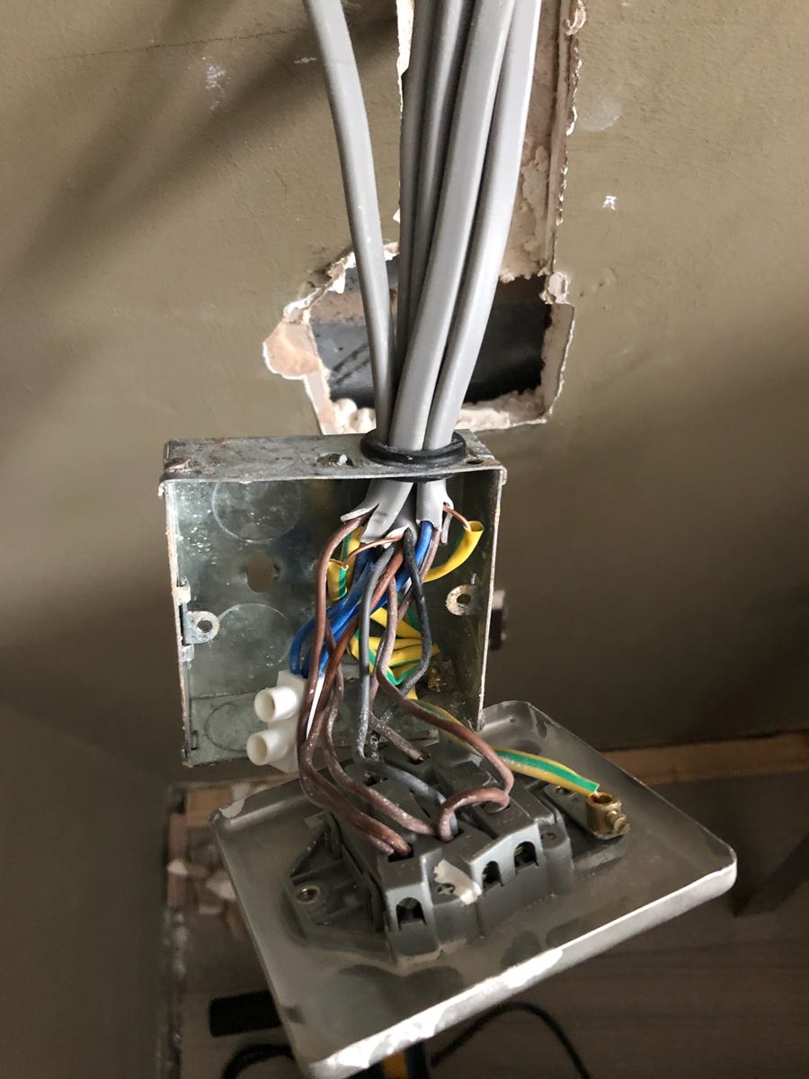

daiking Posted April 7, 2018 Author Share Posted April 7, 2018 Another grommet would have cost 2p, ffs. 1 Link to comment Share on other sites More sharing options...
Nickfromwales Posted April 7, 2018 Share Posted April 7, 2018 18 minutes ago, daiking said: Another grommet would have cost 2p, ffs. Yes, but then you'd have said he went over budget Link to comment Share on other sites More sharing options...
PeterW Posted April 7, 2018 Share Posted April 7, 2018 Loving the choc block ... could have put a Wago in there for 28p.... Link to comment Share on other sites More sharing options...
Onoff Posted April 7, 2018 Share Posted April 7, 2018 At least they didn't scrimp on the brown sleeving on the strappers... Link to comment Share on other sites More sharing options...
daiking Posted April 8, 2018 Author Share Posted April 8, 2018 (edited) Right or wrong it all went back the same way and seems to work. not quite the same way, I couldn’t get all 5 earths + a strap to the plate, in the back box earth connection. So 2 go straight to the plate with the strap. i have another switch to raise but that doesn’t have the 2 way stitch on it thank god. Edited April 8, 2018 by daiking Link to comment Share on other sites More sharing options...
ProDave Posted April 8, 2018 Share Posted April 8, 2018 2 hours ago, daiking said: i have another switch to raise but that doesn’t have the 2 way stitch on it thank god. Why are you raising them? Beware of building regs minimum and maximum heights, you don't want to fail on something so simple. Link to comment Share on other sites More sharing options...
daiking Posted April 8, 2018 Author Share Posted April 8, 2018 1 hour ago, ProDave said: Why are you raising them? Beware of building regs minimum and maximum heights, you don't want to fail on something so simple. Building regs won't be an issue . Its actually a bedside light switch that was at a low height and then my wife picked bedroom furniture that was too tall for the switch placement :face palm: Link to comment Share on other sites More sharing options...
ProDave Posted April 8, 2018 Share Posted April 8, 2018 15 minutes ago, daiking said: Building regs won't be an issue . Its actually a bedside light switch that was at a low height and then my wife picked bedroom furniture that was too tall for the switch placement :face palm: How did you secure the back box? It would have had a dwang originally to screw to. It's unlikely to have a dwang at the new height. I would have replaced it with a plasterboard box, and given the amount of cables, a 47mm deep box. Link to comment Share on other sites More sharing options...
Onoff Posted April 8, 2018 Share Posted April 8, 2018 The old box was screwed to the blocks behind with a c'sunk screw judging by the indent... Same again I guess he did when he moved it up? A 47mm would have meant some digging out of the blockwork. Link to comment Share on other sites More sharing options...
daiking Posted April 8, 2018 Author Share Posted April 8, 2018 7 minutes ago, ProDave said: How did you secure the back box? It would have had a dwang originally to screw to. It's unlikely to have a dwang at the new height. I would have replaced it with a plasterboard box, and given the amount of cables, a 47mm deep box. No dwang it’s lightweight block so plugs and screws. Stuck the same box back as there was only 30mm depth. Might attempt it again when I’ve more time. Link to comment Share on other sites More sharing options...
