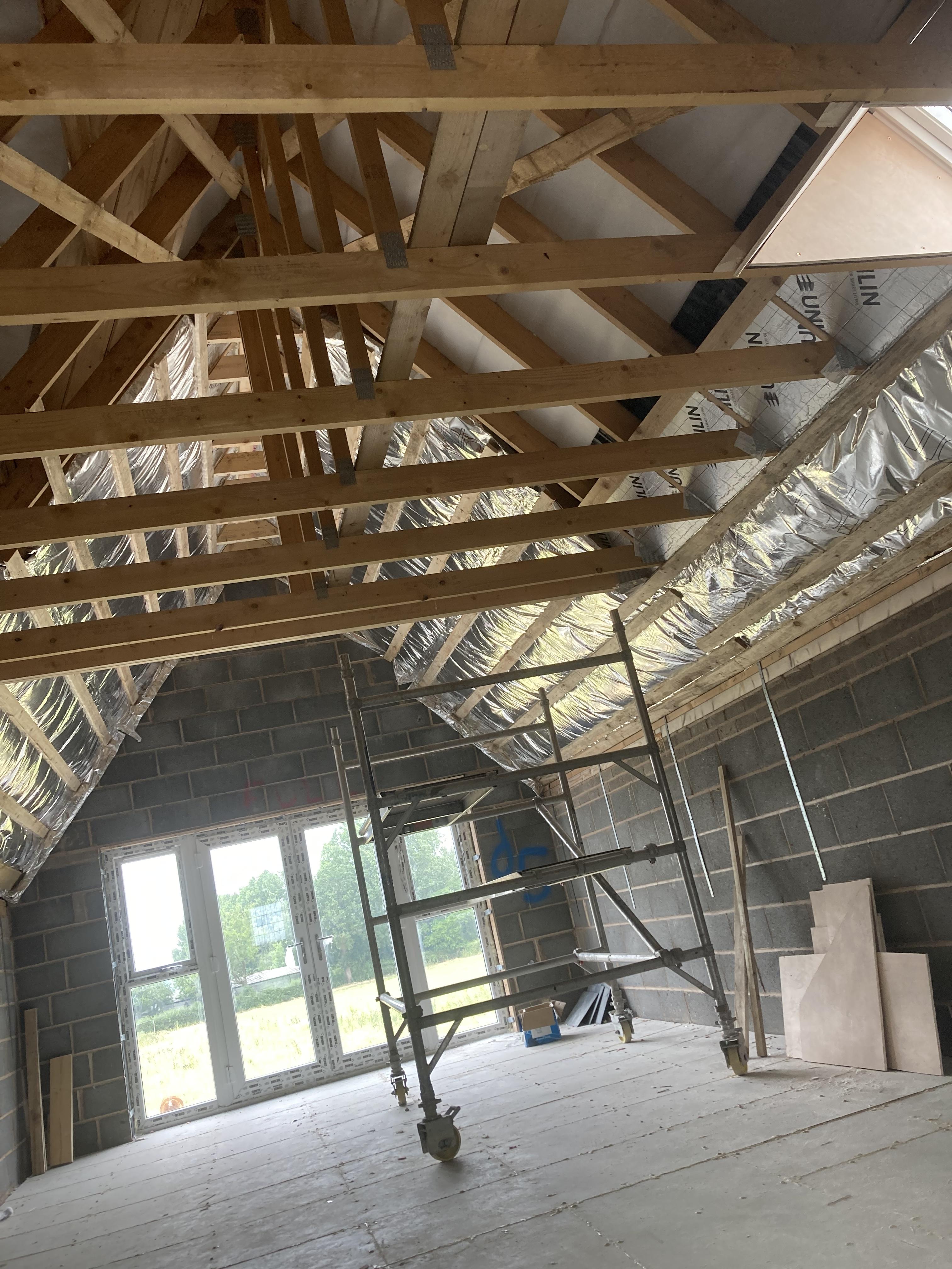

nod Posted June 18, 2023 Share Posted June 18, 2023 We made a start today insulating the three vaulted ceiling’s and numerous slopes Up nice and early 6am 100 mil of pir A layer of super foil 3x1s Then 82 mil of insulated plasterboard Link to comment Share on other sites More sharing options...
jayc89 Posted June 18, 2023 Share Posted June 18, 2023 That's a hell of a build up? What's the final u-value? Is the superfoil fitted directly against the PIR? I thought it needed a gap either side to work properly. Link to comment Share on other sites More sharing options...
nod Posted June 18, 2023 Author Share Posted June 18, 2023 I’m not sure what the u value is It fine directly onto the rafters It acts the same way as fixing 60 mil of pir on to the rafters There’s 50 mil air gap behind the pir and 25 between the insulated plasterboard Link to comment Share on other sites More sharing options...

ProDave Posted June 18, 2023 Share Posted June 18, 2023 5 minutes ago, scottishjohn said: my architect wanted me to have vaulted cielings Iasked her if she was going to ocme round and clean and de spider web them never mind all that extra volume of air to heat and the 50% extra insulation it would need + arsholing around fitting between exposed beams etc not my bag The contrary view is vaulted ceilings is one of the best decisions we made. A cut roof hung from a ridge beam and all insulation following the line of the rafters was so simple to detail and get well insulated and air tight compared to conventional trusses and a cold loft. I would do the same again without question. Link to comment Share on other sites More sharing options...
