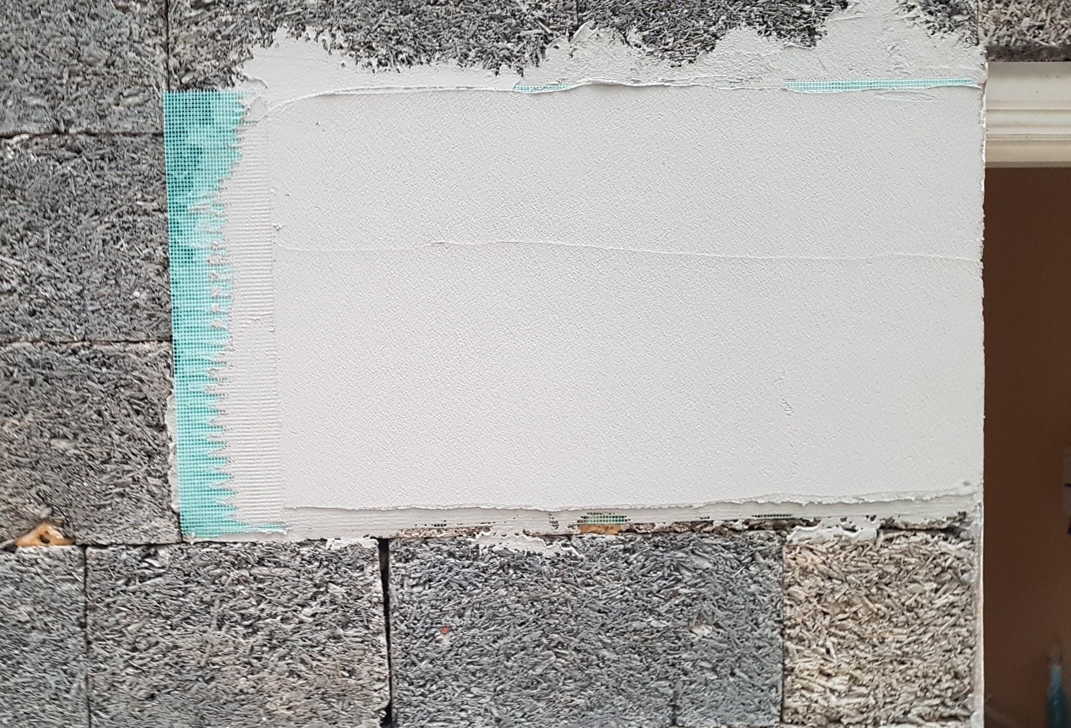

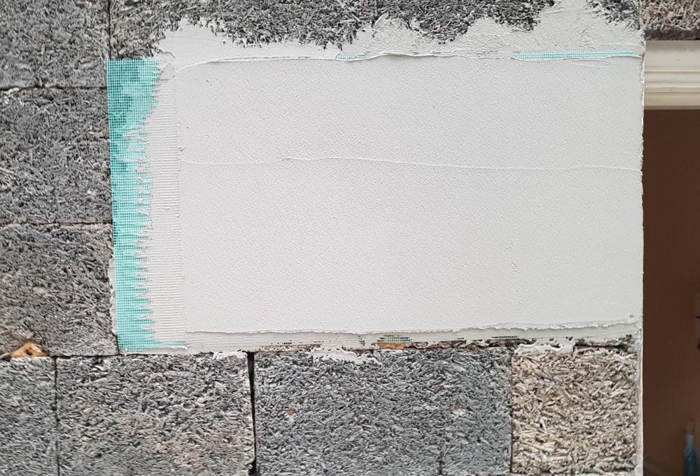

ToughButterCup Posted June 17, 2023 Posted June 17, 2023 1 hour ago, nod said: ... NO you don’t seal But you will need to mesh ..... Just in case some readers aren't sure what 'meshing' is, here's a photo in this case applied to an ICF. The mistake I made initially was to try and apply the mesh when the first coat of render was already too dry, and the other was trying to apply it to a too first thin coat. Oh - and the weather was way too hot, and I didn't pre-wet the wall enough. Anyway ..... 1
