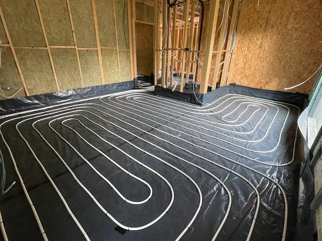

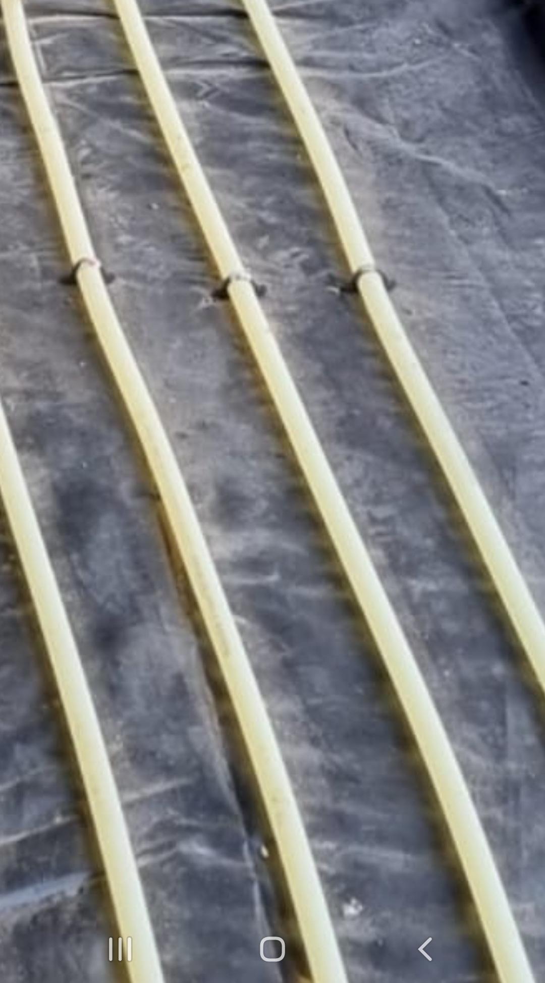

bmj1 Posted June 14, 2023 Posted June 14, 2023 Hi wise people, Was planning to do underfloor heating with liquid screed over kooltherm phenolic insulation. Kingspan advise that this insulation should not get wet, so plastic sheet above. So how do we do the clips for underfloor heating without piercing the insulation ?
Thorfun Posted June 14, 2023 Posted June 14, 2023 8 minutes ago, bmj1 said: Hi wise people, Was planning to do underfloor heating with liquid screed over kooltherm phenolic insulation. Kingspan advise that this insulation should not get wet, so plastic sheet above. So how do we do the clips for underfloor heating without piercing the insulation ? you can't! but don't worry the liquid screed won't get through the staple holes. here's a photos of ours just staple through the dpm and in to the insulation. so simple I did all ours myself with my wife on the stapler most of the time. 1 1
saveasteading Posted June 14, 2023 Posted June 14, 2023 (edited) You just pierce the membrane and insulation and don't worry about it. Pir doesn't really get wet. The membrane is to stop the wet screed flowing between joints and floating the pir. Edited June 14, 2023 by saveasteading 1
