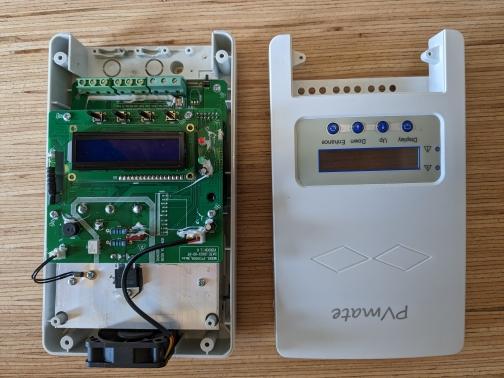

dpmiller Posted June 30, 2023 Share Posted June 30, 2023 I've been doing a bit of searching. and gleaned that the diverter in this thread is indeed the same as the CoolEnergy one, and if anyone wants to deal direct with the chinaman you can have one from the manufacturer direct. I'll not post a link but you'll find it on Aliexpress from "Runhu" and it'll cost you about £140 including shipping and vat. photo of internals The fan is a bit bigger than the iBoost's by the looks of it, and the general build is so similar that I'd opine they could be the OEM for it too, lol 1 1 Link to comment Share on other sites More sharing options...
dpmiller Posted February 29, 2024 Share Posted February 29, 2024 ^ update on this. I was having issues with my iBoost running too hot and had to fashion an external fan to assist. heatsink all clean etc. So guessing a partial fail of the triac/whatever power device Ordered one of these Runhu units direct and have just installed it. Now, some reviews hint that it doesn't start diverting till a few hundred watts so I'll be monitoring more closely for the next wee while. But first impressions are that it's a bit different to the iBoost in that it doesn't run the fan during *all* divert, seemingly being temperature controlled. And it's a LOT quieter. Happy days, for now... Link to comment Share on other sites More sharing options...
