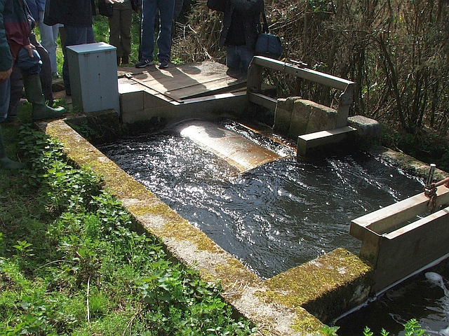

Jeremy Harris Posted August 15, 2017 Posted August 15, 2017 8 minutes ago, Lesgrandepotato said: ProDave, my concern with that is making it fool proof, the Millstream is running through a wood and I forsee issues with leaves / twigs / trees jamming any mechanical elements - hence the desire to let the water run (we have a massive underground culvert to channel through) and then simply disengage the electrical side? That's the easy bit, you just create a self-cleaning overflow filter weir, that allows excess water to flow over the top of a grill and sweep the debris away. There will be lots of designs around on the web, but if you get stuck I can sketch up the system used at the caving club I used to belong to, that gets it's water supply from just such a system, that's then connected to a few hundred metres of large bore MDPE that runs down the mountain to the club house. In essence it's just like a hydro system, and there's no problem at all in just turning the water off at the end of the pipe when water isn't needed. Paul Camelli, up at the end of Raasay, has a similar setup running his hydro power system, and has documented what he's built pretty well on his blog - well worth a read: https://lifeattheendoftheroad.wordpress.com/ (you'll need to search back a few years for his hydro stuff)

SteamyTea Posted August 15, 2017 Posted August 15, 2017 Here is a picture of a filter on a small hydro system near me. When I say small, it is 200 kWp I seem to remember.
