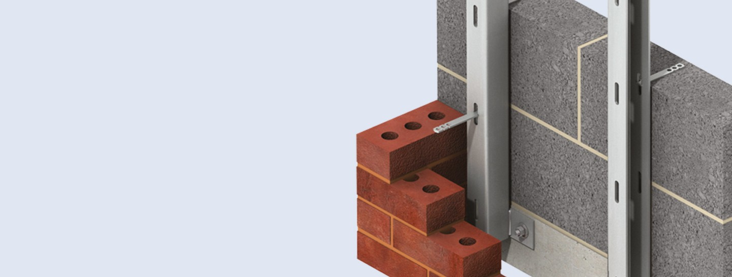

saveasteading Posted June 10, 2023 Posted June 10, 2023 Overspecification of these wind posts is my grouch Making a weakness in a wall and then reinforcing it doesn't make much sense. I had my own made once at 1/3 the cost.

saveasteading Posted June 10, 2023 Posted June 10, 2023 1 hour ago, Oz07 said: movement joint would look neater than a crack. Agreed. I just never had a crack in umpteen walls with no gaps. I suppose I'm saying that the rules may be slightly conservative, probably inspired by the windpost and filler manufacturers who commissioned the tests. Perhaps also they assume hot from the oven bricks and still dripping blocks...Both of which I have encountered
Oz07 Posted June 10, 2023 Posted June 10, 2023 Why does a movement joint need wind posts? Isn't there a standard detail with cavity ties either side or over a certain height do you need wind posts?
saveasteading Posted June 10, 2023 Posted June 10, 2023 6 minutes ago, Oz07 said: cavity ties either side There are several solutions: sliding ties across the gap or into a post.
Oz07 Posted June 10, 2023 Posted June 10, 2023 Yeh the ties with the condoms that's what i've used with cavitiy ties every joint on the blockwork 1
