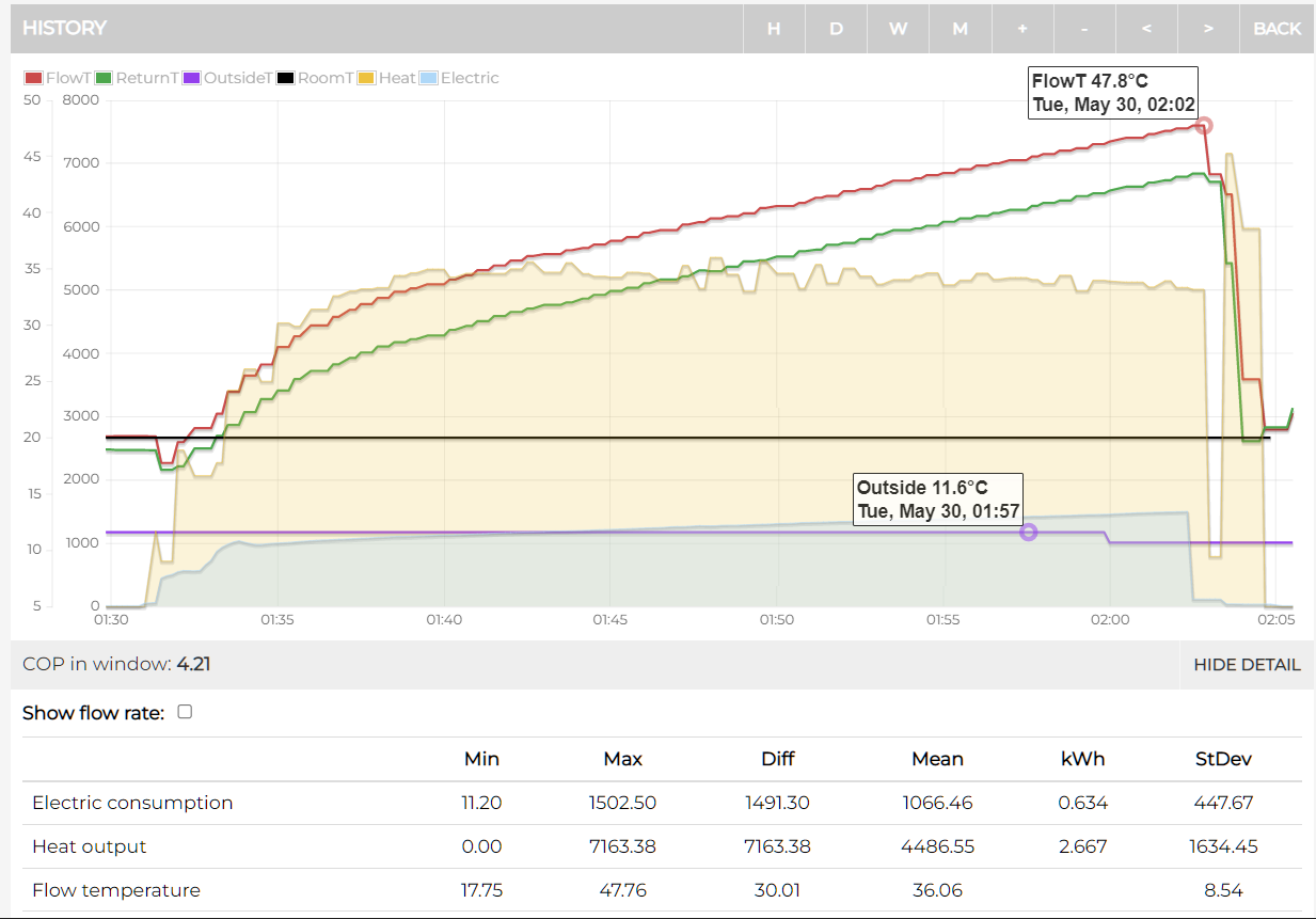

Blooda Posted June 5, 2023 Posted June 5, 2023 (edited) First of many ASHP questions. So currently we have DHW set to heat to 42 degrees between 3 and 5 in the morning, this gives us enough hot water for the day. From the smart meter app we generally use between 1.5 and 2.0 kWh and it gets to temperature in around half an hour. The initial thinking was that at this time of day it would not interfere with the heating, but now I have turned the heating off for summer, I was thinking it may be slightly more efficient to run it when the air temperature is higher in the day time ? Thoughts please. Edited June 5, 2023 by Blooda 1

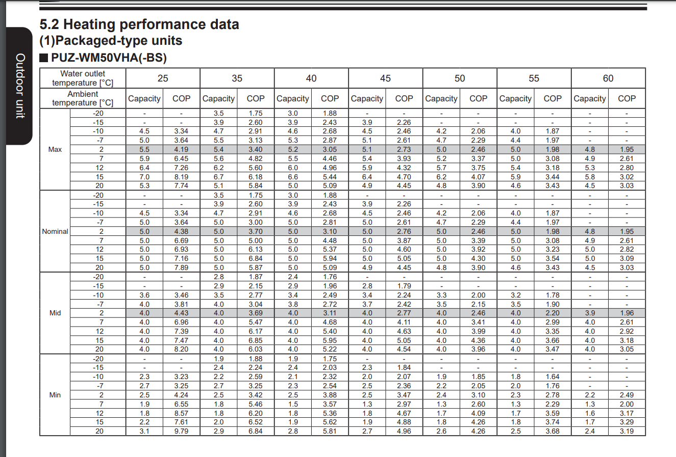

joth Posted June 5, 2023 Posted June 5, 2023 55 minutes ago, SteamyTea said: 283 [K] ÷ 293 [K] ×100 = 96.59% 10 [⁰C] ÷ 20 [⁰C] ×100 = 50% This gives the size of the numerator, with respect to the denominator, expressed as a percentage. The mean free path speed of the molecules, in an identical material, will be the same in both instances. This is of course just the ratio between the two absolute temperatures. It does not equate to the % difference in efficiency at those respective outdoor temperatures. That will depend on other factors too. Best just to look it up in the heatpump datasheet.
SteamyTea Posted June 5, 2023 Posted June 5, 2023 12 minutes ago, joth said: Best just to look it up in the heatpump datasheet. Yes. Then find there is not a lot in it. In reality, if you know the temperature of the refrigerant on the cold and hot sides, you can calculate the efficiency. But as both if those will be varying with OAT and delivery temperature, it does not help much. Using the kelvin scale is the better way to work out the potential energy available in the outside air, but then humidity levels can screw it up no end because around 273 K, water will stop condensing and start to change phase, and that release a different amount of energy. Also that water is at its most dense at 277 K. Confusing it more. It would be useful if there was easily accessible data, through a range of OAT and RHs, while delivering a range of temperatures and power. Kind of think that once written a spreadsheet is great for.

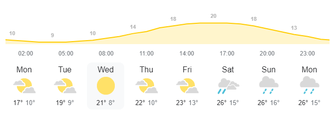

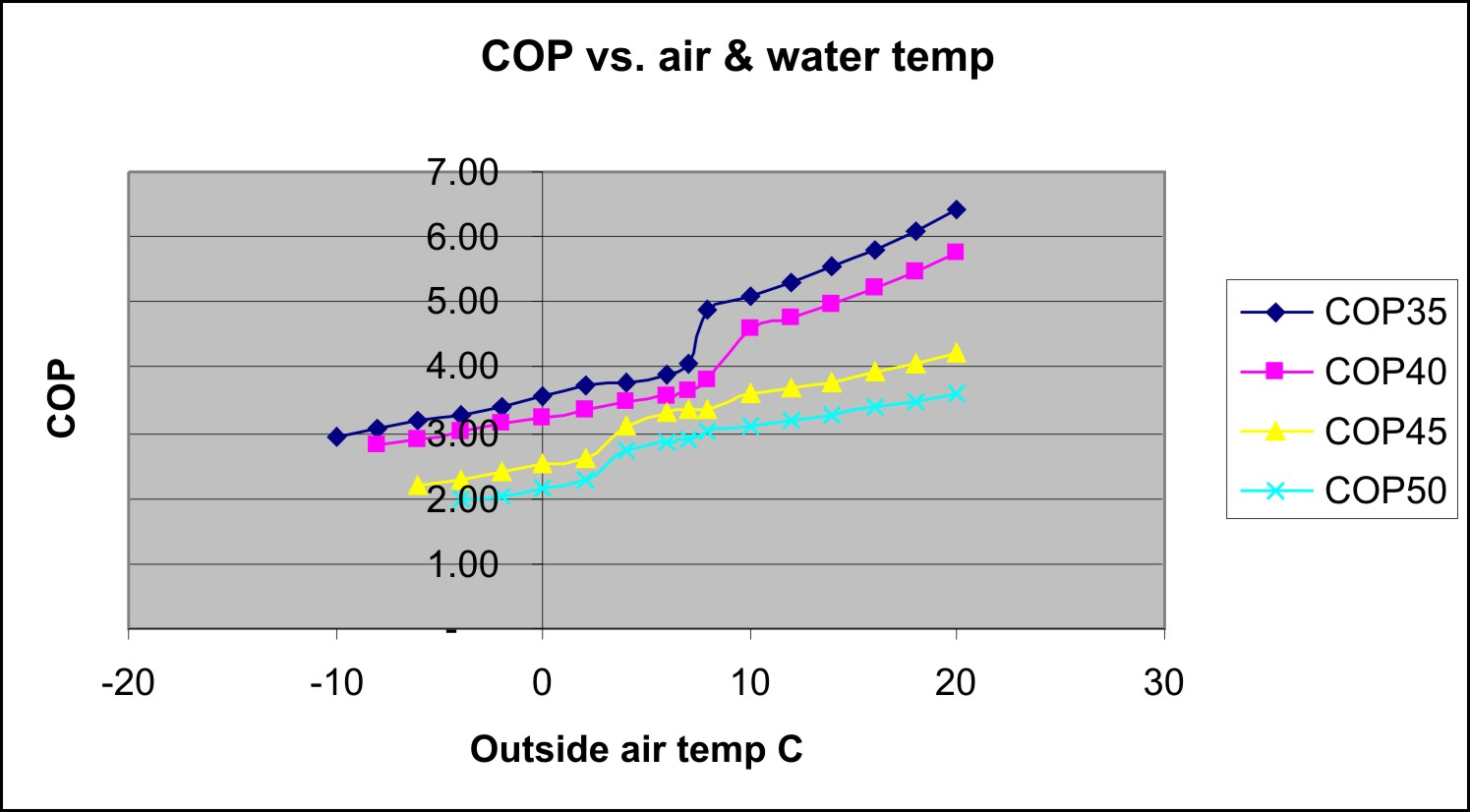

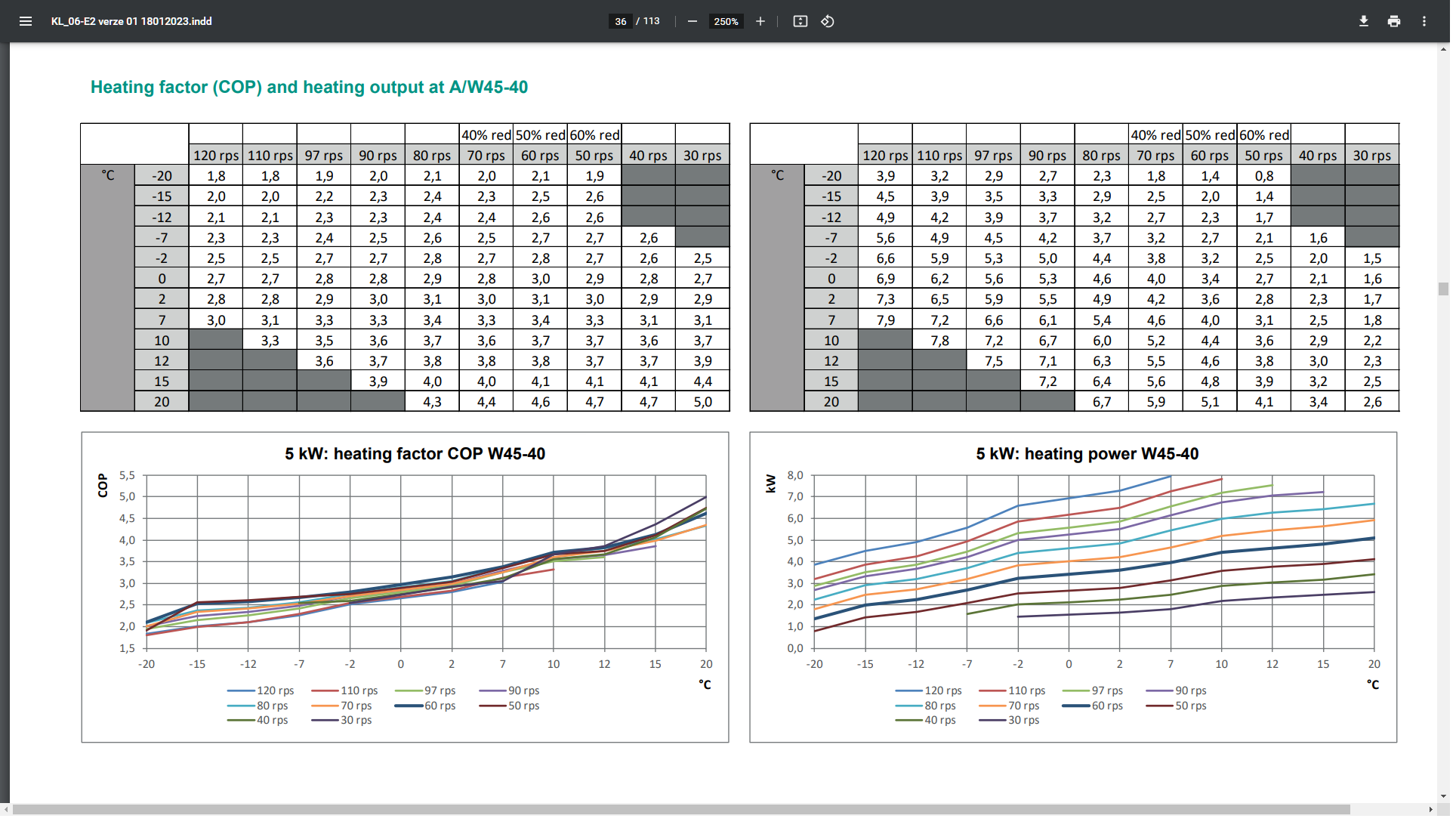

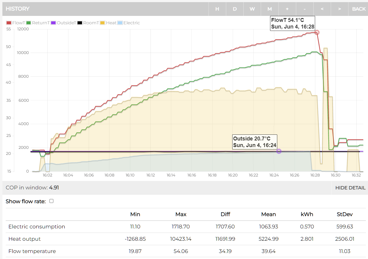

AliG Posted June 5, 2023 Posted June 5, 2023 If you take this as a typical COP chart then you will get a better COP running the ASHP when it is warmer. We have had days recently when it was 5C during the night and 15C during the day so, heating DHW to 50C, you would get a COP of 2.8 at night and 3.2 during the day. The big difference would come if the night time temp was between 0 and 5 and the daytime temp was 10Cish as you might get in the spring or early winter. Then the COP might be 2.2 vs 3. So it could be 15-30% cheaper to heat DHW during the day. But the real issue is what do you pay for electricity. If you have free PV or cheap overnight electricity then that will make a way bigger difference than the small change in COP at different times of the day. As an aside when I monitor our energy usage we use quite a bit more during winter because the water coming into the house to be heated is sitting closer to 0C whereas in the summer it is close to 10C. So you need roughly 1/3 more energy to heat it, increasing the temperature by 40C in winter and 30C in summer.

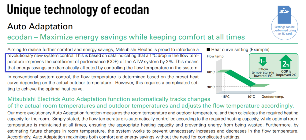

Marvin Posted June 6, 2023 Posted June 6, 2023 (edited) Hi @Blooda A question that raises questions! My thoughts are: Ignoring all other variables the smaller the difference between the outside air temperature and the water temperature exiting the ASHP the more efficently the ASHP runs. However, if your real aim was to spend less when producing a suitable amout of hot water, then things become more fun! Adding variables such as the heat loss of the tank over the peroid of time between the tank water being heated and used may make the result different. As you seem to be able to measure every kWh used, you can try your ideas out and see what is best fror you. By testing this way, for us, with our ASHP and hot water setup and water use, we found the afternoon was a better time to heat our water. During the winter, using hourly air temp readings, we noted that the coldest part of a 24 day could be anytime and that extreme temperatures were greater with sunny days with cloudless nights. We now use a PV excess electricity diverter with ASHP as back up. I wait with bated breath for your questions on heating using an ASHP! Good luck Marvin Edited June 6, 2023 by Marvin Clarification, hopefully.

Blooda Posted June 6, 2023 Author Posted June 6, 2023 Thanks for all the information. phew! We don't have Solar and we are on a standard tariff so no difference in price. Will set it to come on at 1:00pm. We have limitations - the ASHP records at a resolution of 0.5kWh per hour, so COP calculations are all over the place, using less than 2 per day on DHW. But the smart meter measures at 1/2 hour intervals to 0.01kWh. so should be able to see some change there.

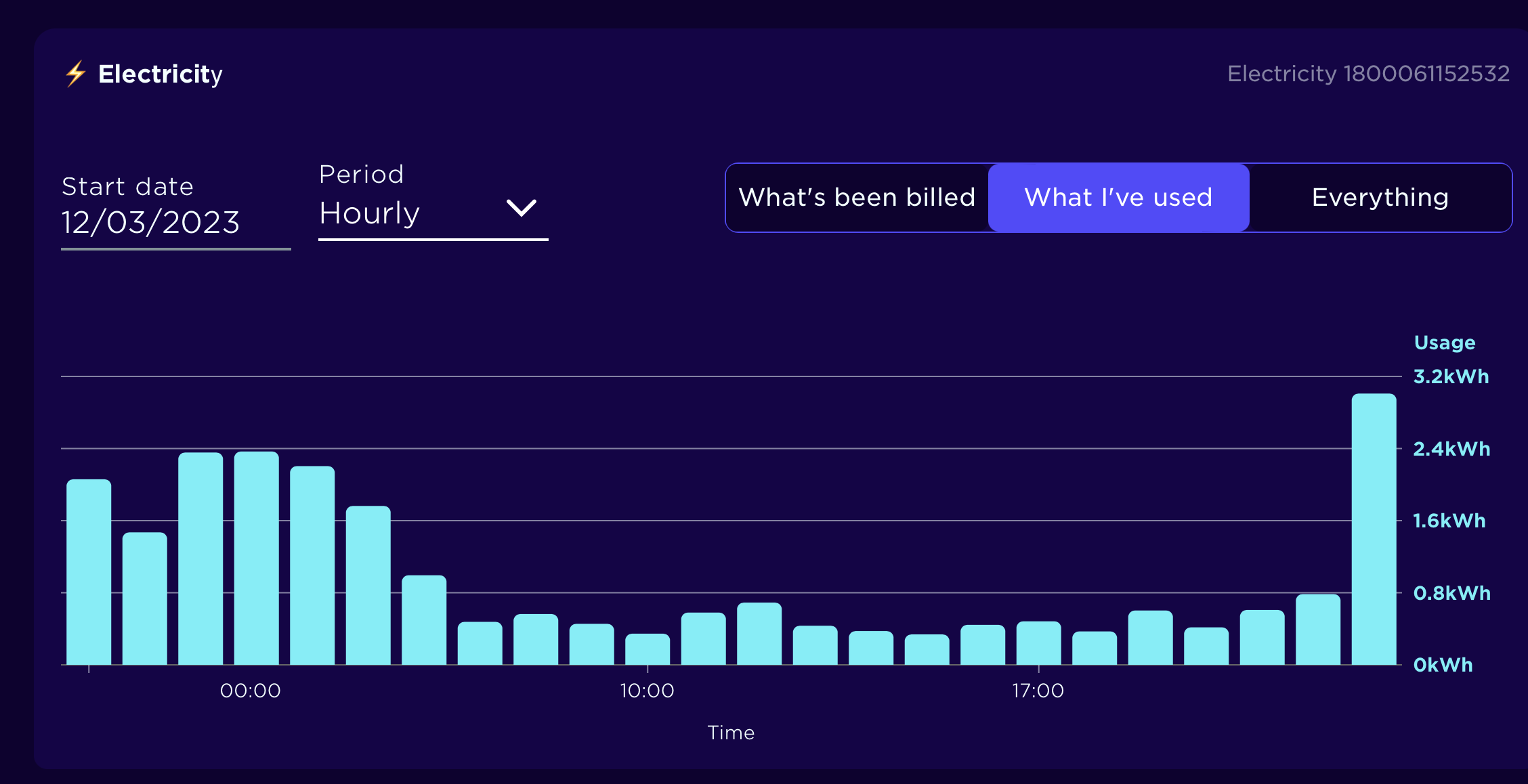

AliG Posted June 10, 2023 Posted June 10, 2023 Solar would reduce consumption, the problem is that overnight electricity is so cheap that the ROI on solar becomes poor depending on your usage. Their consumption looks like the chart below since they moved to IO in March. They use around 0.5kWh per hour outside IO hours. They have room for a 2.7kW array which judging by my solar production would generate around 1500kWh a year. Slightly less than optimal as they have a flat roof. Considering weather, spikes in usage, the fact that power is concentrated between 9 and 4pm looking at my system and so on, they wouldn't be able to self consume much more than 50% of the production, maybe even less. I get a reasonably good idea from the data on my system. So say they utilise 750kWh of PV that is £225 a year at the July price cap. I have consistently argued that people should not make PV investment decisions based on recent inflated electricity prices. Wholesale prices continue to fall and if and when the Ukraine war ends they will likely fall considerably. Using say 20p per kWh, still well above pre war levels you get £150 a year of self consumption, maybe £200-250 including SEG payments. As they were quoted £5k for the array, it wasn't really worth the bother (Installers massively bumped up prices when electricity prices went up).
